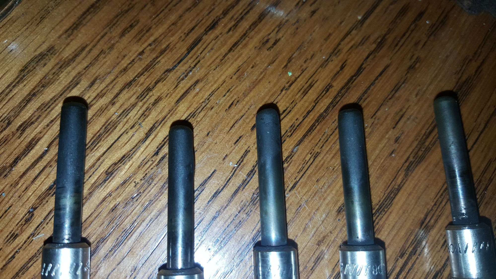

My truck came with Autolite plugs installed by PO just before I bought it. Hard start even at 90* so I replaced them with Motorcraft/Beru. No more issues.

so I'm gunna guess the autolites I put in are not heating enough after 2 weeks... I have a button to controlled them and do about 7 seconds and it would start but now I can do 10 wait 5 then 5 more and it won't go. That's in the morning tho after all night. They test good with a test light tho

its more so the fact that autolites literally suck... about week ago we had a sparkplug replacement at my work (i work @ jiffy lube a company ran by cheap a$$es thatbuy cheap parts and expect a big profit, long story short the car ran worse with the new pregapped autolites than it did with old SP's that had upwards of 150k, everytime i see some one n here use autolites they burn out on the first use, the first day they were installed, the 2nd week after being installed, dont forget they have a tendency to swell up, rarely ever do they actually last, so not trying to bash you or anything but just trying to save you from pulling your heads!
Yeah...
With a manual system, if you need to cheap, I've had good luck with the Wellman ones.
Otherwise, the Beru ones are the best.
If you intend to keep a manual system, get the 6.9 style glow plugs. They take a couple seconds longer to heat up(especially with the load resistor on the 7.3 controller, and give you more 'leeway' with regards to overheating.

The way I hooked my manual system up is a wire off the ribbon of the relay controller to the button and from the button to power of battery and I put a fusible link in as well. someone on a different forum told me that's a terrible way and that I could literally burn my truck down. I understand there are other way to do it but I did it Cuz there is a wiring problem I couldn't find so this was my way out. so my question is 1: is my set up ok? 2: I'm putting Motorcraft plugs in today so after I'm done how long should I glow it on a cold start? I'm talking 30 degrees and colder
These are the 2 week old autolites i pylled out tonight. Hard to see but they all actually have swelling in spots. The reason theres only 5 is because i obly replaced this many to start with. Now i have 8 brand new motorcraft/beru plugs. Still have the button set up. I need to fix that soemhow. No idea how it is at starting now. Truck is still warm from before so starts up anyway without glowing.

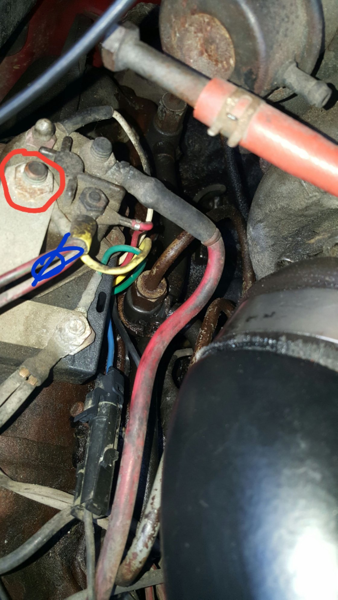

[QUOTE=mattnj;16710884]I think 10 sec would be absolutely safe at 30*. Last time I started mine at around 40* outside wts light was on
Ok so the wires with the blue on them i took that off the post and capped it so it wont touch anything. The post circled in red i put my new wire which is pretty thick. Idk what gauge off top of my head I put that to the button and from the button to battery positive. And i also spliced in a fusible link in my new wire going to battery. And i unplugged my wait to stary cuz it never shut off. My original problem before i touched the truck at all was that the relay would click nonstop with no wts light. I tested the solenoid it was junk. I tested the gp's and only 3 were good. I replaced all but the 3 plugs with the autolites and replaced the solenoid. it did the same exact thing after all the work. so I tried to figure out the problem and I couldnt. so that's when I did the button. and then 2 weeks later which was this past Saturday the truck wouldn't start cold and the gp's tested good with test light but I'm assuming they weren't getting hot enough work tonight I replaced all I with motorcraft/beru.

Well... doing that, you are running the entire current of the glow plugs through your wire, not just the small amount needed to activate the relay.
This... isn't the best way of doing it - I'll bet you fried your fusible link due to all the current.
Remember, the glow plugs draw a /lot/ of current, all of which is going through your pushbutton.
That pushbutton is in no way rated for that current, and you'll probably melt the contacts and/or housing in short order. May also melt some of the wire insulation at an end if the connection isn't good enough(too much resistance).
Get a relay in there. If that one doesn't work, just get any relay about the same size with the same size terminals; it should work fine.
One like the starter solenoid/relay on the fender well will work just fine.
