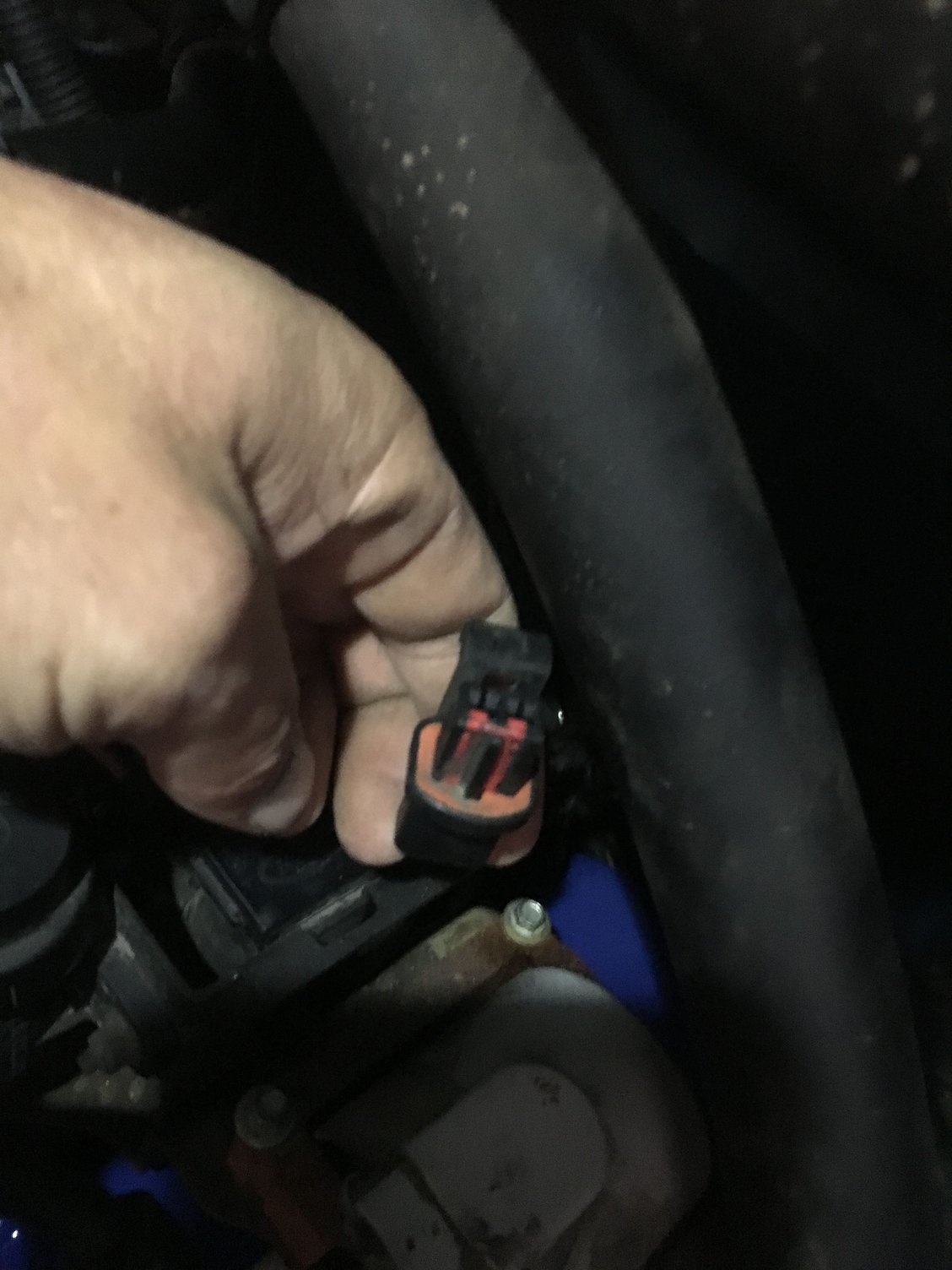

I've been using the battery as a ground . Should I try going off something else ? My distributor gear was steel , I have a roller cam in the engine but parts guys computers only show iron gears for my year . The harness on the distributor has 6 wires and the truck harness has 5 , not sure if that matters . Also I have a connector at the back of the main harness by the fuel pressure regulator that isn't connected to anything ? I can't see anywhere it would connect, the 2 wires on it are red and yellow with a red stripe and I can't find those on the wiring schematic in my manual . I'll check the grounds out and clean them up . Any other advice? Thanks
A picture would help. Be sure to inspect and clean ground G101 located next to the battery. That is a very critical ground for the computer.

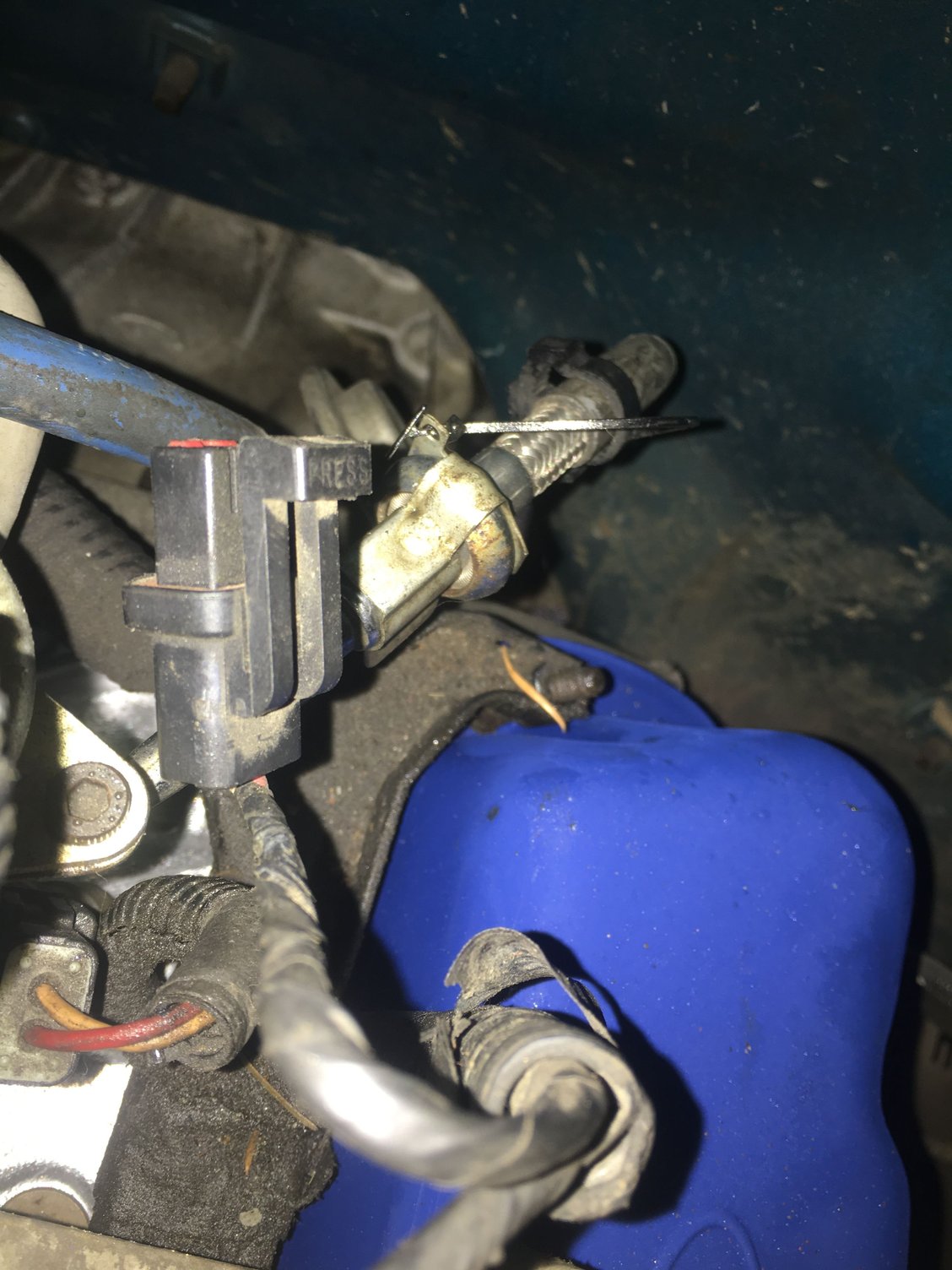

Here's a picture of the plug that I don't know what it goes to
I pulled it out to get a better shot

I have no idea what that connector is supposed to go to. I've look through everything I have and nothing matches those wire colors. Best guess is the wiring harness is common between the 5L and 5.8L equipped trucks so it may be for the knock sensor used on the 5L engines. The 5.8L never used one.

Hey thanks , I was kind of figuring that but wanted to be sure . So I tested the tps last night and the readings were good . I think I may have been doing it wrong before . I've checked the grounds and they appear to be working good . I've been researching , the only thing I really changed was the distributor with a reman one and I've been finding out that a lot of these can come with a bad pip so it's got me wondering if maybe that's causing the problems? I als am wondering if it could be a vacuum leak which I'm hoping isn't the case . Anyone have any good suggestions for checking for that ?
