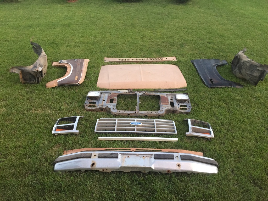

Yep! Doing a front clip swap with an 87-91 cowl, and will graft in part of the 92-96 fenders, and do a marker light delete.
