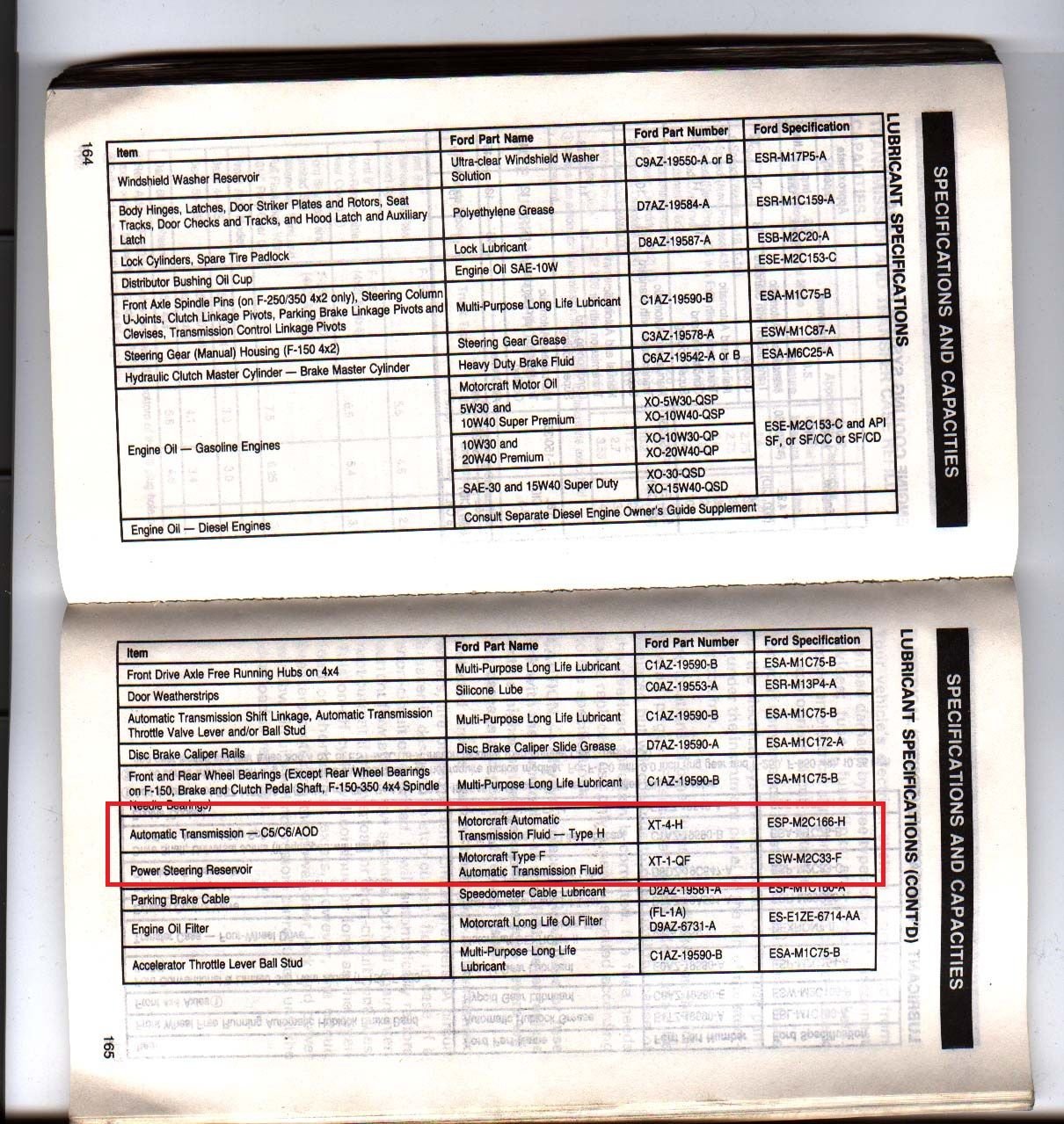

Not just ATF but Type F ATF prior to 96-98

I also used ATF in the AT and I am not sure if it is type F or not. Do I need to drain this?
Which transmission ?
I believe Type H was replaced by Mercon or Mercon V.....

Thank you. My ATF said it was for 80's ford transmissions so it should work. I drained the ps and filled it with type f ATF and it is no longer leaking, but I have not driven it yet so time will tell.

And btw: TYPE F ATF (it's red) is the same as P/S fluid. 1976: Ford came out for the first time with quart cans of "P/S Fluid" (D6AZ-19582-A).
We opened one, the fluid was red = TYPE F ATF that FoMoCo had been using since 1950!
btw part two: C4/C6 used TYPE F thru 1976, in 1977 began using MERCON aka Dexron II. AOD, C5 also used MERCON
Hydra-Matic (1950/55 Lincoln), Turbo-Drive (1956/57 Lincoln), Ford-O-Matic, FX - FMX - MX Cruise-O-Matic's used TYPE F from day one.
