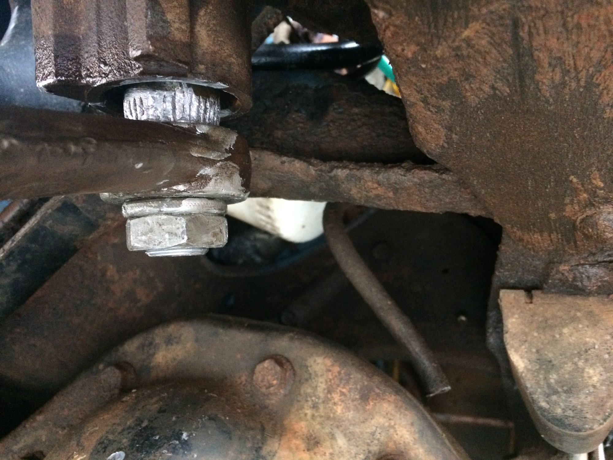

I put the Pitman arm back on and tightened tie the lock washer flattened which made the bolt go past the bottom of the study by about 1/2-1/4" so far. How much tighter do I get it? I do not have a socket that large so I am using a 24" crescent wrench and I cannot do an exact ftlb unless absolutely necessary and then I can order/get the socket.

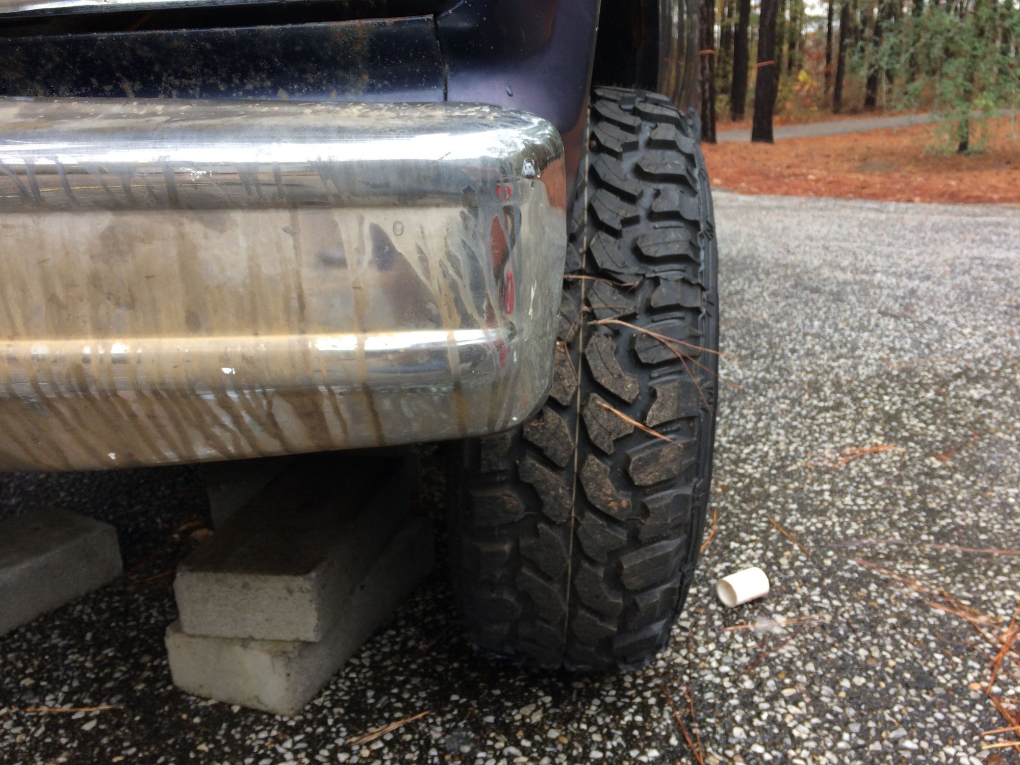

I saw 170-230 ftlb so I tightened till it was good and snug (still not at 170 though). This is what it looks like after tightening. Also the tires still seem flared. Will that correct?

It seems to have more of a positive caster than before. I put a square across the tire and measured the angle and it was between 8 and 10 degrees.

Since the tie rods are attached to the middle of the tire I do not know how it could change the caster even if the pitman arm was put on in a different place. The pitman arm slid on the first inch or so without any force and if it goes on only one way then this could not have changed. To push it up further I used the bolt, but it was not hard to turn. I do not know how this could have changed anything. I now have the pitman arm tightened very tight. If I drive it around will they straighten out maybe? If this happens the pitman arm may need to be retightened.
