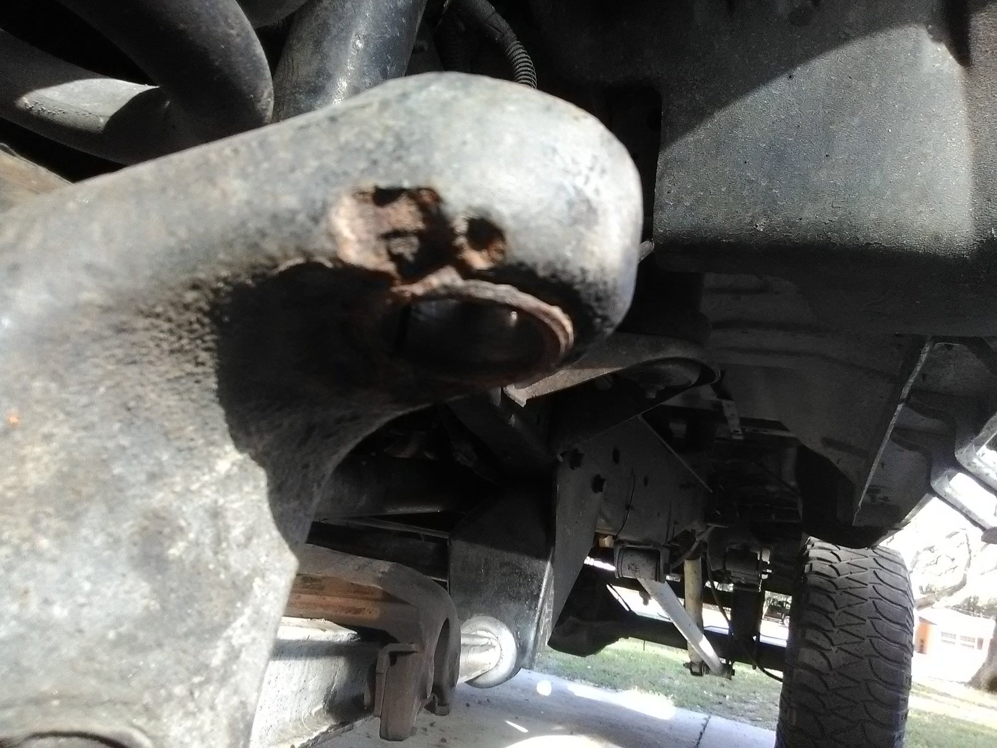

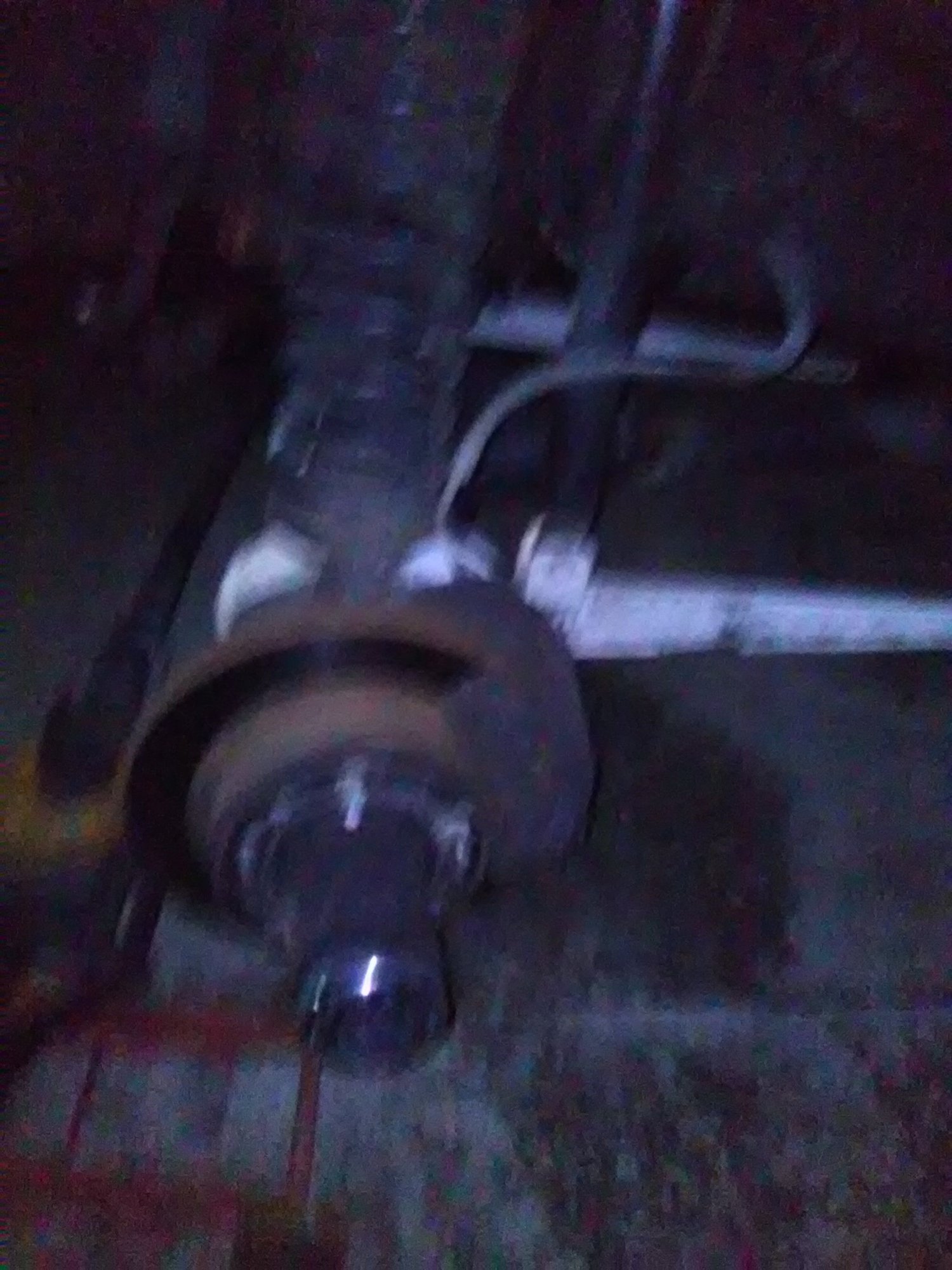

whats this
witch danns 44 and where do I get aster knuck was tolod 78-79

its under my 1996f150 straight axle swap but need new draglink and steering knuckle cant find em

Dang man... dem ar crappy pics. Er ya onder watter?... pluss yer eglish iz oll mest up.
Dana 44.. prolly 76-79 haff-tun. nukles be HTF. Duz yu hav T sterin or Y sterin?

If you have a 78/79 straight axle swapped under your 96, then you need 78/79 parts for the axle itself.
As far as the drag link, I bet the 96 connection end (truck frame part) is going to need a metric bolt and the axle end is standard.
Looks like you are trying to get the tie rod end nut off (since you have a floor jack under it)? And I bet the stud is turning and not letting you get the nut off?
Since you are probably needing to replace it, just 4" cutting wheel it off, stud nut and all.,or Sawzall, or worse case torch it.
Why to do you think you need new steering knuckles?

Yikes! Try cleaning the dirt off of the potato before taking a picture with it! I know, not helpful, sorry...

yea the inner c looks ruff

someone welded the ball joint in
otherwise id just replace the inserts that inner c scares me
