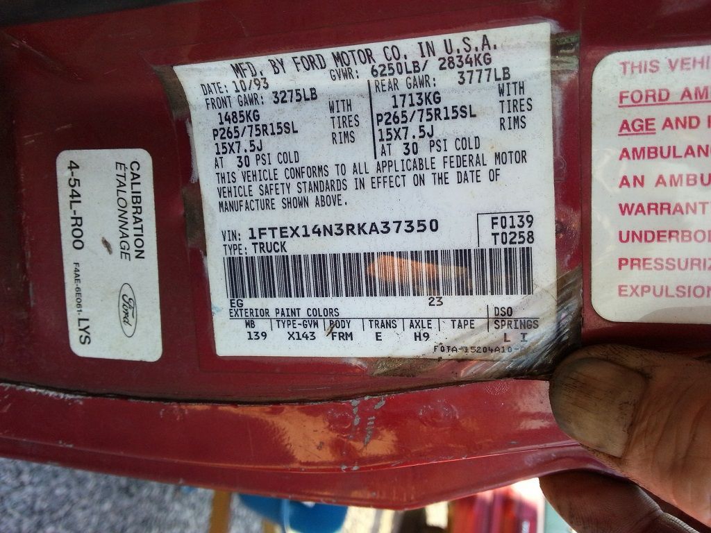

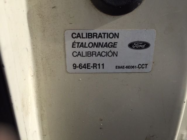

Best way to ensure you are getting the correct emission related components is to use the vehicles calibration code. You can find this in the drivers side door jamb. The CAL code provides the specific emission system for that vehicle. When getting dealer parts, this CAL code ensures you get the right emission parts. In my experience, the fidelity of the emission parts gets lost in aftermarket parts as one might expect.
Here are a few examples of the Ford vehicle calibration codes I found on the web.
