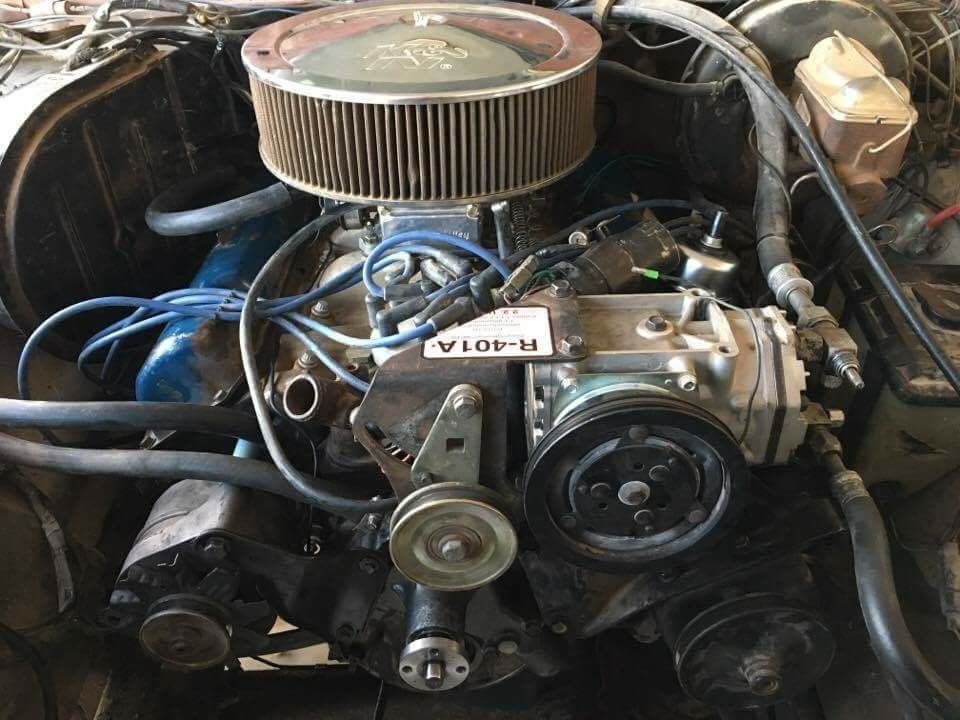

Well, I didn't finish today, but I got a lot done:
  • Hooked-up the headers
  • Installed the starter
  • Tightened-up the motor mounts
  • Hooked-up the oil pressure line
  • Hooked-up the vacuum lines
  • Discovered that my harmonic balancer was no longer in harmony
  • Ran down a replacement for the harmonic balancer. Should be here Tuesday
  • Had lunch
  • Hooked-up temperature sender
  • Installed distributor cap, plugs and wires
  • Cleaned and installed the carburetor
  • Installed my fancy new chrome oil cap
  • Cleaned up the pcv valve
  • Installed a new snout on the air cleaner base plate. Installed pcv hoses
  • Hooked-up electricals
  • Posed for picture, contemplated new thread on FTE
  • Installed bracket and alternator
  • Installed bracket and power steering pump
  • Installed bracket and air conditioning pump
  • Cleaned-up a bit
Parts and connectors remaining:
  • Radiator
  • Radiator hoses and clamps
  • 6 bolts for hood
  • 4 bolts for fan
  • 4 bolts for radiator
  • 4 screws for shroud
No leftover parts nor pieces, but I am short one matching nut for the power steering pump. I think I used it on the new oil pickup, because I liked it better. The one from the oil pickup is on the power steering pump-no parts left over!
Headers hooked up
Starter hooked up
Awwww
The nut in the engine compartment
If only I had more balance in my life...

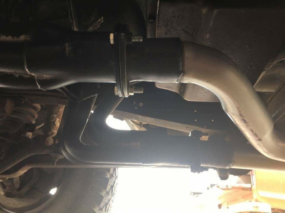

No more light. Tomorrow, I look at:
Exhaust leak
Possible ATF leak
Secondary battery relay not kicking
