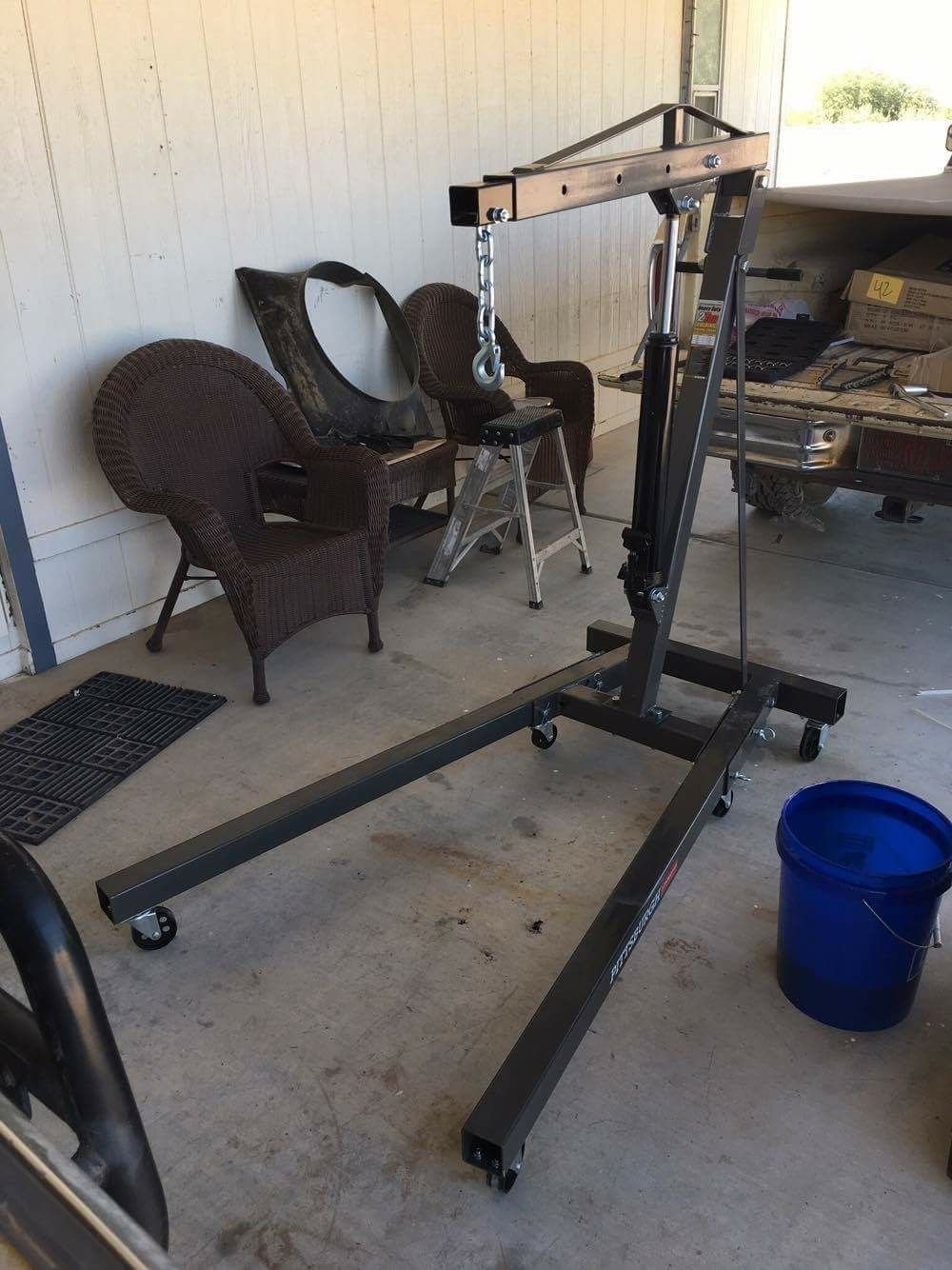

I returned home and assembled the hoist and stand-no problems! I had some good advice in another thread that said to leave everything loose until completely assembled. Once it was all together, than tighten everything down. That was a good tip!

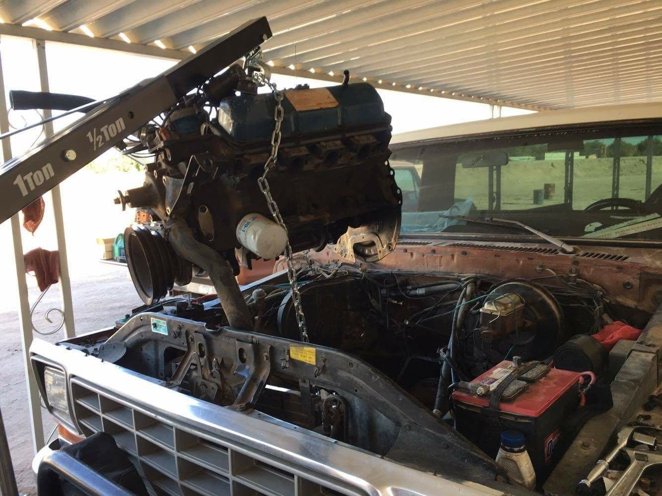

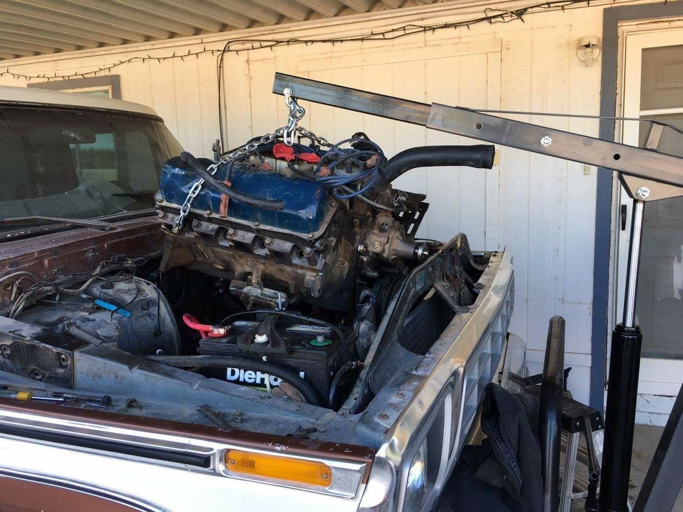

Upon my return, I bolted up the chain and gave the motor a lift. Too tall to clear the hood. Drop the motor, remove the carburetor, raise the hook in the hoist and try again. Still, motor won't clear the radiator support due to the hood. Now I'm starting to understand why guys just remove the front clip!
Unbolt the hood hinges, get the kids to help me carry the hood, and return to the hoist. Lift the engine a little more, and it's out!

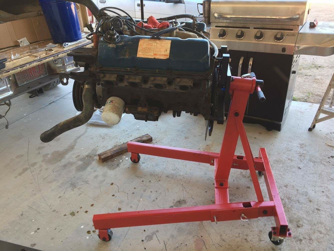

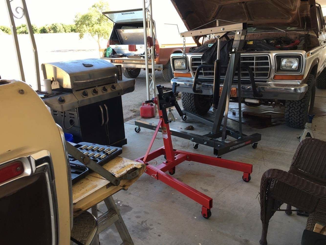

Somebody mentioned that the big hoist and big stand don't play nice together. That's true. I ended up bolting the mounting plate to the engine, hanging the stand on the plate, then dropping the assembly, while using a 2x4 to cam the leg of the stand over the leg of the hoist. Engine now on stand, and I'm done for the day!

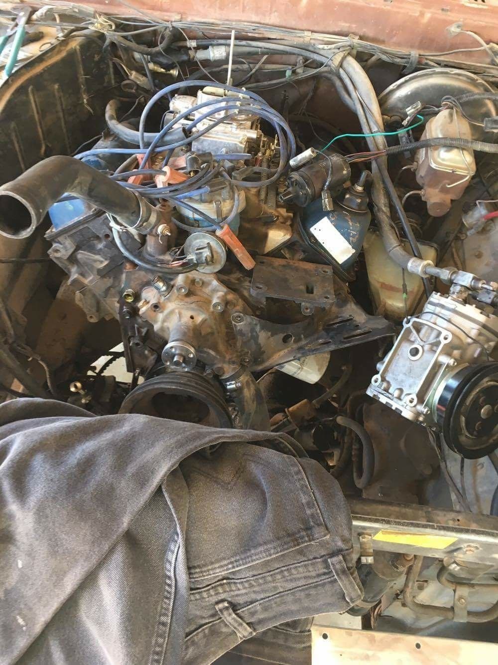

Radiator out, accessory devices removed
Building the crane
Crane built
Stand built
Chained up
Push bar in the way
Hood off
Motor up
Motor clear
Photo-op for the helpers
Engine on stand
Engine on stand
Engine on stand
You know you drive a dent when you're using the tailgate of one dent to build the crane that's gonna pull the engine of another dent while another dent holds the toolbox

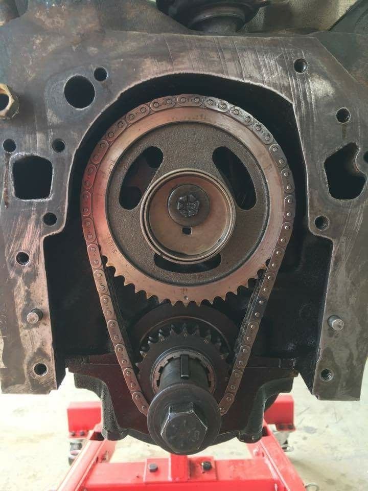

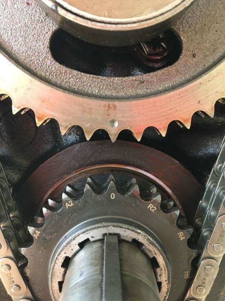

I've got a Summit double roller timing set installed straight up. Is that a different setup from the 71 you mentioned?

Re getting the engine stand and engine lift to work together better, here's what I (eventually) wound up doing:
  1. Lift the engine out.
  2. Set it down on the ground (water pump should be facing toward the lift)
  3. Spin it around 180º so that the water pump is facing away from the lift.
  4. Lift the engine above the stand (extending the arm to the max helps here).
  5. Roll the stand under the engine.
  6. Lower the engine and bolt it to the stand.
This procedure brings the legs for both devices into the same harmony as spoons in a drawer. It's also safer in that all the wheels stay on the ground.
Now that you have the engine on a stand, life will improve significantly. ;-)

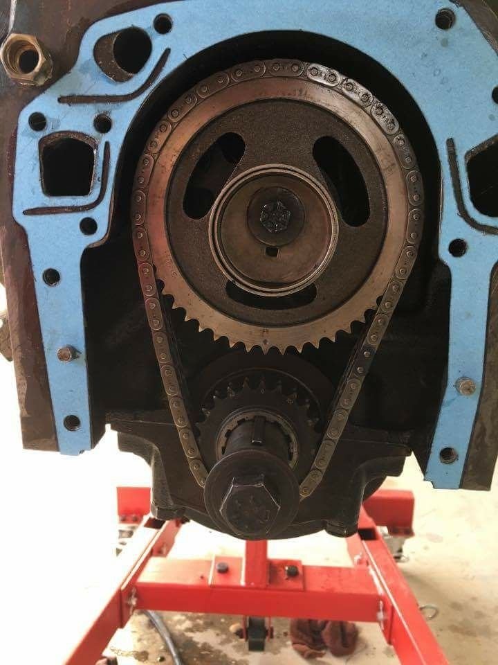

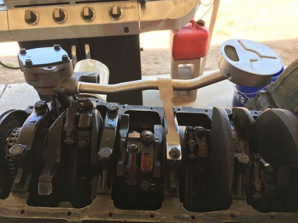

Got a lot done today (at least for me):
  • Cleaned up the block face and timing cover
  • Installed the timing chain cover and new water pump
  • Installed the counterweight and harmonic balancer (I think that's what they're called)
  • Installed the new oil pump and pickup

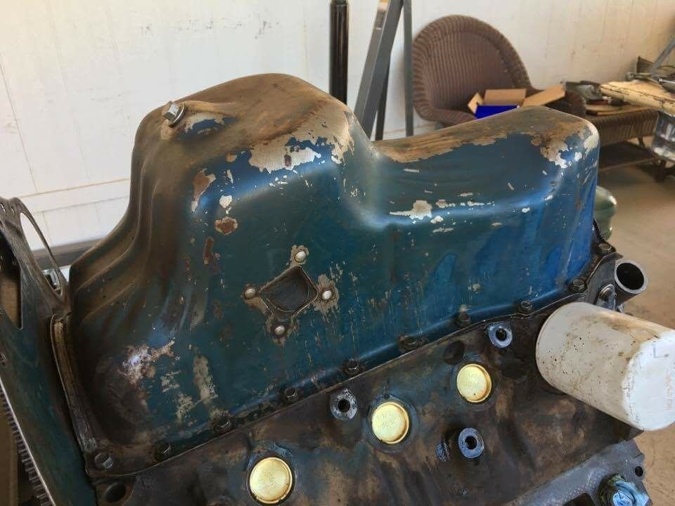

  • Installed the pan
  • Removed the old freeze plugs and discovered one had been a block heater. Sanded the openings, cleaned with brake cleaner, replaced the plugs. Sealed with Indian Head shellac

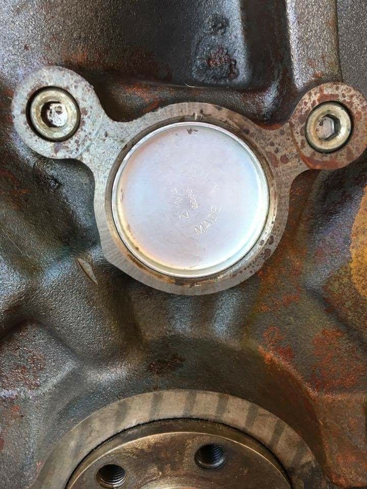

  • Replaced the steel expansion plug in the back of the engine, although I probably should have left it. That's not actually a water jacket-it's behind the cam
  • Cleaned up the block and pan
  • Reinstalled the flywheel
  • Installed the dipstick (but I should have left it out)

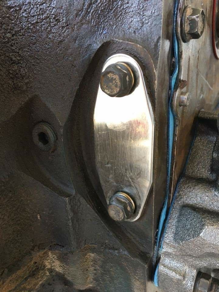

  • Put the headers back on with just two bolts each (but I should have left them off)
  • Installed my fancy Summit lift plate (yeah, I know)
  • Raised the engine and put it in the engine compartment
  • Couldn't get the headers to clear the transmission, so I pulled them
  • Lined-up the engine to the transmission, and kept it in line with the long bolts from the engine stand
  • Connected the flexplate to the torque converter
  • Replaced the long bolts with the correct bolts as I mated the transmission and engine
  • Mated in stages, rotating the crank every time, so I could install another nut on the torque converter
  • Got the engine and transmission together, then finished up the motor mounts
Ran out of light and energy. When you can't find the tools anymore, it's time to knock off for the day!
Straight-up
Summit double-roller timing chain
Timing cover. New seal
Timing cover. Clean
Timing cover gasket
New water pump
Electric freeze plug?
Freeze plugs out. Clean block. Sand holes
Block heater!
Shiny happy freeze plugs
Summit fuel pump block-off
New Melling high-volume pump and pickup
Rear plug
Pan on
Flywheel on
Degreased a bit
Harmonic balancer
Ready to install
On the hoist
In the truck
Lining up the transmission
Done for the day
