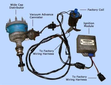

For the harness, 1980-1983 Ford trucks and Broncos with the 5.8/351 2V engine is what you are looking for. Or, a 1984 - 1986 truck or Bronco with the 5.8 4V H.O. motor. Except for some California models, these had the Dura Spark II ignition system. And like Gary Lewis said, a 1980 - 1983 (and some early 1984) truck or Bronco with the 5.0/302 will work also.
Does your truck have a factory tachometer? If so, the Dura Spark harness will have a plug for the tach if the donor truck had a tach, so keep that in mind as well.
Here is a picture of the components you need to successfully make the conversion. When you remove the EEC-IV harness from your truck, the open plugs ("to Factory Wiring Harness") simply plugs into your truck's existing wire harness. The harness has plugs for the oil pressure and coolant temperature sending units as well, so there will be no need for any cutting or splicing:
