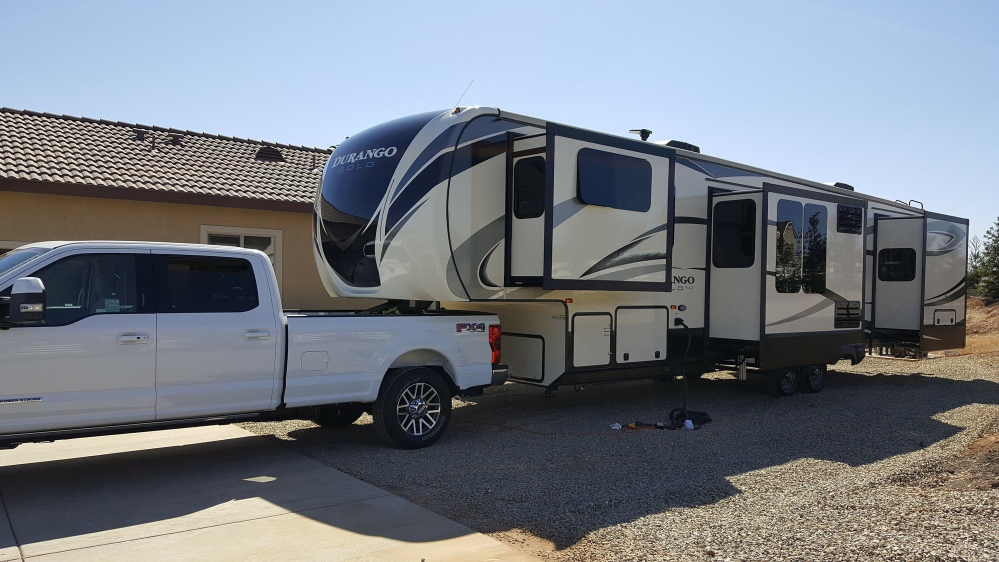

twack not to high jack this post but I would like to see some pictures of that new 5th wheel.

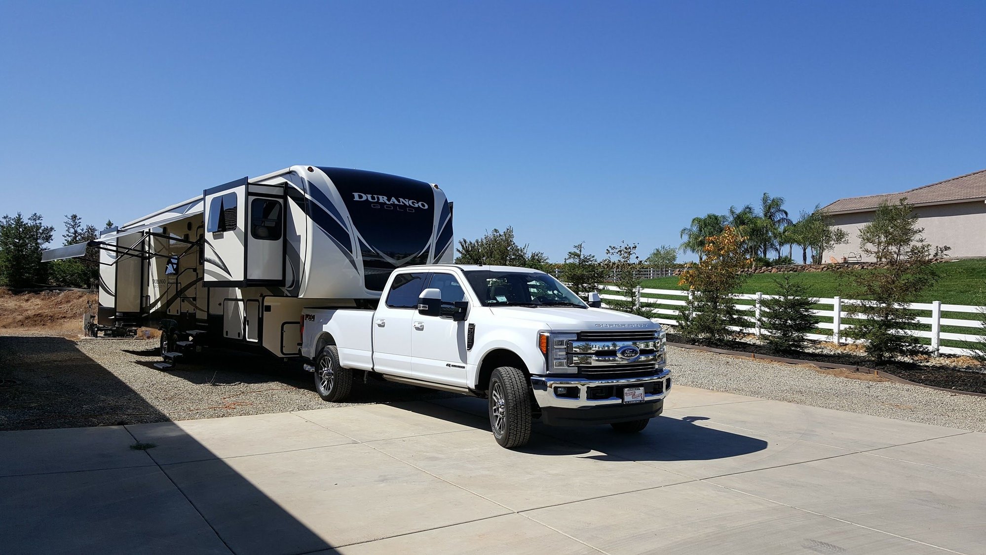

Sorry Mod's, but was requested
It's a 5 slider: 2017 Durango Gold 5th Wheel G380FLF

Twack, your truck seems to sit pretty level with the FW on it, are you using any suspension compensation such as Stable loads, Timbrens, Air Springs, Etc?
What's is estimated pin weight?

Kampn,
The truck squats about 3-4 inches when raising the landing gear on the FW.
I believe the dry hitch weight is about 2250 lbs. Wet and loaded, I suppose around 3000 lbs. I went with a B&W Companion Ford OEM dropin FW hitch. Awesome!
I did not have EB before. Previous rig was a 1990 XLT Lariat with 460 so I have no comp's. Wish it did have diesel with EB though. I know I'm going to save money on brakes since I'll be towing a lot up into the Sierra Nevada Mnts.

Truck and Trailer both are beautiful. Have a 2015 F350 DRW and pull a 40 foot Big Horn, have not mastered the EB. Would like to but haven't yet. Do no like the mountains. Your KZ is really nice looking. Is that a Trail Air on there too? Take care. Dave
