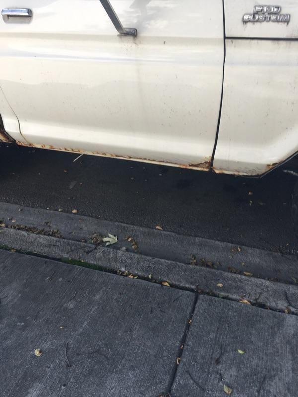

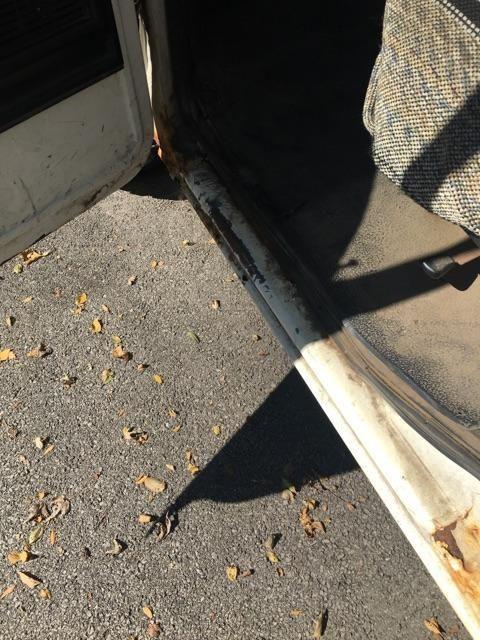

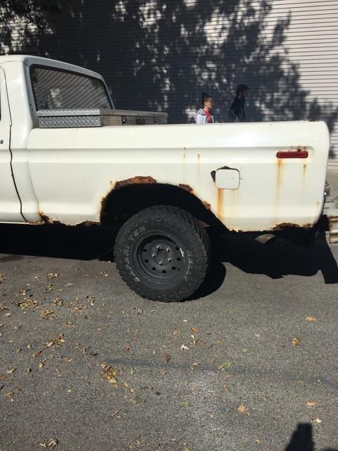

Here is a few more pictures of the rust.

Yes its rusty, but all that really matters rust wise is the front cab mount being secure, look behind the plastic inner fenderwell liner to ck that, the rest is easily replaceable stuff. I bet you could get it for $1650 or maybe a little less for CASH.
