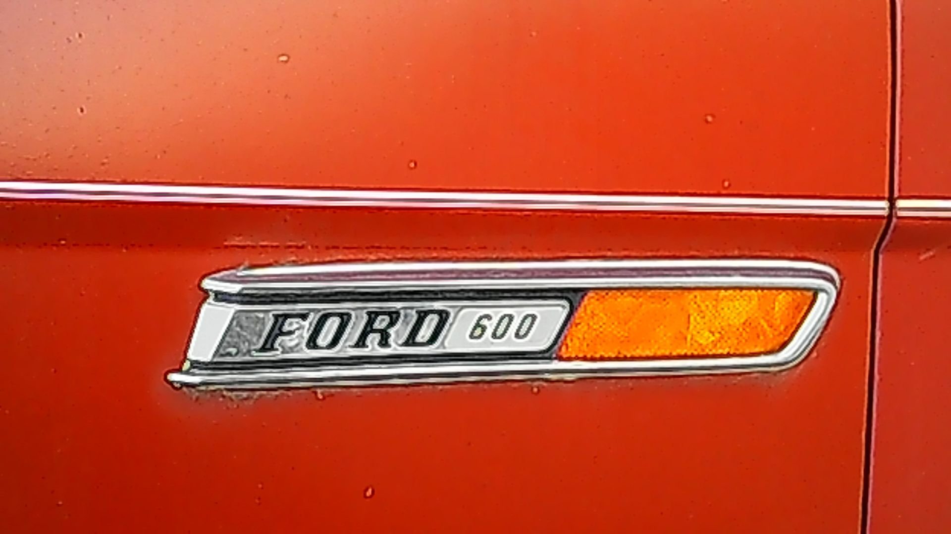

Hey,
So why does it show F600 on the side light plates?
Dutch
No such thing.
Look at the emblems again.
Emblems on the doors of 1968 and later C600's with the yellow reflector are not marked FORD F600 .. they are marked FORD 600
Pic: Column left, 4th row: C/CT series Tilt Cab (COE).
Some people confuse C Series Trucks with F Series Trucks because they use similar 500/600/700 etc. emblems with a yellow reflector, but only the C Series has them on the doors.
1968/72 F100/750's have them on the sides of the hood.

You are quite correct (rats) any thoughts on the Vin and missing data plate? or other vin markings on engine or chasey? is there some usable database out there on these?
