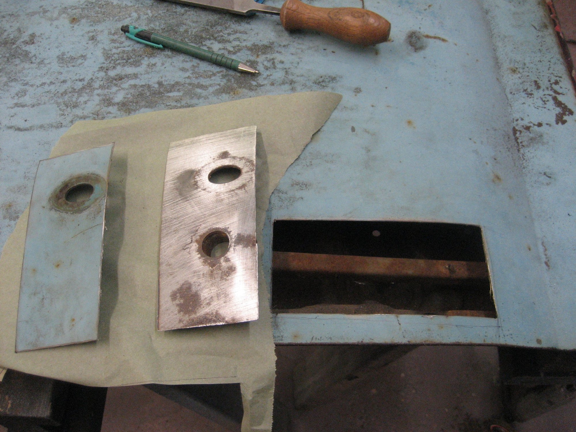

On my 51 it was a little more complicated than just cutting the hole. Besides finding the door latch mechanism with the lock assembly, the means to attach the key lock tumbler needs to be added. We cut that area out of a badly rusted Deluxe door and installed it in my regular 5 star door.

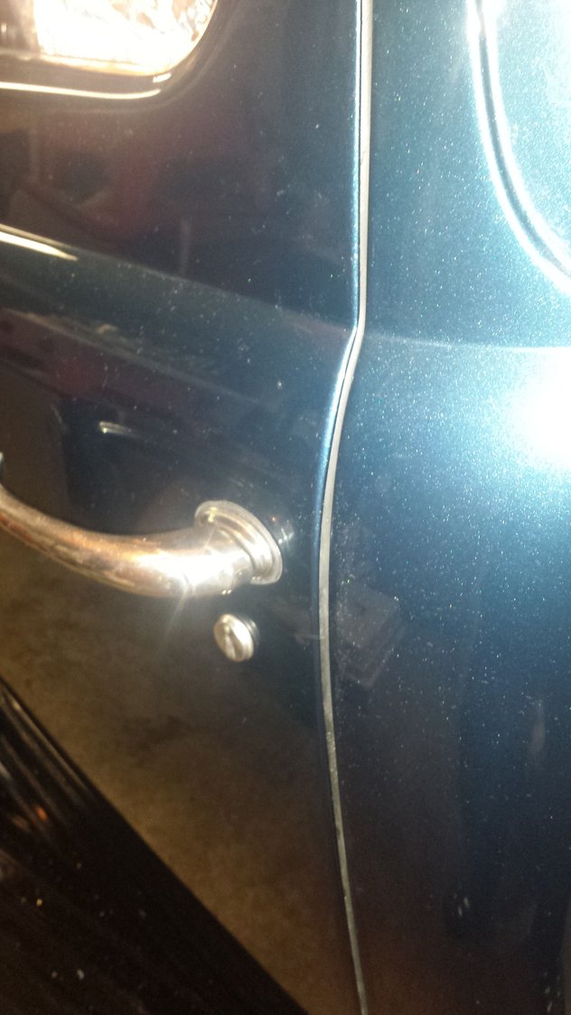

I added the key hole on my drivers door on the one I'm doing now and also using the Altman locks which I had to modify to work. I also bought the power lock kit from Midfifty..
