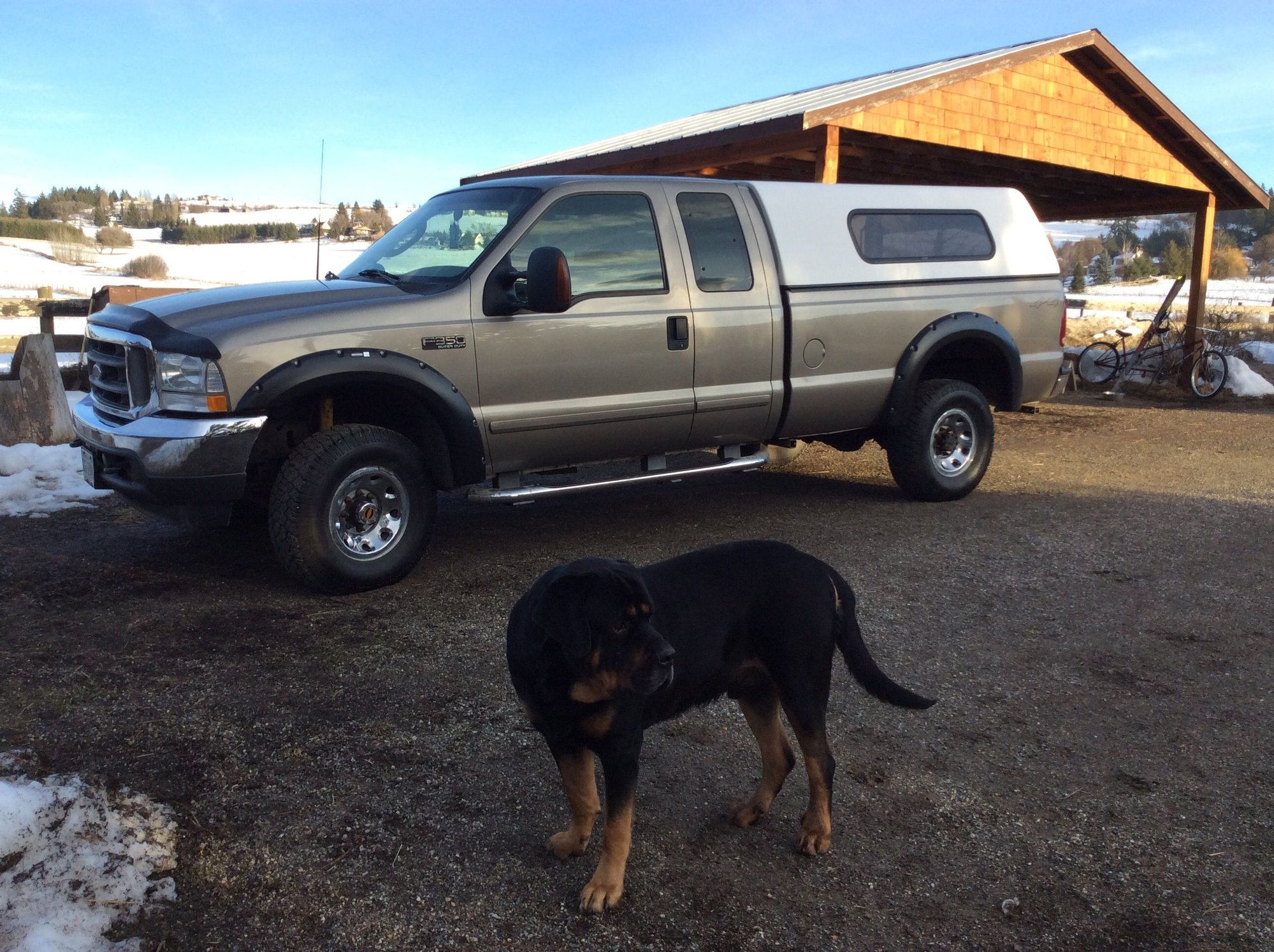

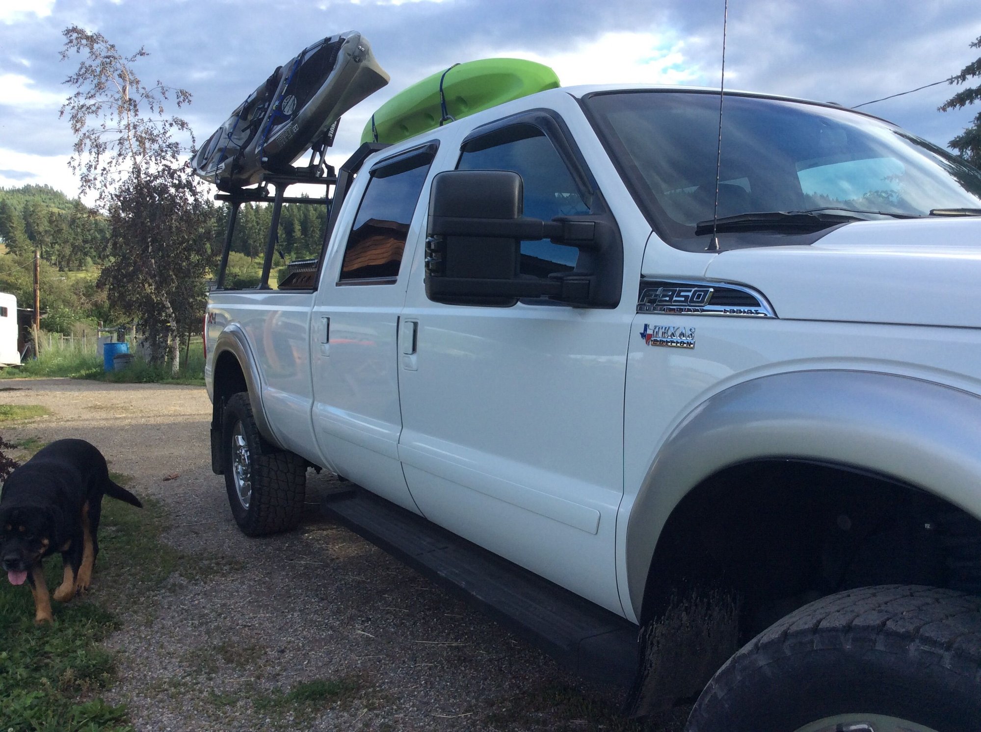

My 03 has the tube running boards and my '11 has the no gap running boards. Having the no gap is far superior imo. Keeps the truck so much better protected.

That's what I'm after, up tight to the body like your 11.

Had the black full coverage plastic ones on my 08. Yes, far superior as far as protecting the rockers.
