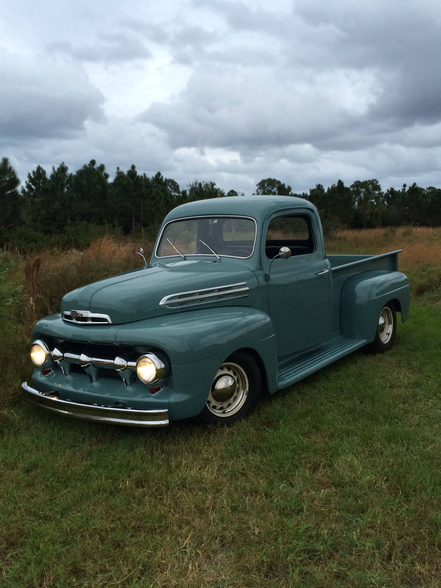

I never thought about actually checking the rake with a degree finder, Im going to check mine today, results to follow.
Good looking 51! Looks like about 3 degrees also.

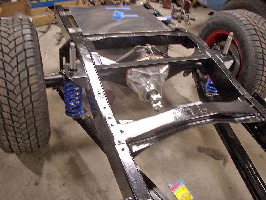

I have jack screws that allow me to easily raise and lower the rear end. I find I prefer about a 2-3 deg rake as well.
would you provide a pic of your "jack screws " ?
Here you go. These were not installed by me but by a previous builder along with the truck arms.
