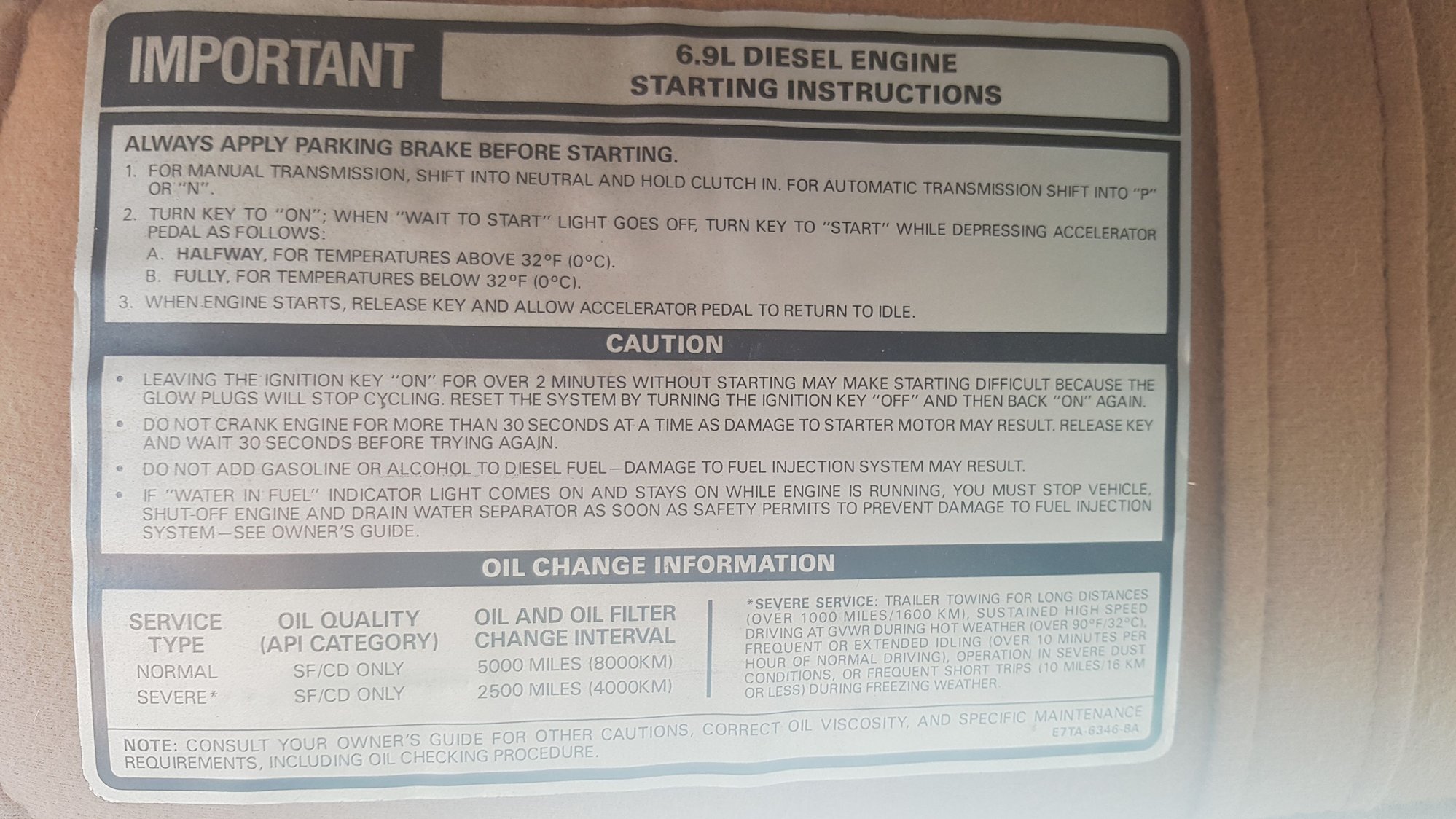

I can't remember exactly how its stated... but goes something like this:
Turn key on
Pedal to floor and release (in cold weather hold pedal halfway**)
When wait to start like goes out, crank engine
It may state hold pedal halfway all the time, and fully down in cold weather... Basically the tap to floor lets the fast idle solenoid extend. Not sure if it was in all trucks, or if a PO removed it, but that info (and more!) is on the driver-side sunvisor on a sticker. And yes its the same for any transmission.
Look how crispy clean that sticker is hehe

No sticker on my sunvisor!
