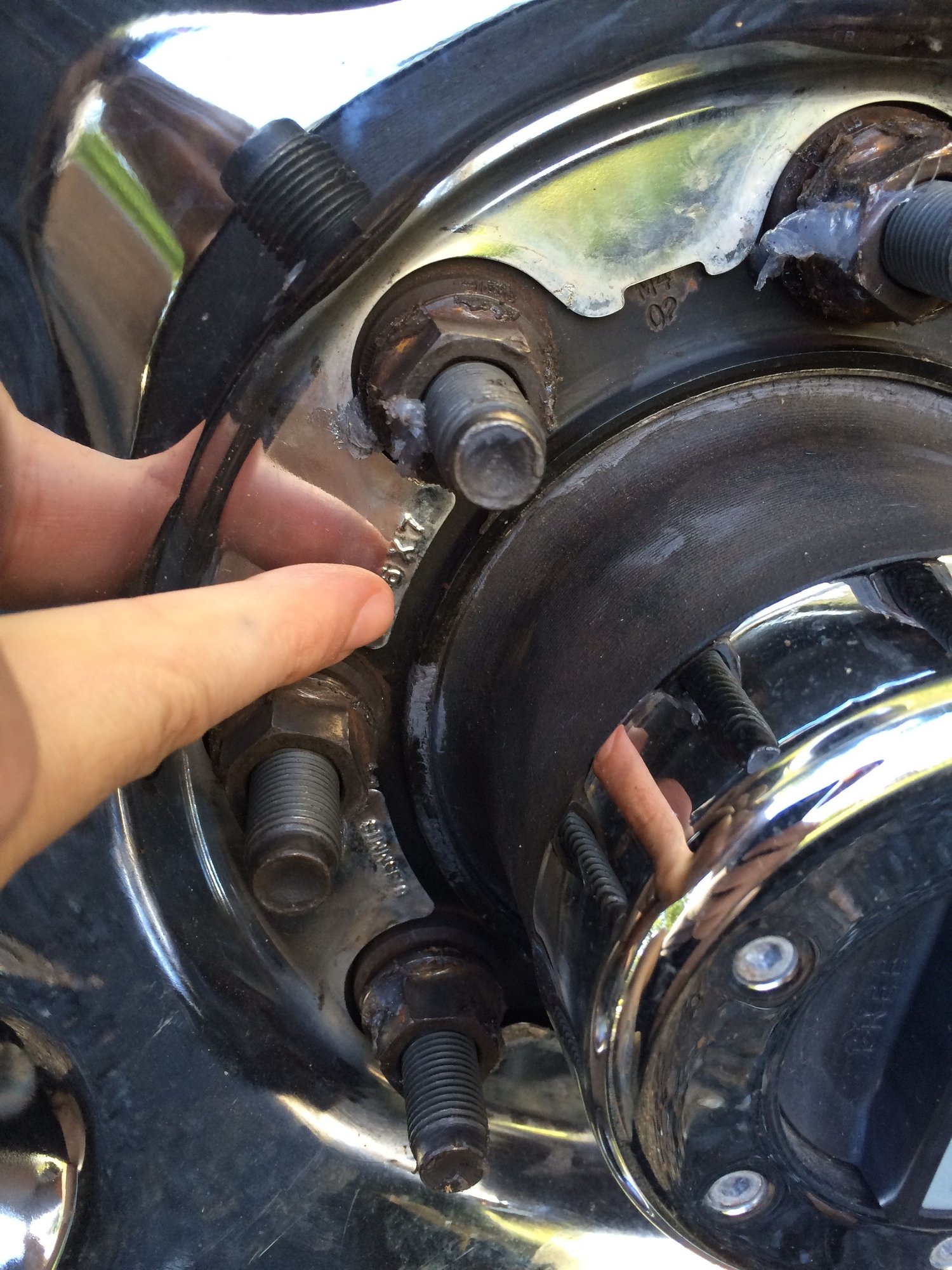

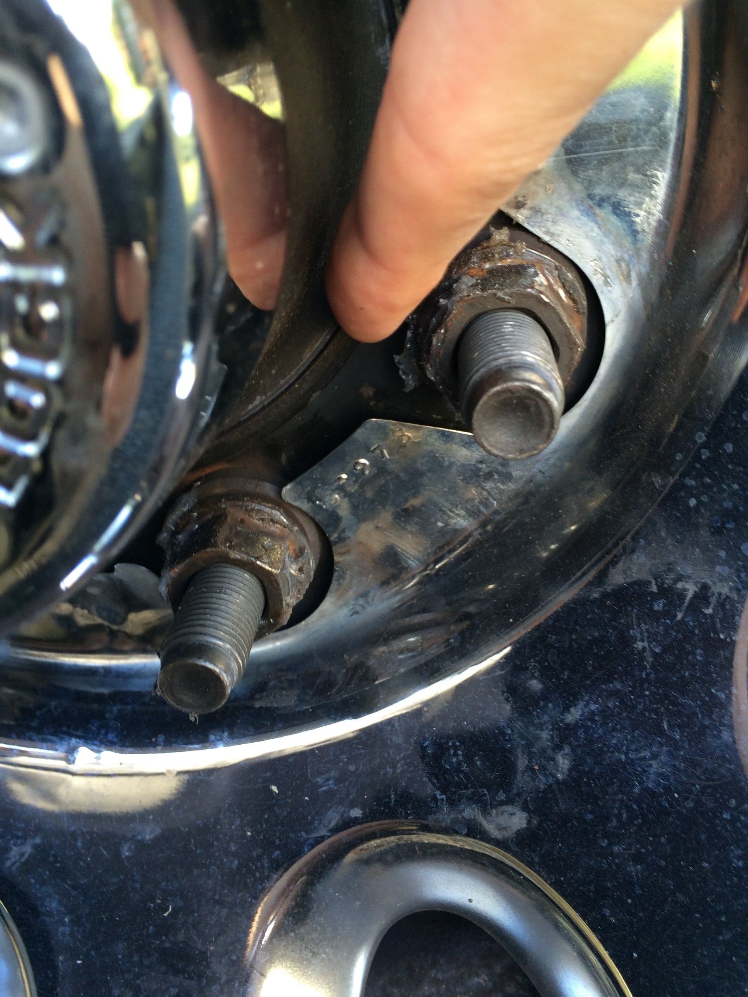

Yes:
In the first picture, you can see that the rim skin is flush with the rim. But in the second picture, it's raised up quite a bit.
It almost seems as though there should be something holding the rim strip down, either a ring under the lug nuts or a washer on each lug nut, I don't know.
Ignore the silicone around the lug nuts, I originally thought that the hub cap might have had a few cracked sections where it attaches, thinking that silicone would hold it on. That's when I noticed some of those sections of the rim strip were not flush with the rim.

But from what I can tell, a few of the tabs on the rim skin are raised up enough to keep it from locking.
Chris, are all of the tabs on the rim skin, where it meets the rim by the lug nuts, flush or are any of them raised? They all look flush to the rim, as they should be.
