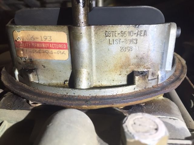

I'm about to replace the Carb on my truck with a Edelbrock 600 but need to know if what I have is a Square Bore Carb. The truck is an all original 79 F250 2WD Regular Cab XLT Ranger. It has AT, Factory A/C, 460 4BBL. It is almost completely original but I know that the Carb was replaced at some point with a reman Motorcraft. The Part stamped on the Carb is D9TE-9510-AEA.
So two questions:
1) Is the current carb a Square Bore? I'd perfer not to uninstall until I've got the replacement in hand.
2) Any suggestions for the Carb replacement?
Thanks!
Is this a Square Bore?

Look at the throttle plates. Square bore will have four plates the same size. Spread bore will have smaller primary plates and larger secondary plates.

ID number: D9TE-9510-AEA = Ford part number: D9TZ-9510-AE = Holley 4V - 1979 F150/250 & E250 460 (all 1968/82 460's were only available with C6's).

Here is what is under my Edelbrock 1405. I have a 78 f250 with a 460 and stock intake. That'd be a spread bore. The primaries line up just fine but the secondaries are much smaller than the spreadbore secondaries.
