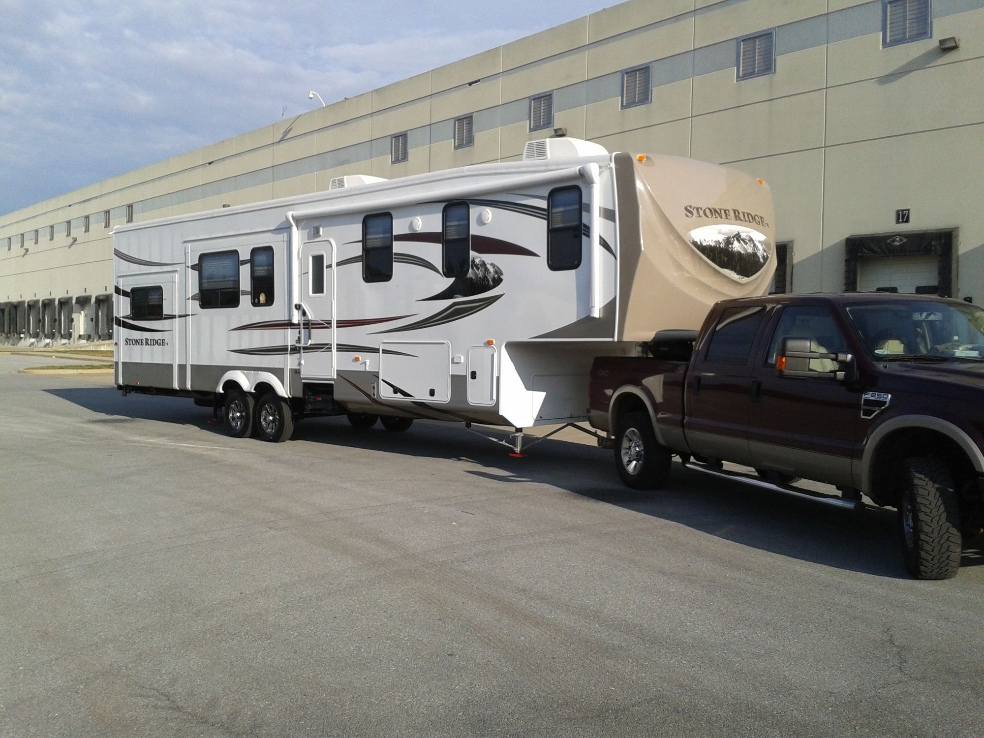

Always go the GVW of the 5th wheel when determining king pin wt. Then 20% of that number will always get you much closer then going by the sticker that is provided.
Still need to put in on the scales to ensure you are not over your axle ratings and tire ratings.
I would opt for a long box so you get the biggest fuel tank. Especially if you are going cross country.
A F250 shortly will certainly do the job easy. This was my 08 F250 with a 6.4. It was a good motor for me.
Trailer comes in a hare under 16K

Picture I posted above shows a lot about the capabilities of the trucks.
I would be looking for a 2013 F350 SRW at least for your use.
You need to have a payload capability of at least 3100 lbs so you need to look at the axle ratings on the door cert and then look at the tires to see if they can handle the load.
