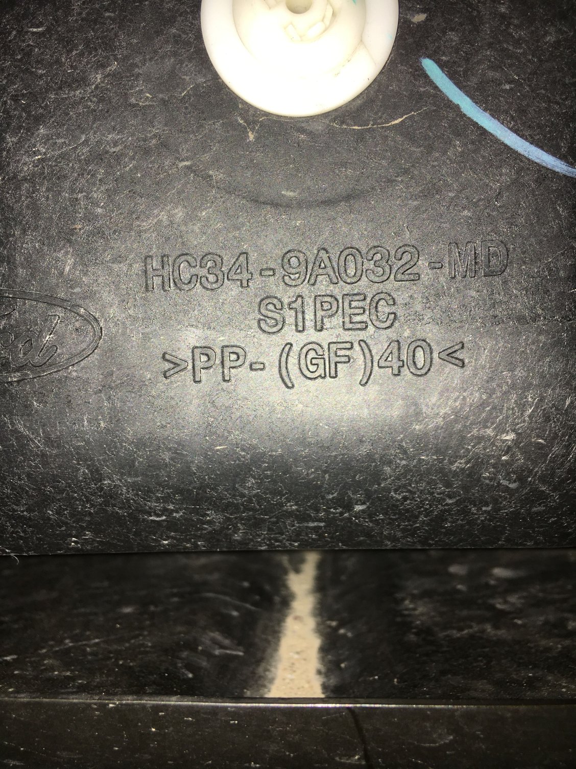

I agree something's off, but I'm hoping its not the tank. So....I grabbed the creeper and went out in the garage. My first intent was to measure up the tank and see if I could get close enough to figure the capacity via math. However, in looking I found the part number and more importantly a stamp with "34" in it (See pictures). I figure the part number will tell us for sure, but at the very least, the stamp is a good sign. Is there anybody on the forum that could run the part number to see for sure?
Thanks for the detective work. I am going to crawl under mine this evening to confirm the same stampings on my tank and will post the results. I intend to go to a dealer this weekend to see about a recalibration.

I assume the 34 in my tank is confirmation also.

Also...another test might be to crawl under a '16 with the 29 gallon and physically measure the tank if possible....and do the same with the 34....just to see the difference and make sure. Or see how the 29 is stamped.
