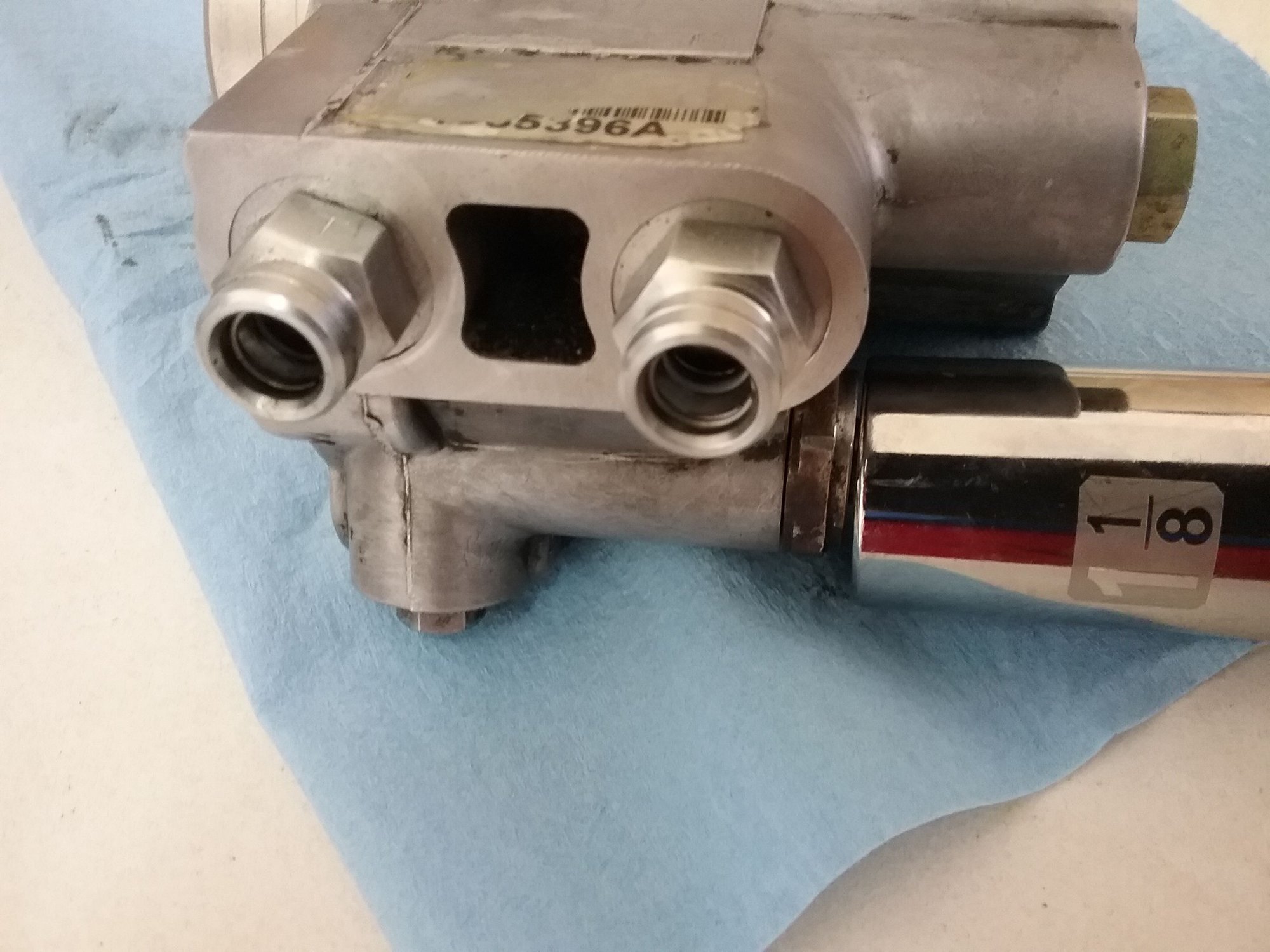

Here's a pic I stole off of Tugly, can you identify the fitting in this picture?

These fittings?

Originally Posted by SGnAZ
These fittings?
Yes. Those fittings. The one on the right.
