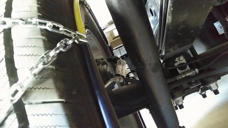

Hey Norcal, I tested my 4Runner chains on the truck this morning. Image is below, and from what I can see, there seems to be a lot of clearance. The chains are obviously loose since they're made for a 26570R17 versus the truck's 24570R17 tire, but even so, clearance to components seems to be more than adequate.
The chains are the S class TUV diamond chains from tirechains.com. URL below is to the chains that fit the 24570R17:
P245-70R-17 Tire Chains
I rechecked my owners manual. and the manual itself says that S class chains are fine for all tires except those specifically listed in the manual as "do not use chains" (they are all larger, taller tires). So I have to wonder if that whole chain disclaimer thing shouldn't actually apply to many of the OEM tires, and maybe dealers, either because they don't know better or are covering themselves, make everybody sign it, even for tires where it doesn't apply that are specifically listed as okay for S class chains in the manual.
Anyway, I can't see any reason not to use S class chains on mine. Caveat is I have a 2WD, so only tried on the rear. I don't know if there are clearance issues on the front for the 4WD folks with my size tire.
