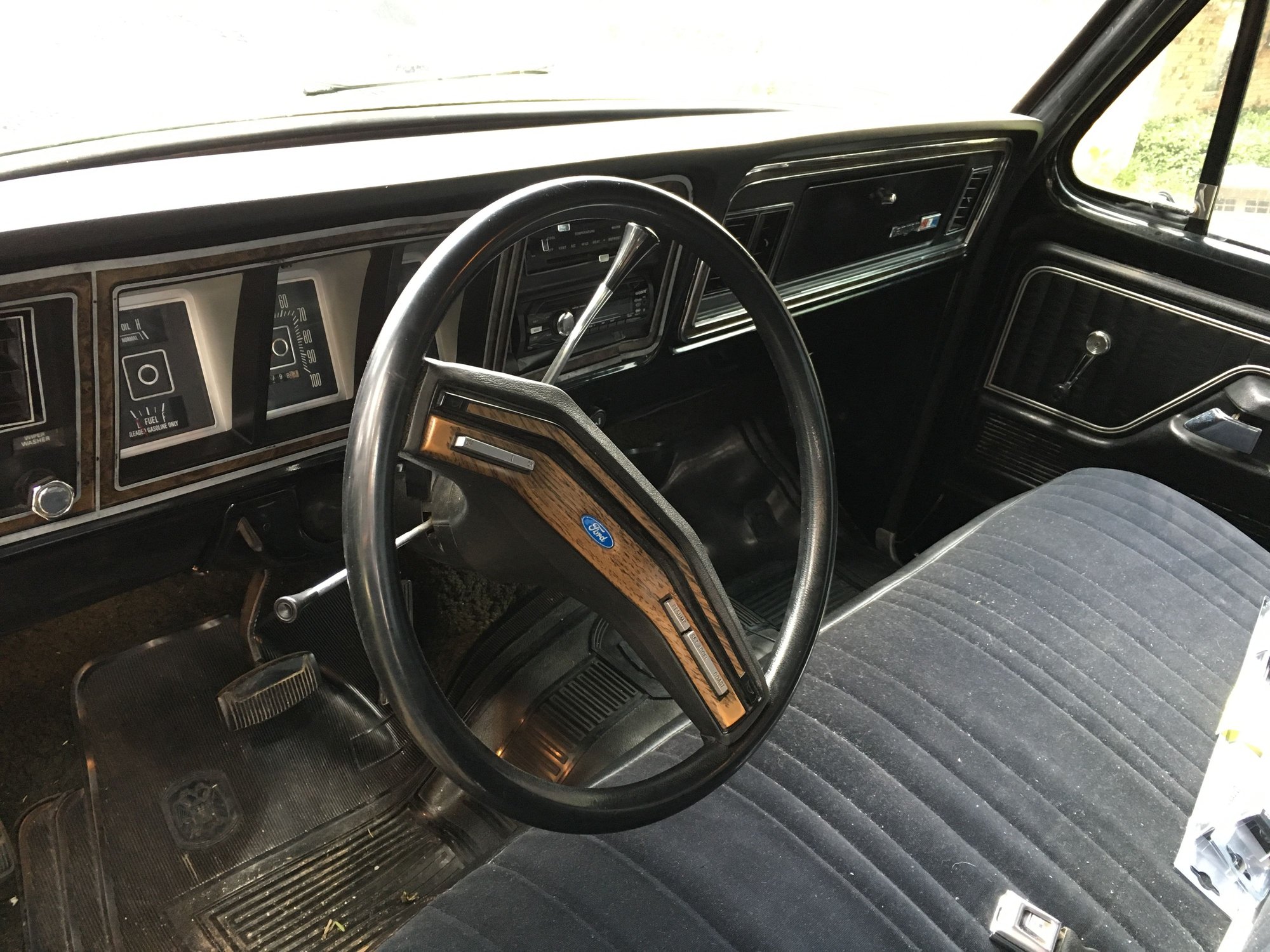

Well, I am new to posting and tried to insert some photos of my new ride. It is a 1976 short bed with a 390 2bbl, auto, A/C, PS, PB. I am not certain if it has a factory cruise. It has a period correct cruise wheel but it did not work. How can I tell if it does have cruise? Really a clean truck no rust to speak of. It does need new window felts and some small things like that. Where is a good place to find replacement items? Thank you for helping.

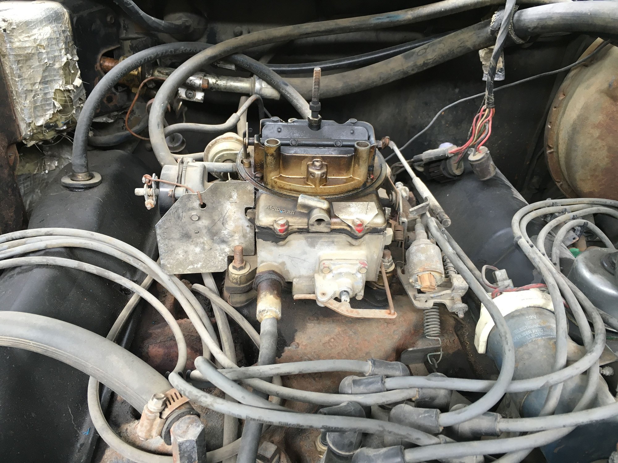

Post up some pics of what the engine looks like and the steering wheel....then we can tell if the P.O tried to put in an aftermarket cruise control set up or tried to adapt factory pieces onto the truck for a more stock looking appearance.

This is the wheel and engine. the only classic I've worked with is the old mustang that had no cruise not was it a complete car when we got it. Thank you for your help and advice

The Speed Control steering wheel appears to be from a 1978/79. It may have been installed because it could have a tilt wheel.
Many 1978/79 F100/350, Bronco & Econolines that have Speed Control also have Tilt.
Grab the wheel with your right hand, push the T/S handle forward with your left hand to see if the wheel tilts.
Upper & lower pics: 1978/79 Bronco (F100/350 same) 351M/400 factory installed Speed Control.
