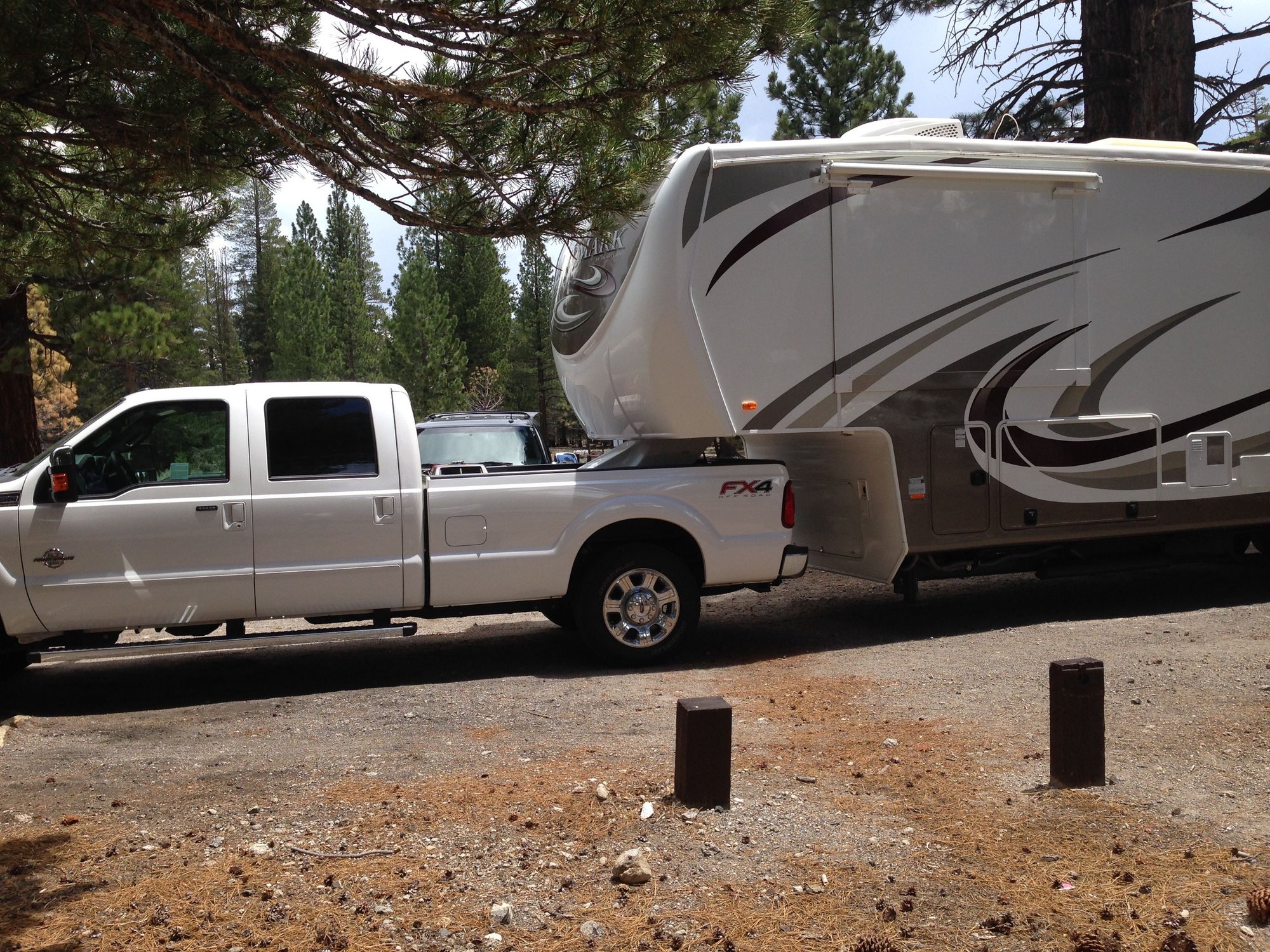

Ditto on what senix posted. You and I have the same truck. I pull a 2013, 40 foot Heartland Landmark Key Largo. The dry weight of the 5th Wheel is 13265 and I have loaded it full of water, propane, gear, etc. up to 14760. It has a max GVWR of 16250 and Pin weight of 2975. I even towed it up a 8% grade for 10+ miles at a steady 60mph in June. The truck never over heated. The cab had three adults and I also had my Honda 3000 generator and wood in the bed. I was impressed with the power of the truck with all that weight. I was probably right at the max with everything. Just remember just because you can doesn't mean you should.
