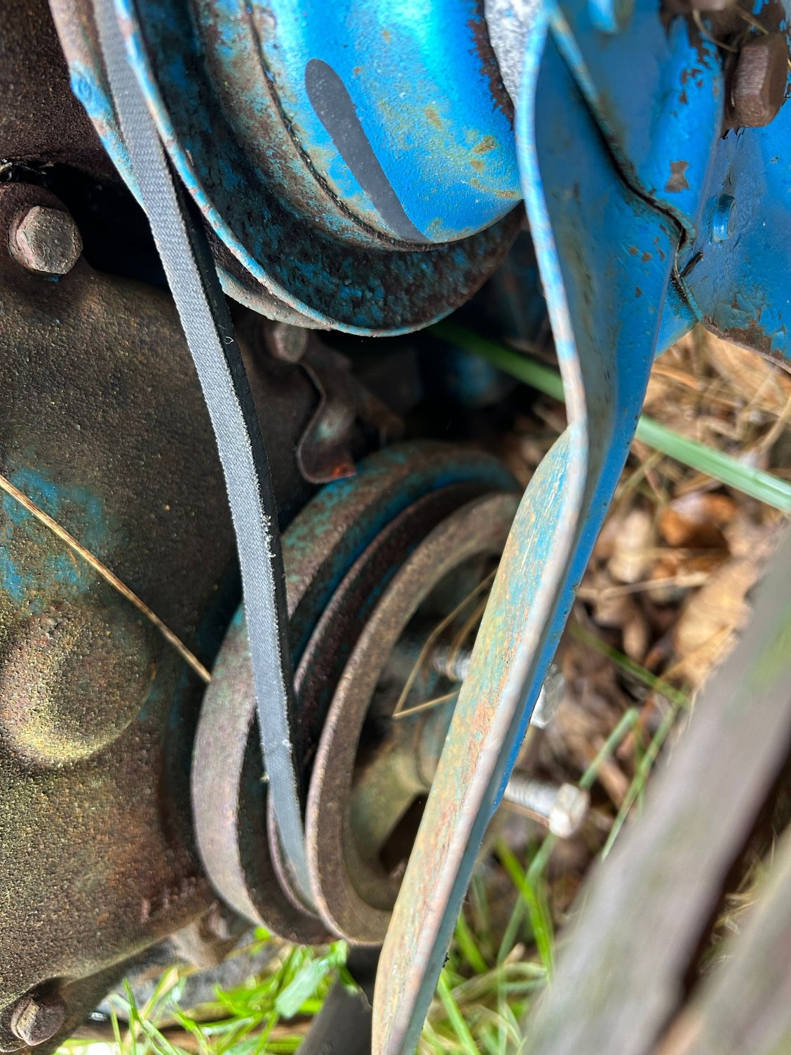

Here is what the pointer looks like on my 54 223. Hope this helps.

Thanks. Is the pointer at the 12 o'clock position? Or is it to the drivers side. Hard to tell in the picture.

The pointer is very close to the 12 o'clock position. I am not sure if it is exactly at the 12 but if you have one that bolts on, it can only be in one position.

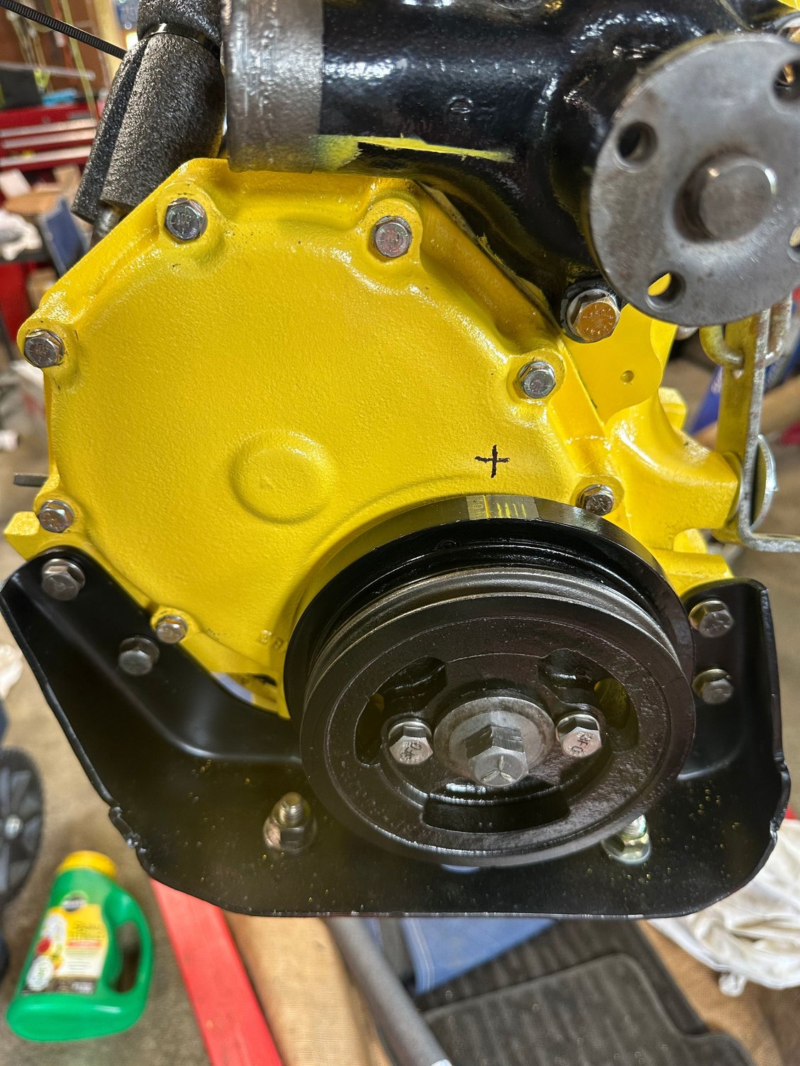

I am also missing my timing pointer for the cast cover and wanted to see if anyone had one. Did some searching online and have come up empty.
I measured the location on the Tin one I have and tried to mark it on my cover but a proper pointer would be ideal.

Ahh, you are probably looking for B6TZ-6023-A, which I think looks something like this. I don't have an immediate source.
However, you can always set the engine to TDC (looking at the valve positions, putting a long indicator into cylinder 1 etc etc) and then mark the timing cover accordingly.
