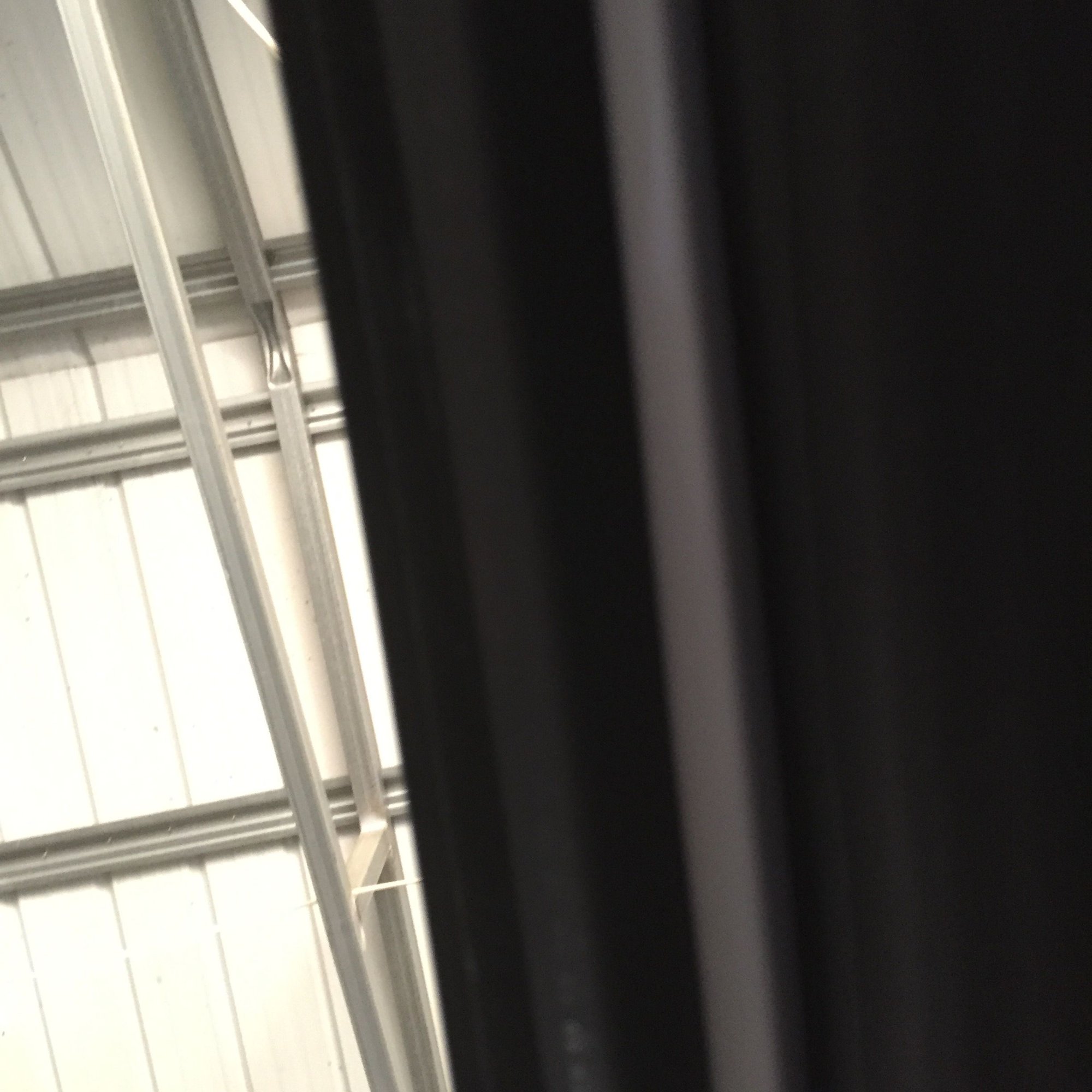

I went there and picked it up, but not before I looked at a new one in the showroom.
Mine is magnetic (like a silver-gray). The one in the showroom was white, so I was able to take a picture to illustrate what I think is the issue or part of the issue due to the better contrast between the white paint and the black weatherstrip.
There is an outer weatherstrip and an inner weatherstrip. What you see in the picture is the inner one. It snaps onto the body seam weld that runs along the door recess. This is the driver's door, where most of the noise is.
Looking forward into the weatherstrip with the door closed and window down, you can see that the weatherstrip at the top and bottom are in place between the body and the door. However, in the middle, the weatherstrip does not align with the door frame and it appears pushed out. Some of the remaining part of the strip does appear to be in contact with the door, but this does not seem right to me, so where there's smoke....
The service manager told me that they are engineered that way.
Please take a moment to look at the attached picture. Does everyone have weatherstrip that looks like this?
Thanks!!!

The fact that people say theirs is quiet leads me to believe that there is indeed something wrong. I do wonder if everyone has the weatherstrip in the same location as the picture I posted.
Another thing I found was that the noise gets very bad in crosswinds. That part I really don't understand.
Perhaps someone can shed some light on that and the weatherstrip picture?

Originally Posted by firedaniel
Drop by the lot and compare it to another expedition... Make sure all the weather stripping is on right and the door closes right. That's the best I can think of
That's what I did. The picture in this thread is from another Expedition. They told me that it was engineered that way. I have never seen weatherstrip like that and I think what they told me is bogus, which is why I asked for folks to take a look at their weatherstrip and see if it looks like the one in the picture.
With the window down and door closed. You can see the weatherstrip where it meets the door. I think the weatherstrip is supposed to be "sandwiched" between the body and the door's window frame, unlike what you see in the picture. To me, that weatherstrip is not seated right or installed right.

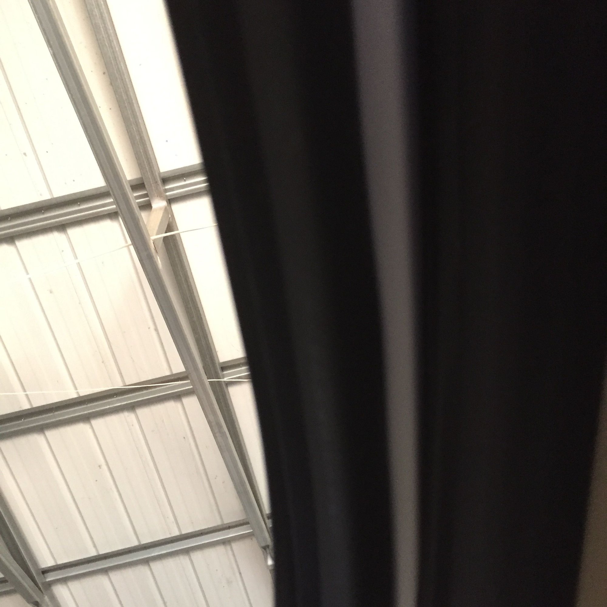

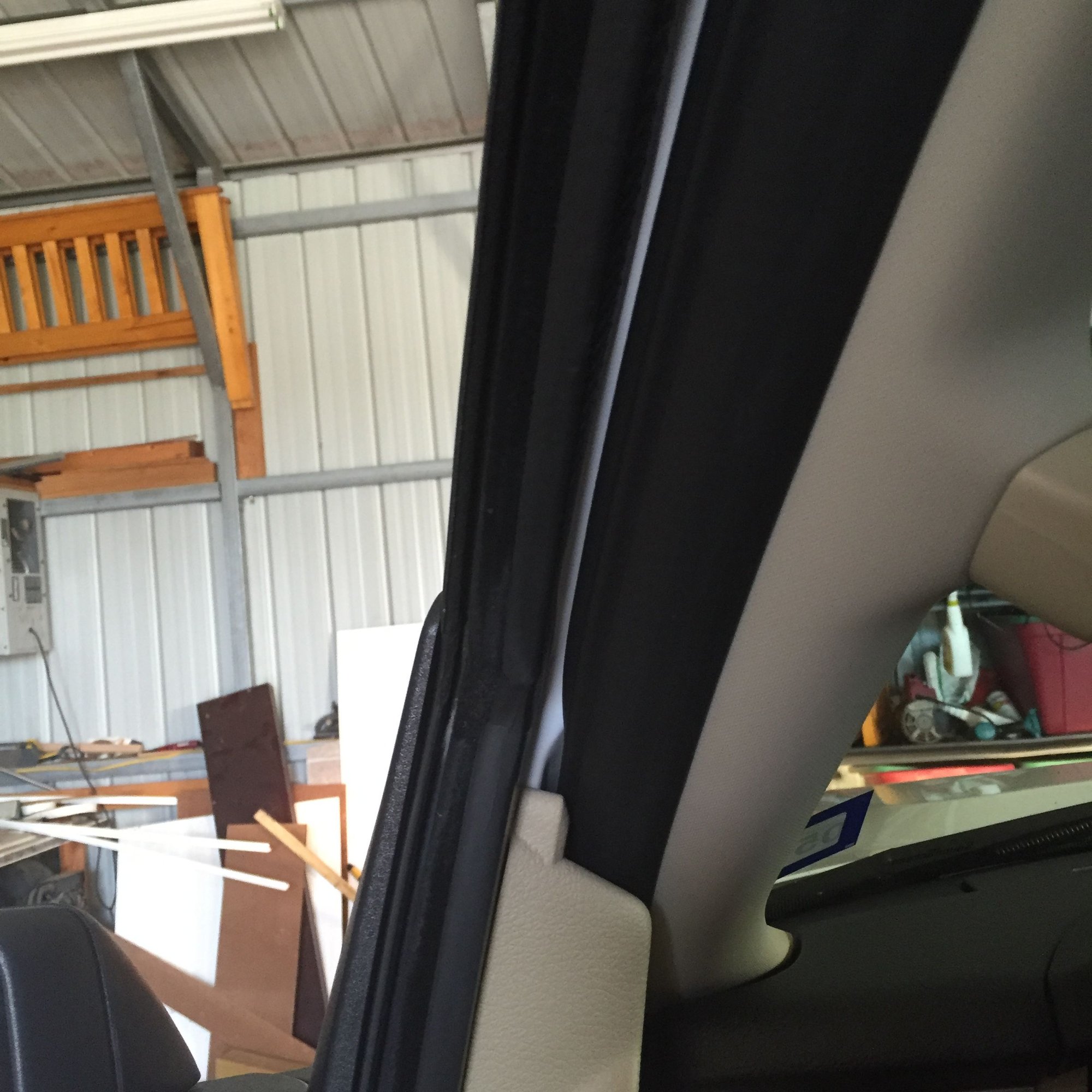

Happy to take a pic I'll try to get one today

Originally Posted by developer
Quite nice of you. Thanks!!!
Not exactly sure what angle you need hope this helps

Posts: 96
Thank you very, very much for taking the time to post those pictures.
Clearly, the weatherstrip in yours is positioned differently than the one at the dealer and it is also different than mine.
Mine bows out just like the one in the picture I posted, instead of being "sandwiched" between the door and the body the way yours is.
This helps me to pinpoint the cause or a contributing cause for the wind noise I'm getting that others don't seem to have.
Thanks again for your help!
