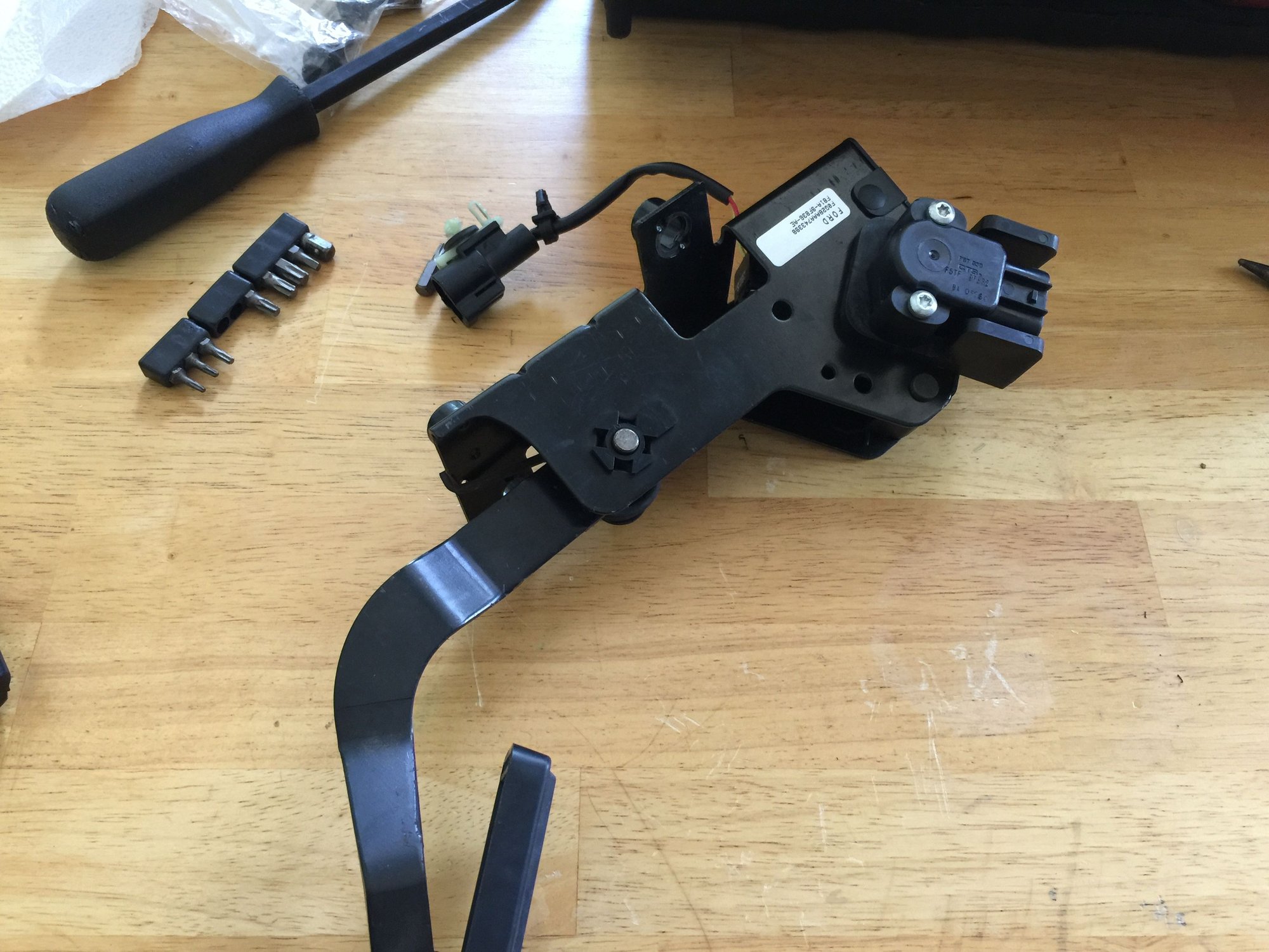

Say, for example, you're chasing a very intermittent dead pedal along with a very frequent P0720 code for the OSS. Say you verify the sensor is working properly, replace it even! Say you check the wiring for continuity, short to ground, and short to power and everything checks out fine. Perhaps it's the throttle pedal, wherein lurks the mother****ing ******* bitch faced **** munching TPS. Say you call the dealership and ask for a price on the aforementioned mother****ing ******* bitch faced **** munching TPS and you hear $416.xx. 'It's integral to the pedal assembly for your year sir'.
**** that, I worked on F-18's and EP-3E's for nearly nine years of my life, I can build an 1100hp N/A LSX that spins 10,200rpm, I have a sleeper Excursion, I have made miniature human beings by the enjoyable sex, and I can pat my head whilst running circles on my tummy flawlessly. Let's take apart the pedal assembly and clean things...
DO NOT ****ING TAKE THE PEDAL ASSEMBLY APART. BAD THINGS WILL HAPPEN.

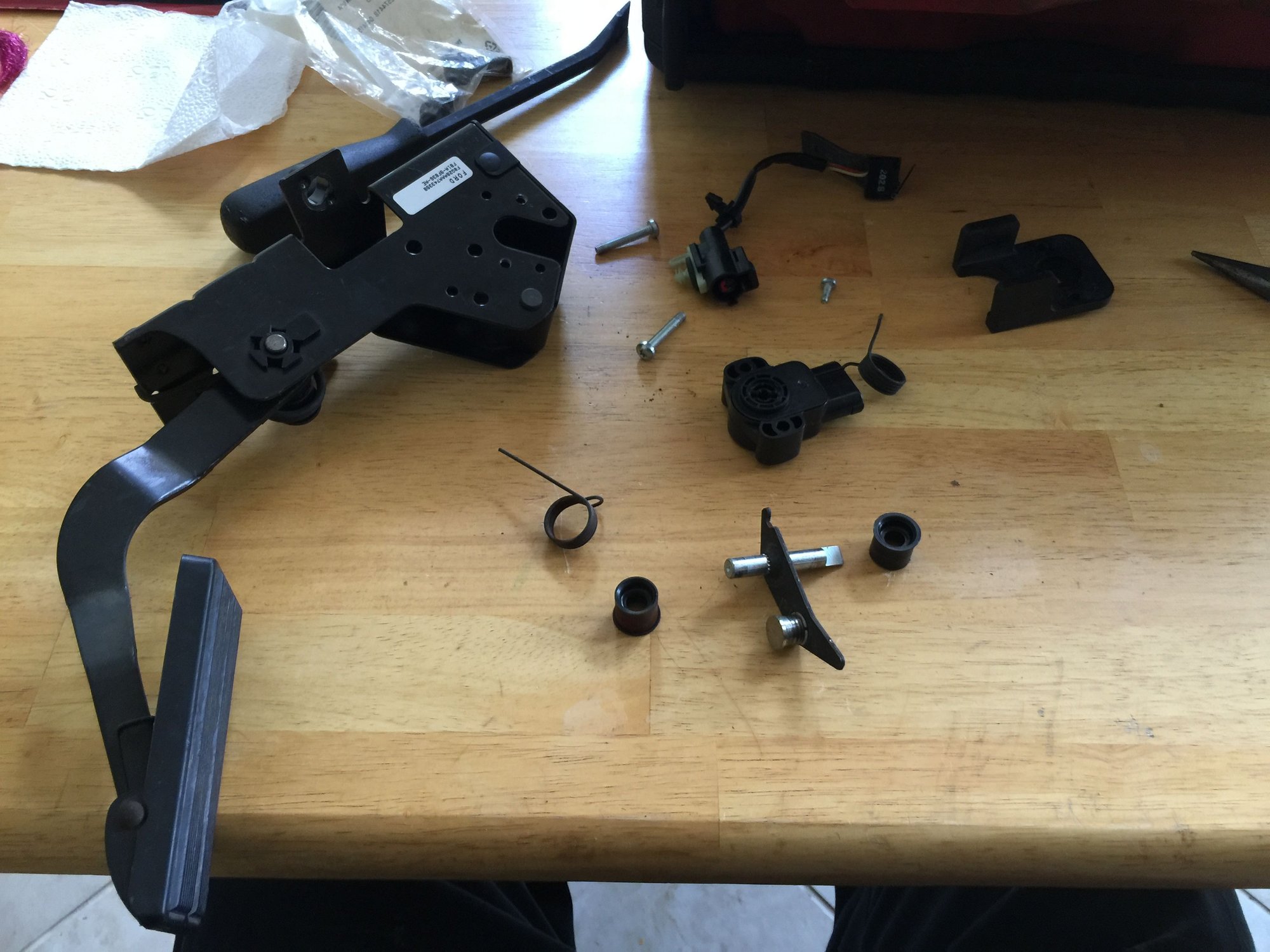

Once you pick up all the pieces, which entails FINDING THE SONS OF BITCHES after they launch across your open concept living/kitchen/dining area, you should have the following mini sons of bitches:
Now, make them look like this:
You may be thinking, 'Hey Matt... You're missing some key assembly pictures here...' Yes, yes I am. For if you do not heed this warning, and you disassemble your throttle pedal assembly on a 2001 Excursion without proper training in the dark magical arts of retaining springs, re-winding about 15 feet of coiled metallic strip spring (DO NOT EVEN ASK), and wizarding up three other hands that have the ability to defy the space/time continuum and occupy the same space at the same time without interfering with one another, YOU DESERVE TO FIGURE OUT HOW IT ****ING GOES BACK TOGETHER YOURSELF YOU FOOL!

Silver lining then! It's nice that some good could come out of that terrible monstrosity. The only reason I found one of the return springs hiding under the fireplace is because the dog was rooting around sniffing at something. That little skank monger flew a solid 20 feet through the kitchen, over the couch, and across the damn living room.
I have yet to reveal the scratches on the kitchen table to the wife figure. I fear it may be my undoing, much like that tightly could metallic strip sling inside the TPS module. The one that I debated taking apart while on the phone with @Stewart_H... Yep, Stewart old buddy... I took it apart. I have NEVER seen something escape from its hellish realm with such fury before. The only thing that comes close is Killary's soul once it attempted to return home to the dark wench's cavernous gaping cursed Neverland. The One Upon A Time TV series version.
Yeay, as I tinker through the chasm of throttle pedal assemblies not available as separate entities, dost a crinkling reminiscent of tin cry break forth through the muttered swear words and curses upon engineers' collective mothers. And behold! A glinting savior doth catapult skyward, freed from its captive dwelling wherest it hath spent over a decade stuffed into a dark abyss, contorted around itself, yearning to be free, pining to stretch forth its, uh, solitary limb... The tool operator shouteth forth, "Holy ****ing **** what the **** are you doing!?" as it spirals and whips towards the first glimpse of light and freedom it hath beholden in years!
NEVER. AGAIN.
