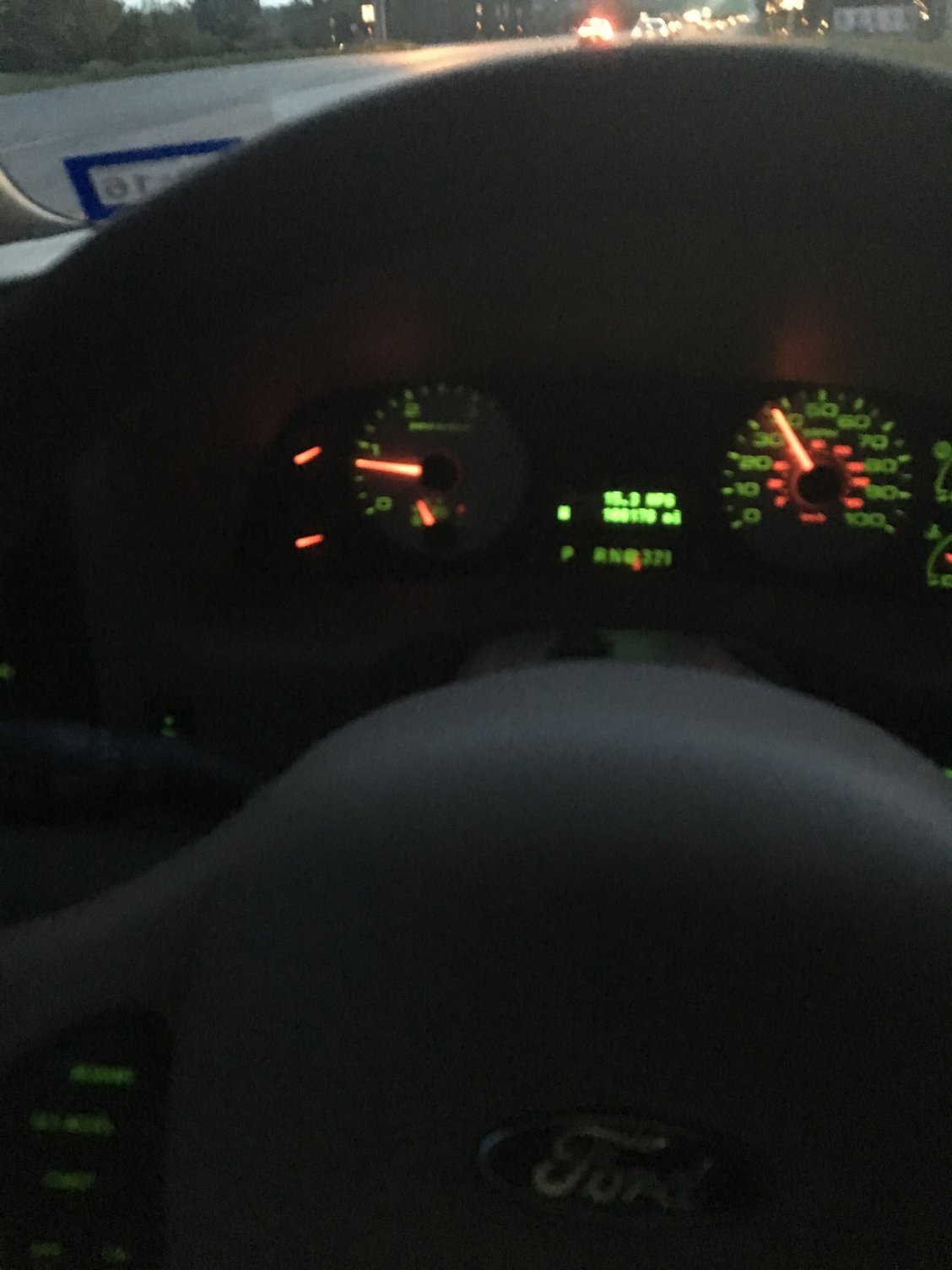

My 06 instrument cluster has a few bulbs that are out. I have seen the video on how to remove and send off to be repaired but have not seen any thing on how to replace bulbs. Is this something that I can do myself? Is there "kit" to replace all the bulbs? Where can I get the bulbs? Any info would be greatly appreciated. Here is a pic of my panel.

I'm not sure about your particular truck but most ford use 194 bulbs inn the cluster and in the dome lights. You can get led bulbs for a replacement and they last longer and are brighter. Look much better in my opinion.

Yes the bulbs are held in plastic holders that quarter turn into the back of the cluster. It takes longer to remove the cluster than to change the bulbs. Check out superbrightleds.com for the bulbs for your entire truck.

Just wanted to give an update on my lighting issue. For me this was not a very easy job. I guess in theory it is and if you have done it a couple of times its an easy job. I ordered the bulbs from superbrightleds and when they arrived I removed the panel and very carefully started to twist the wedge/bulbs out. This was not an easy twist and release process. It was twist, wiggle and twist until I found the sweet spot and then it would come out. To replace bulb in the panel was the same process in reverse and it seemed to require more force to get the wedge/bulb back in, which made me nervous. When I replaced the panel and turned on the lights the new bulbs I replaced were on but now a few others were out. Darn it! So I removed again. In the process of removing the other bulbs/wedge I damaged one of the wedges and could not find a replacement locally. Darn it! After calling superbrightleds and found out they did not have what I needed I gave up. I found a local guy that did that kind of work and for less than 100.00 got it all taken care of.
