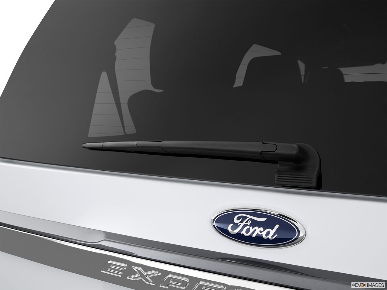

One quick thing to check is the rear wiper. They can get gunked up and stick, then continue to try to find the home position after the vehicle is off. You can try pulling the fuse for that and see if the drain still occurs.

Thanks for the response and link to thread.
To clarify, if I am standing behind the vehicle and looking towards the rear is the "left" home position relative from this view? Or looking to the back of the vehicle from the front?

correct, the wiper should rest to the left when standing behind the vehicle

The wiper issue is better diagnosed by pulling the fuse and seeing if the battery still drains, in a lot of cases you can't really tell if it is the culprit by looking at where it is parked, it appears to be in the proper place, it is the motor that doesn't realize that and keeps trying to park it. In that thread that was linked above he had it easy - the wiper was screaming "it's me, I did it". And as is usually the case, the OP never comes back to share the fix and help others.
