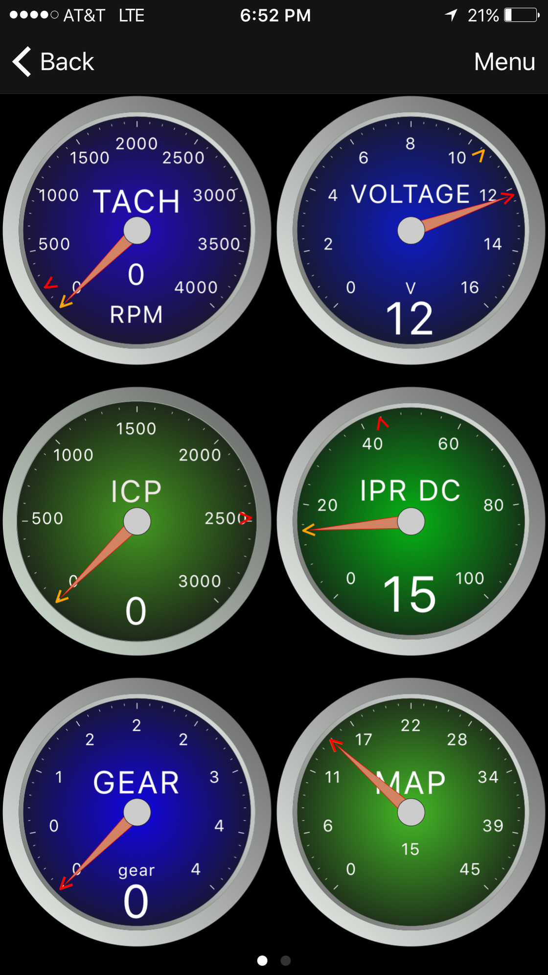

New set of readings after unplugging ICP and cranking. Red arrows note maximums while cranking.

When you unplugged the ICP sensor, the PCM displays default (theoretical) readings. That low ICP while cranking is your culprit, and needs to be addressed. A bad IPR won't allow the ICP to climb - ICP sensor plugged in or not. I'm not saying you flat-out have a bad IPR, but you either have a bad IPR, low oil level, internal oil leaks, or a bad HPOP is preventing ICP build-up.
But his ICP hit 2500 while cranking (the red arrow shows max seen)?
Edit: ignore what I said, I see what you were getting at now
I did install a new IPR based on the finding that the nut had backed off (tried tightening with no start). The old one was without a doubt original and really nasty looking. New IPR does show different duty cycle readings and slight oy different ICP readings but still under 100 psi cranking and spikes to 200ish when I let go of the key. Unplugged ICP with new IPR defaults to 2500 psi... I thought it was supposed to default to more like 750 but ?? Regardless, no start either way. No external leaks that i see from lines/fittings etc. just weird to me that a leak would be so wishy-washy like this and that the truck was still running as smooth and powerful as it was right up til it quit on me. I'm gonna do a buzz test just because I don't want to believe the ICP readings and then the valve covers come off to look for leaks.. It's gonna suck badly on this van to get those bad boys off.
