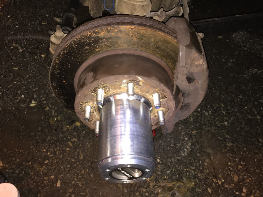

They do. The needle bearings in the front U-joints on my '07 Dodge Ram were turned to dust with just 80k miles on the truck. As you said, they are turning 100% of the time, and this increases wear over one that only turns when 4WD is engaged.
Also, most Dodge guys report around 1mpg gain when they install a free-spin kit (manual hub conversion that also ditches unit bearings). Steering is much lighter as well. I did the conversion on mine
Attachment 278002

I found the difference in my Ford with manual locking hubs to be about 1mpg locked vs unlocked. Late model RAM are using a center axle disconnect again, but the axle joints are still turning. Clearly the use of the CAD is to try to improve fuel economy. If it didn't help, why bother?

That's not uncommon for the U joints with 80K to do that, especially if you live in the rust belt or go through deep water often, it doesn't matter if you have locking hubs or not. In fact if you leave your hubs unlocked and don't use 4x4 often it can cause your u-joints to seize up. I hand calculate my fuel mileage on every fill up its never made a differnce.
