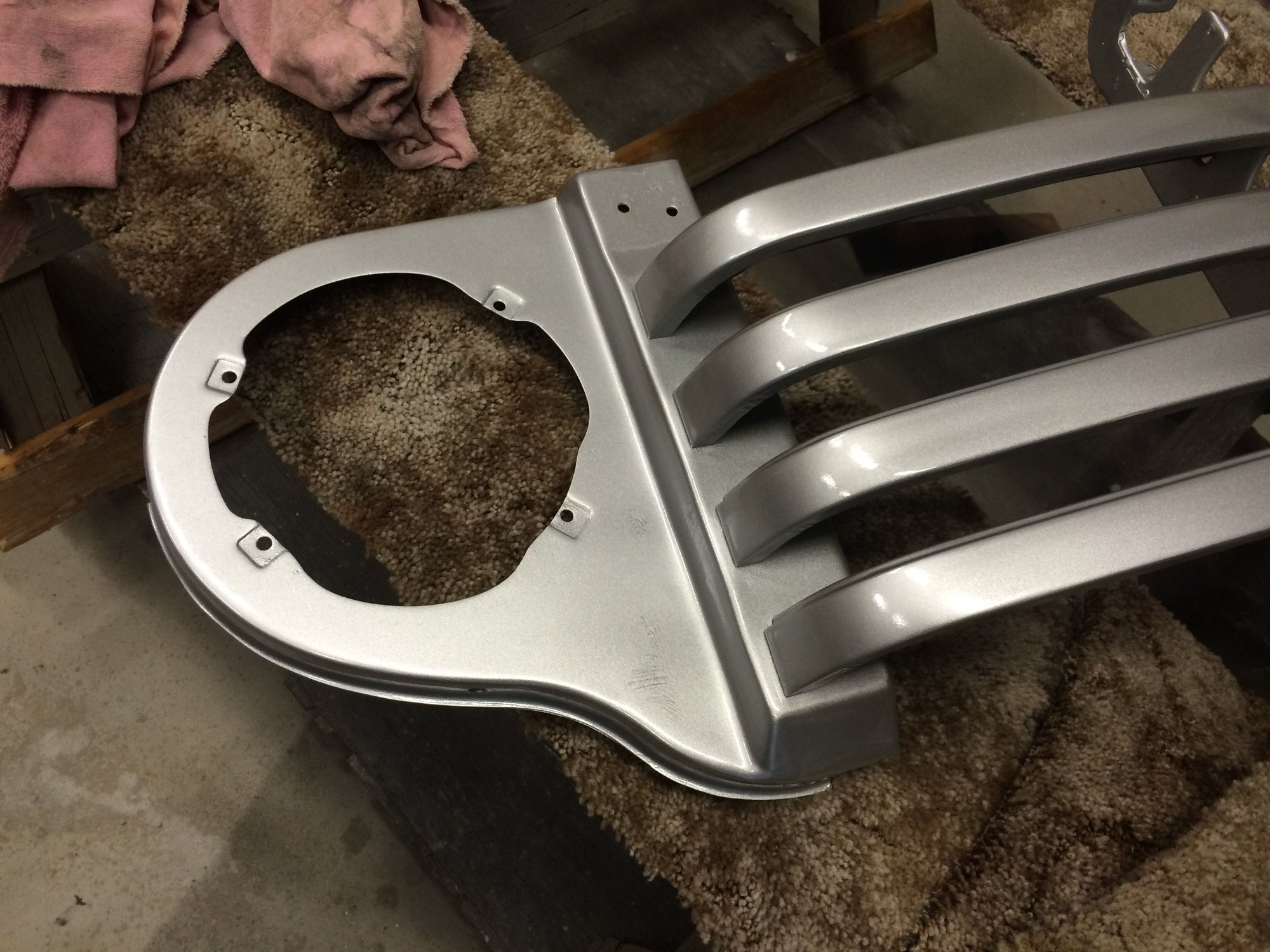

I'll post a pic later but it's my grill a 49 to hard for me to paint my painter is down the road I can get him back but I'd like to fix it myself

So here's my problem scratched the base he uses a tack cloth to remove a nib or bug on the base
