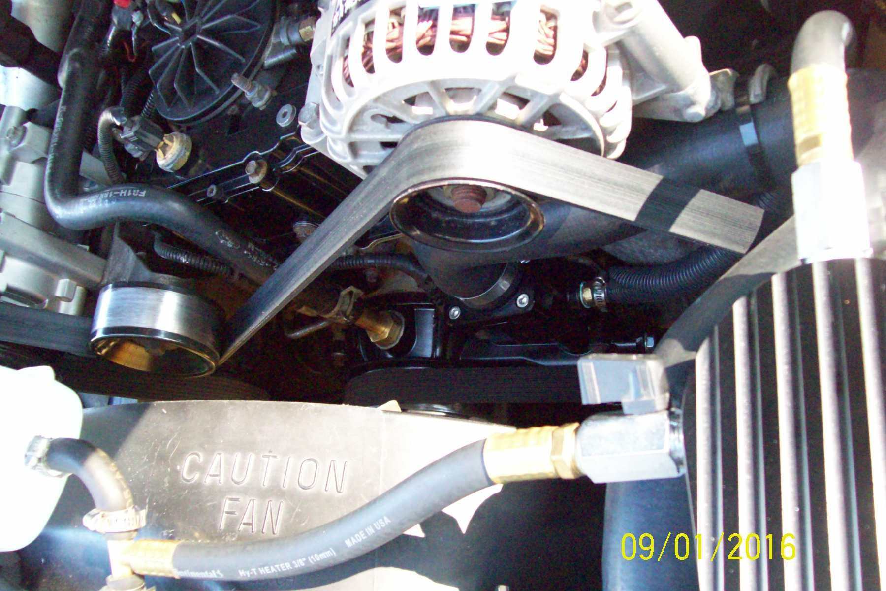

I was NOT going to pull the radiator until I seen this............

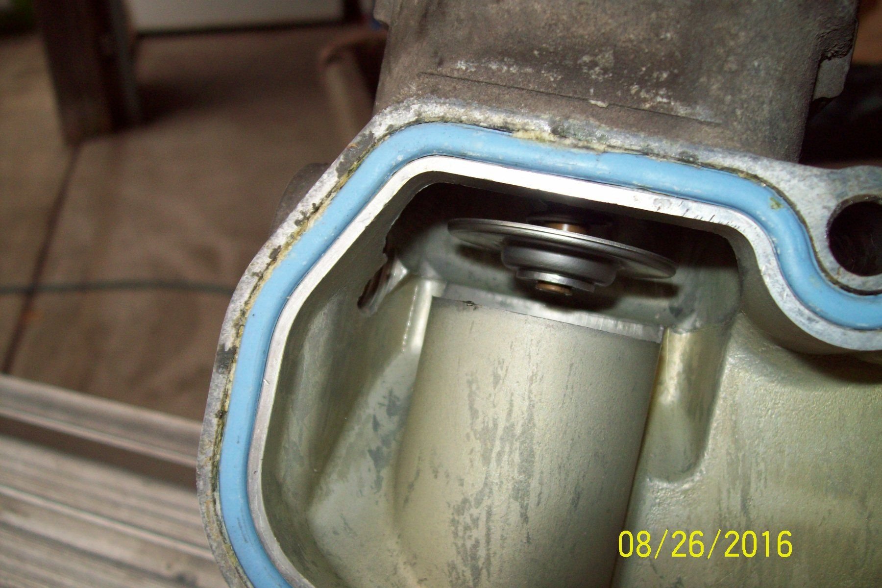

I think this was the factory water pump and it made it until 230k. So I am going to guess the blue gasket is a IH part. if you look at the housing you can see where the impeller was grinding the housing !
When I took the belt off I could move the water pump shaft up and down at least a 1/4" inch.

As you can see in this photo there was corrosion starting to get around the gasket. So after cleaning the area the gasket sits on both water pump and front cover I used Evinrude/ Johnson Gasket Sealing Compound #508235 to impede corrosion . I use it all the time when working on boats....

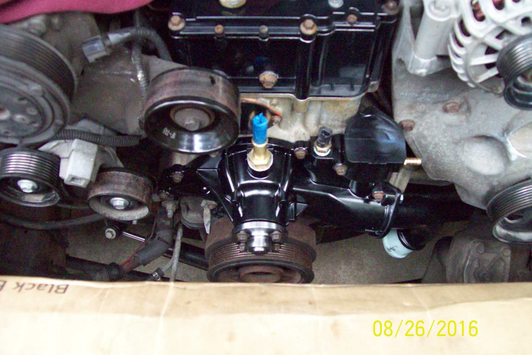

Pump painted and installed
I have to say the RR billet thermostat housing with shipping cost almost as much as the water pump. But it was well worth it not only does it do the job but it looks good doing it. It goes well with all the other black parts.

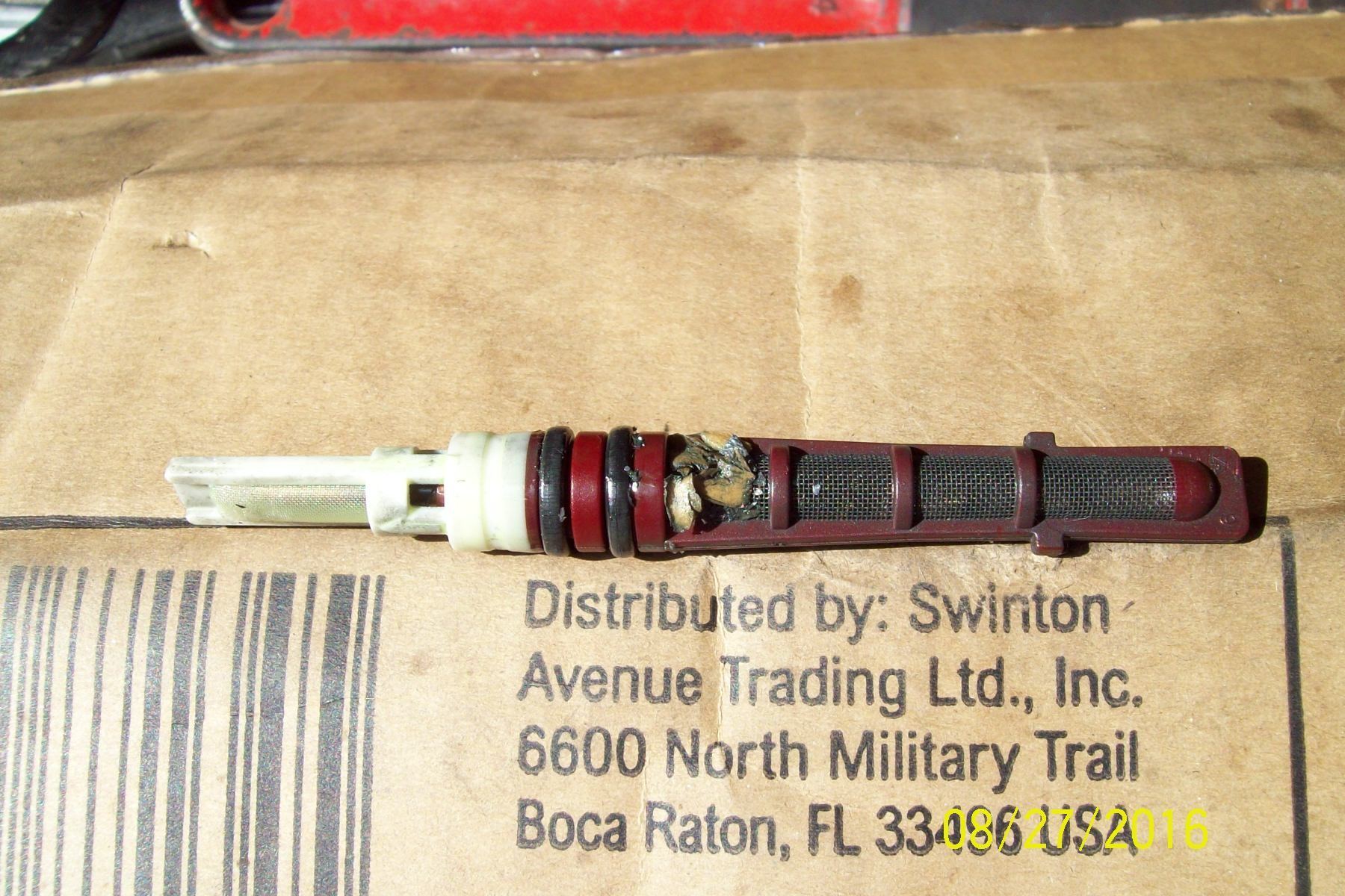

The problem I was having with the A/C was it would blow COLD around town but on the highway it blew warm. I thought to myself I'll bet the expansion valve is dirty and compressor was weak.
Well I have never seen such a nasty expansion valve and the size and types of crap that was in it amazes me it worked at All. A/C had 230k on the compressor so I'm lucky it didn't just lock up !!

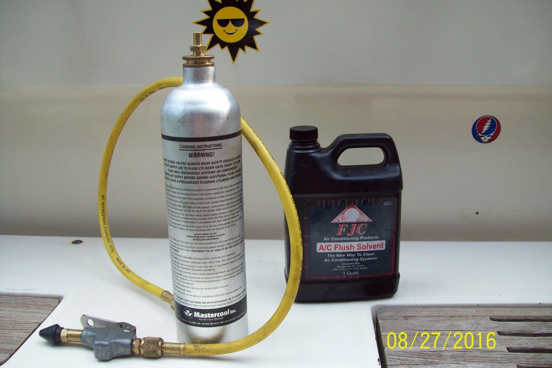

Here is what I use to flush the A/C with

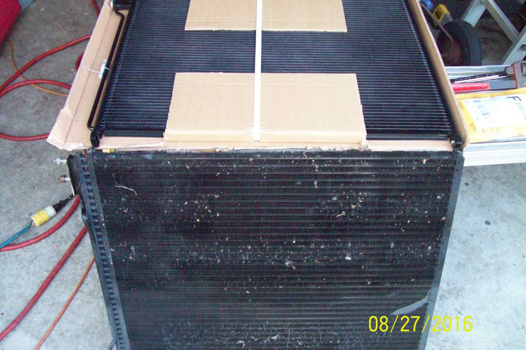

Now on the new condenser it is made in China and not as good a design as the oem. The oem has 2 rows with big tubes and the aftermarket one is a tube header with one thin row across. This is one of them parts it would pay to buy oem.

Order a new condenser from a Ford dealer and you'll get one exactly like the one you got. The one from Ford comes with an updated refrigerant charge amount sticker; the charge weight was reduced with the new condenser design.
That is interesting... so if Ford changed the design maybe the one I got is actually a better design. Do you recall how much the new refrigerant charge was? Do you have a photo of it or part #? The sticker on my truck says 2lbs 8oz so / total 40ozs and 9 ozs of oil. That is exactly what I put in mine give or take a ounce of feon.

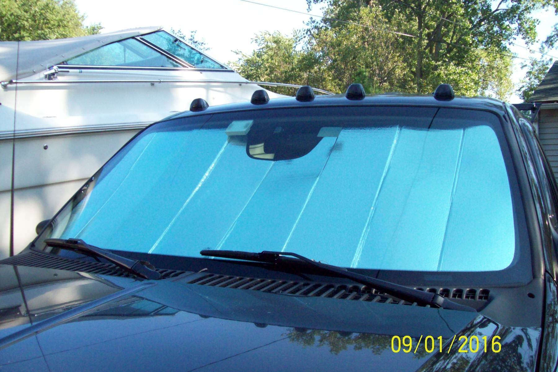

I have been driving the truck for a couple days now and it is nice to have the A/C working correctly. Now on the subject of cooling the cab I had also insulated the roof with X Mat #15825 from Eastwood and used aluminum tape you use on household duct work to tape up all holes in the roof frame. Also added some sound deadening pads to the front doors which also helps keep the heat out. Still need to do the back doors and rear of cab.
I had some cheap windshield covers that really didn't do much good. So I bought one that is cut to fit our trucks and is a 7 layers, down side is it cost about $40. This one actually helps keep the cab cooler when you are parked!

Where did you get the sun shade? I have been looking for one but those that I have seen fit like socks on a rooster
That is too funny..just the thought of trying to put socks on a rooster. LOL
The only thing I didn't care for was the opening for the mirror is huge but other then that it is cut to fit our windshield.
Here is a link for:
http://www.ebay.com/itm/331854530992?_trksid=p2057872.m2749.l2649&var=540931696560&ssPageName=STRK%3AMEBIDX%3AIT
