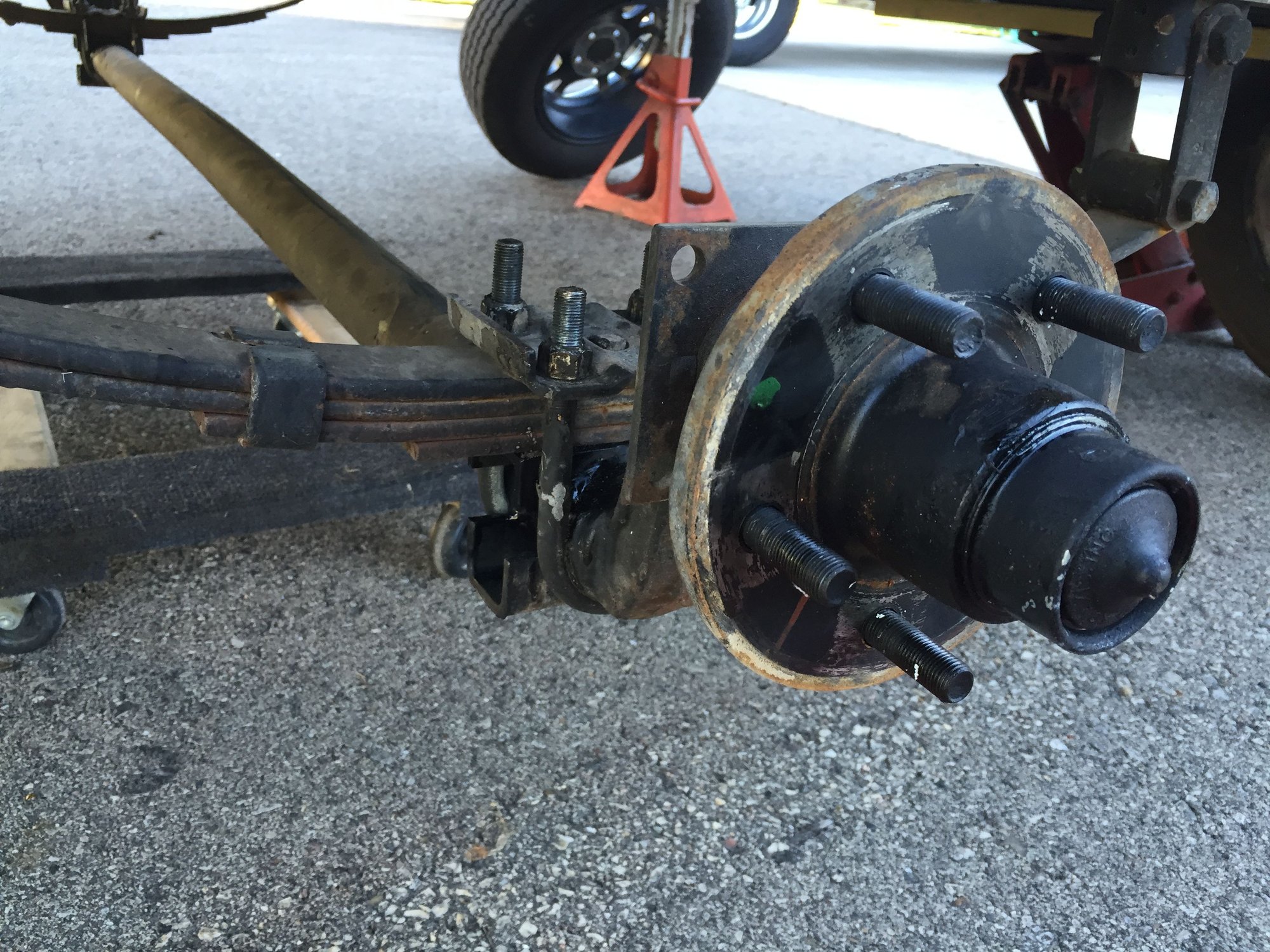

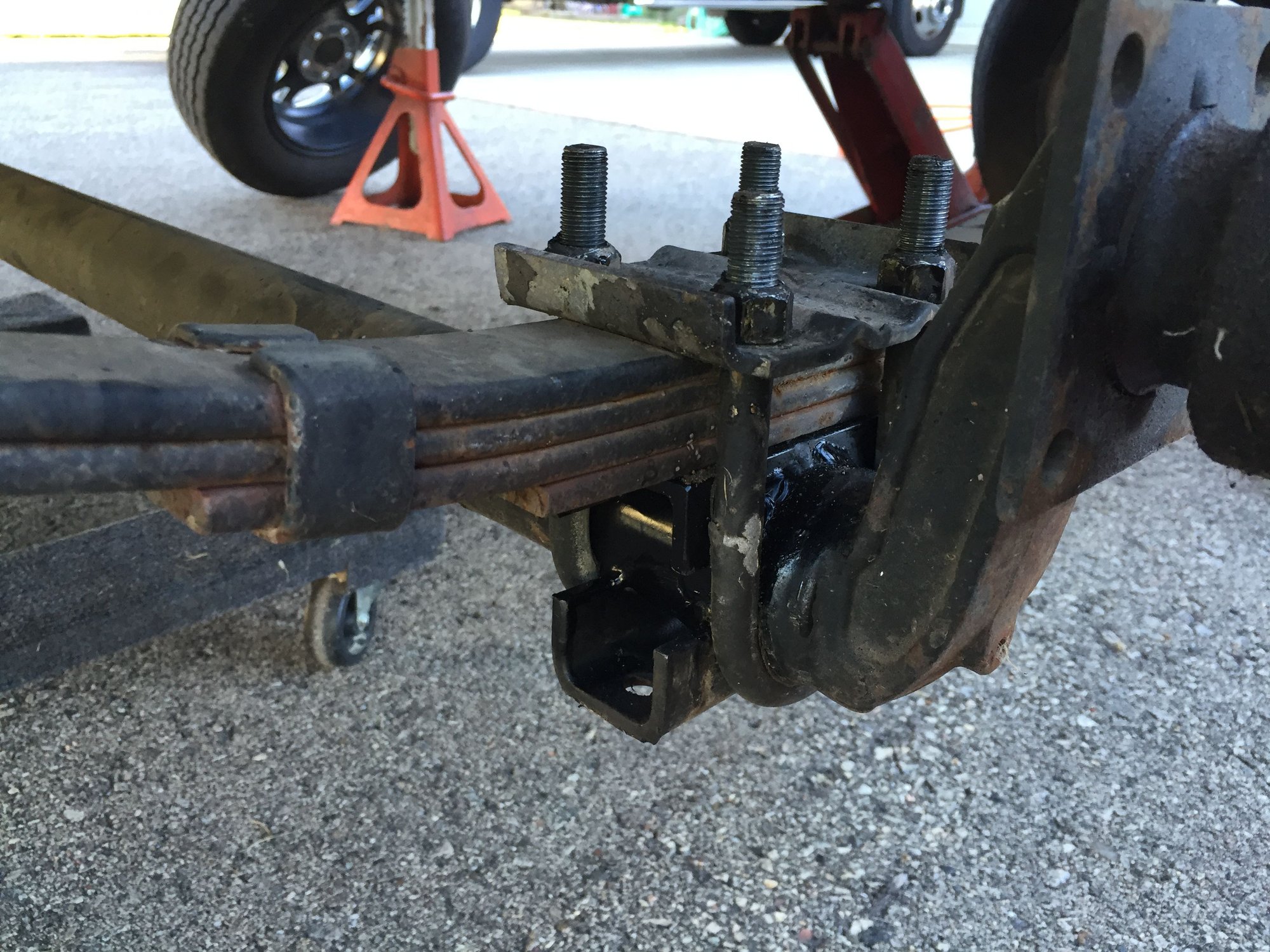

Got the trailer axle done.. Also serviced the bearings... Thinking about putting brakes on this thing. 3500# is a pretty good push behind the Rubicon and I think my TJ would have its hands full very early on...
nice work Randy. Did the springs go under the axle so you welded a spring perch on top of the axle? Were the wheels rubbing the fenders hitting bumps with it loaded?

Correct on the springs and welding a new perch on top of the axles since it is a drop axle and you can't flip those.
There were some dents in the bottom of the aluminum diamond plate where the axles had impacted at some point.
Couple more pics --
