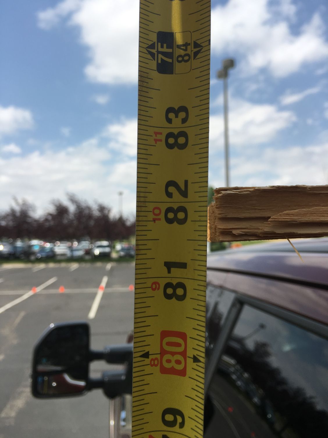

The 85" thing is extremely unlikely. Without some sort of board laying across the peak of the cab, just eyeballing it leaves a ton of room for error. I'd wager it's 81.5".
I'll take that bet. I didn't try to read the tape at the highest point in the center of the cab. I was just trying to read it at the corner where it slopes down. Granted I couldn't look at it dead on as I'm only 73", maybe 74" with boots on, but I'll bet I'm not off by more than an inch.

Ford's specifications state that the 2017 Super Duty crew cab is 81.5" tall in the 4x4 configuration. For 2016, the height was 79.7" for the F-250 and 80.8" for the F-350 SRW.
What I read on the Ford site said, "depending on options" or something along those lines. I've asked 3 dealers and emailed Ford what options made it so tall. So far I got nothing.

The "standard" tire option would be 18" AS tires so the 20" AT would make it sit up 1" taller at 82.5". Heavy suspension package would probably lift the front up and make it set more level but not higher overall. Any other added options should add weight and if anything make it sit lower.
When Josh took the first pix with a tape it was really high- I don't remember the measurement but when a stick was laid across it, it measured 81.5" and I don't remember if that truck had 20"s or not.

Agreed. Negative on the 85". Josh measured a SRW 350 with 20's at 81.5".
https://www.ford-trucks.com/forums/r...php?p=16456915
