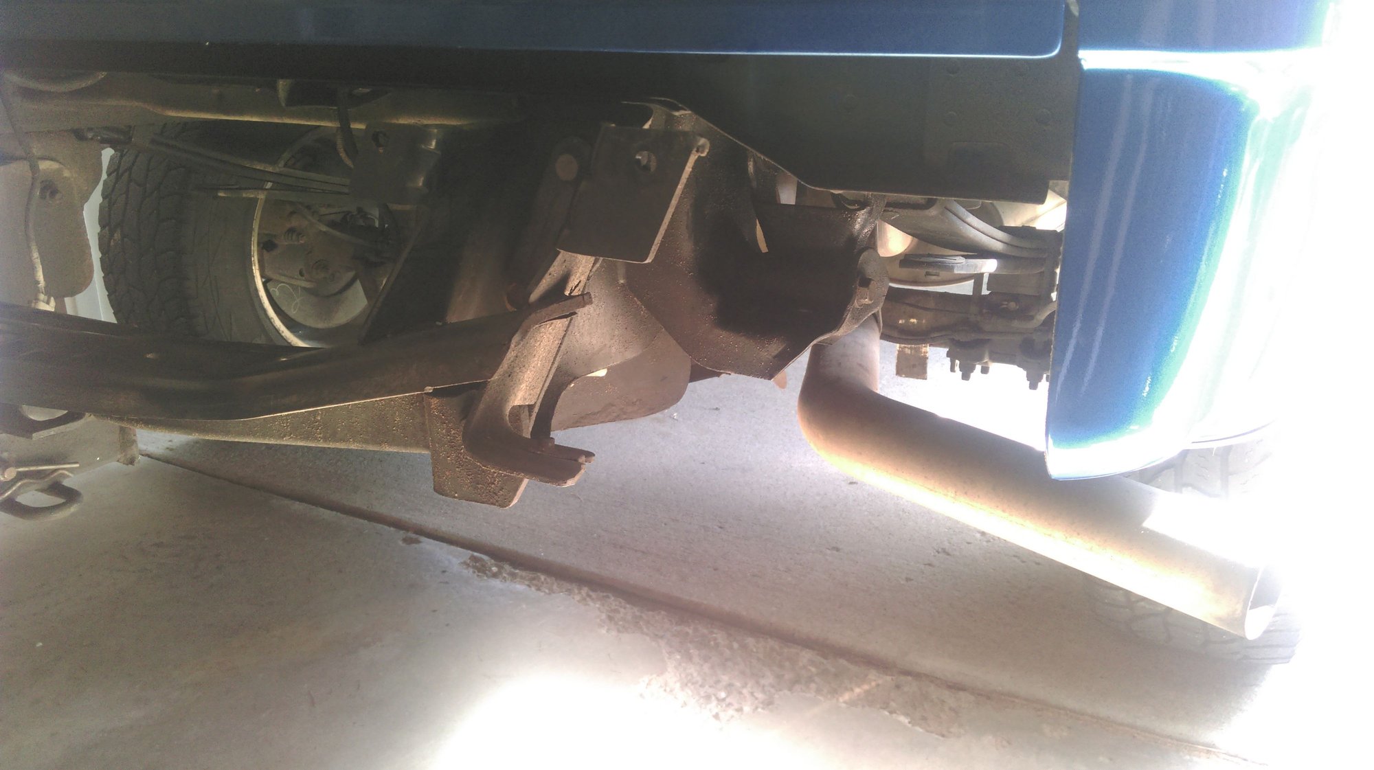

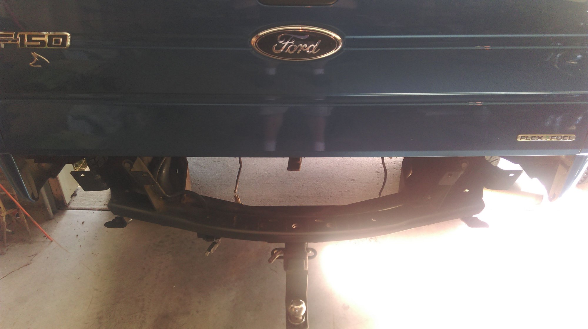

Pulled my rear bumper to touch up some scratches on the lower rockers caused by excessive flexing... Found that the sides of the bumper are completely totally unsupported! Is this typical or am I so how missing some of my bumper supports?
In these pictures, the only thing removed is the black plastic step/cover and of course the chrome bumpers (left and right). Those came off with just three 13mm bolts.

Unfortunately that's the way these bumpers are made on our trucks. It's another form of light weighting in the name of fuel mileage. Keep in mind that bumpers today are also only required to sustain a 2.5 mile per hour bump with out significant damage to the rest of the vehicle. This in turn gives a whole new meaning to "light duty" bumpers.

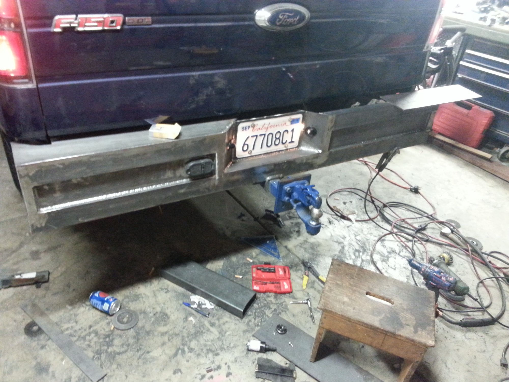

The rear bumpers on these trucks are of harbor freight quality standards. I tore my rear bumper off after catching a t post. Made my own replacement from 5/16 flat and channel stock I had. Never had a single issue. Below you can see the oem bumper and how mangled it got. I also discovered faulty welds on th
e hitch receiver and stress cracking so I had to make a new one while I did the bumper.

Now that is a stout looking rear bumper. And I bet it would look awesome in chrome. Have you noticed a decrease in mpg's since you installed that bumper?
Not that I have noticed. The bumper has been moved to a different truck and both trucks are right around 13mpg combined average. Plus the front bumper and all the other heavy steel like the steps, skid plates and the headache rack probably all take away more mpg than the rear bumper combined lol.
