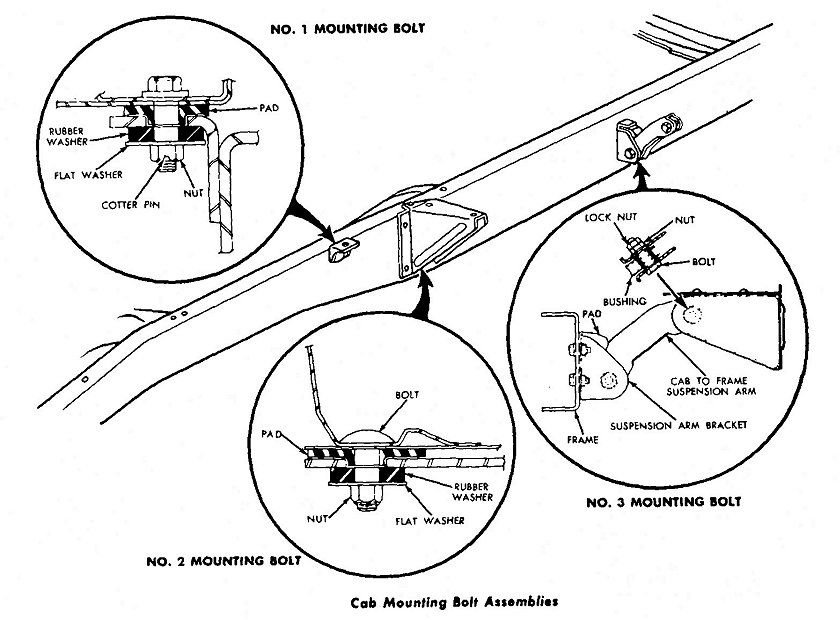

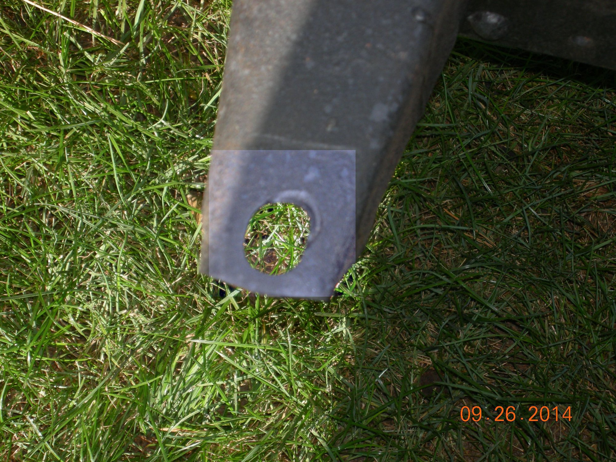

Sorry to repeat this again for those of you who regularly read new posts. Don't forget that the cab body mounts play a big part in the way that a hood fits. The hood is so long and very dependent upon a square mounting to the frame as the front end attaches to the radiator mount which attaches to the frame. The hood also needs to be square to the cowl. In addition to the mounts being worn you should also check the front cab mounting holes to see if they are wallowed out as mine were.
Failure to correct any issues with the mounts will result in the hood fitting somewhat OK after you adjust it but then closing efforts and fit go to "poop" every time you drive it or even just jack it up to change a tire.
