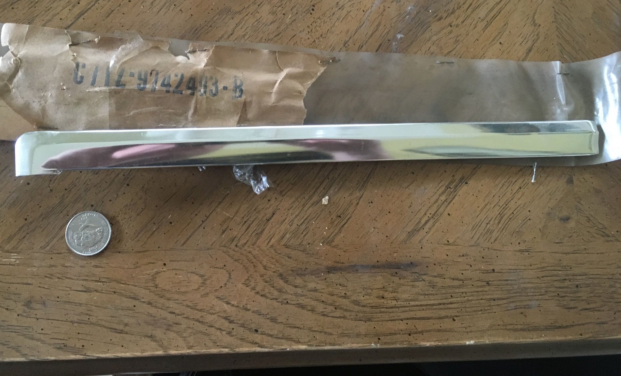

Anyone recognize this trim piece?
It's not the windshield one.
It's aluminum.
C7tz-9742493-b

Doesn't look like a truck piece... maybe Econoline?

c7tz-9742493-b comes up as 67 F100 windshield molding , even some on Ebay that look same as your Pic

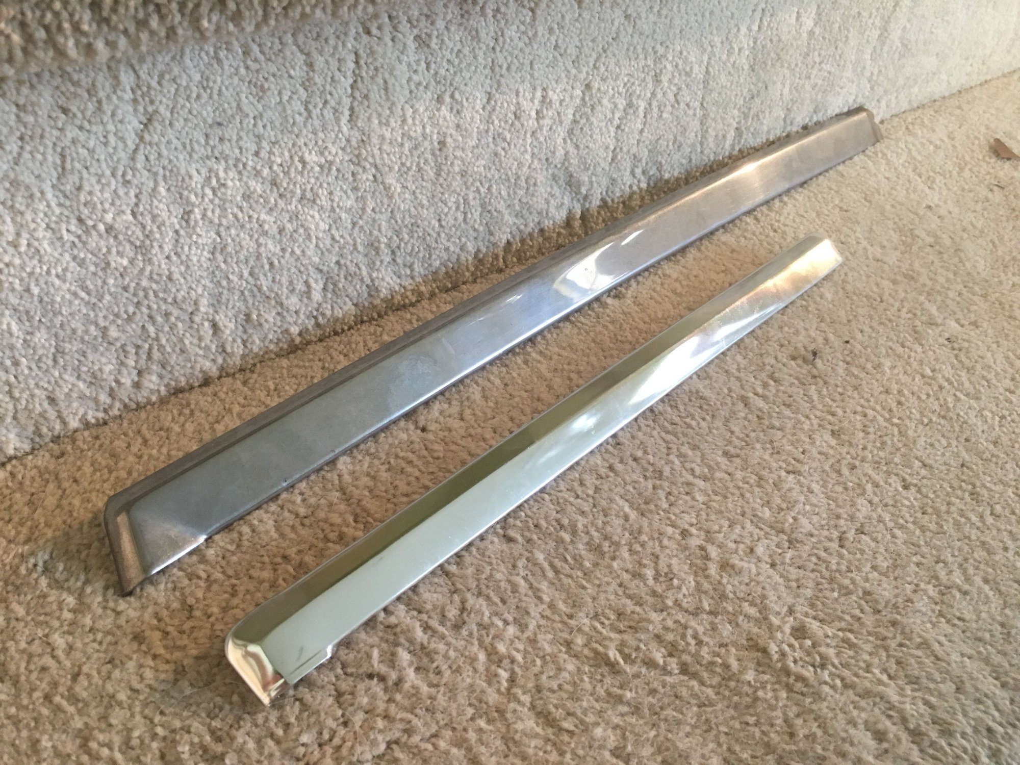

You can see how small it is compared to the windshield piece it was to replace.
That's the one I bought. I think someone stuck this into the wrong package. It's definitely not the windshield one.

The 1st two numbers after the prefix in a Body Number designate the body style of vehicle that it's for. You can say Ford added the body style to the front of the basic number. Body style 97 was the 1/2 roof "Sport Car" model of baby Bronco. The one that looked like pickup.

Copy that thanks! So it's the trim for a half cab bronco.

Copy that thanks! So it's the trim for a half cab bronco. Back window im guessing. Haha.
Yepper. The left vertical piece for the rear window.

Post 1967/77 Bronco.
It's aluminum. C7TZ-9742493-B
C7TZ-9742493-B .. Moulding-Back Window Outside Left Side
1967/77 Bronco Body Styles 97 (Utility-Half Cab) & 98 (Wagon).
The package is correct. The thing is, the seller (on ebay?) noticed the C7TZ prefix, figured it was for a '67 pickup.
Not all that long ago, a clueless ebay seller listed this: C6TZ-18813-A .. Antenna Kit .. said it was for a 1966 F100. Uh huh: 1966/77 BRONCO!
Shown as 42493 in pic:
