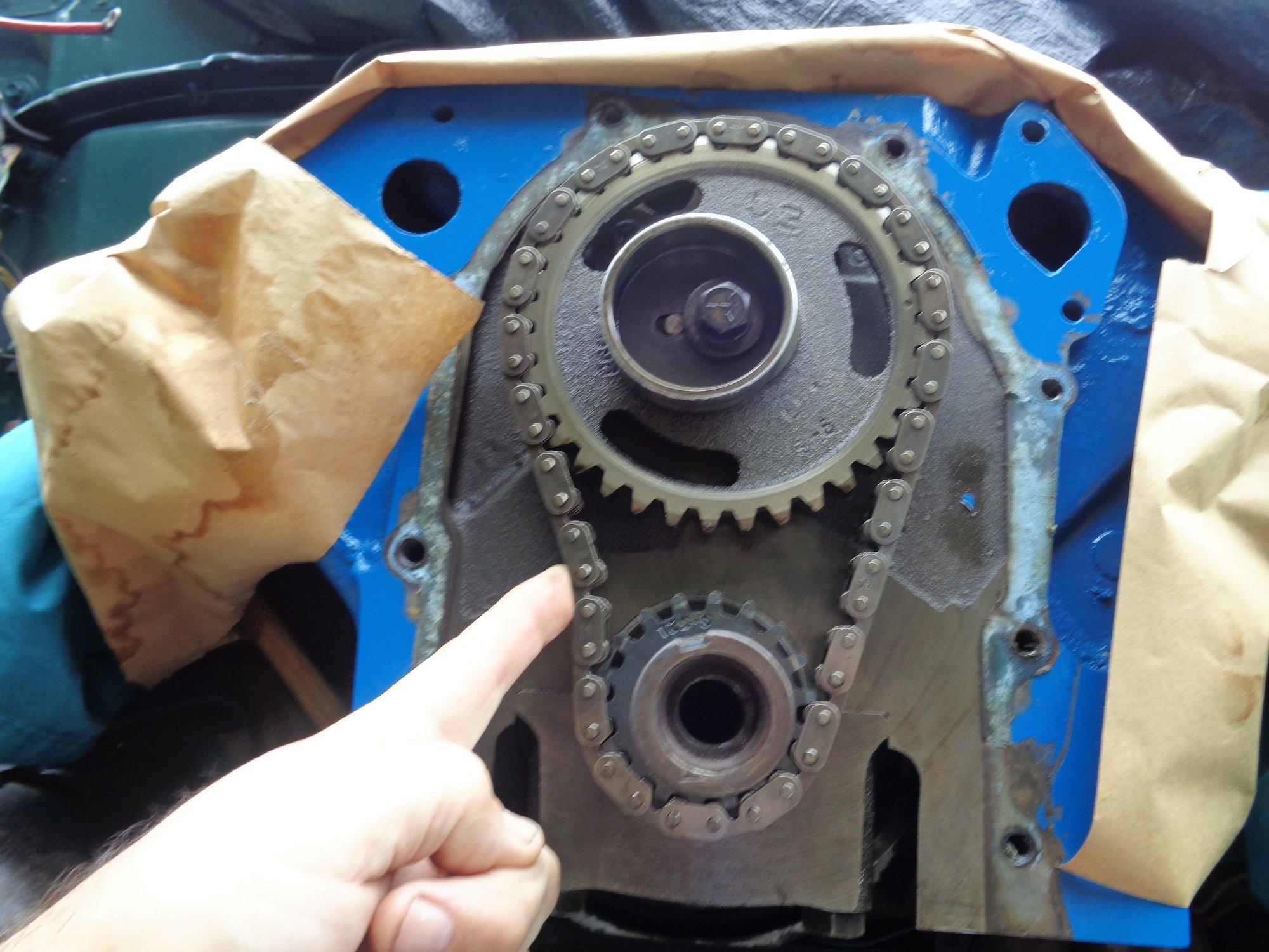

Everyone chime in with their opinion.
Sealed Power, EngineTech or Cloyes.
All about the same price.
I am definitely changing them.
A little slack

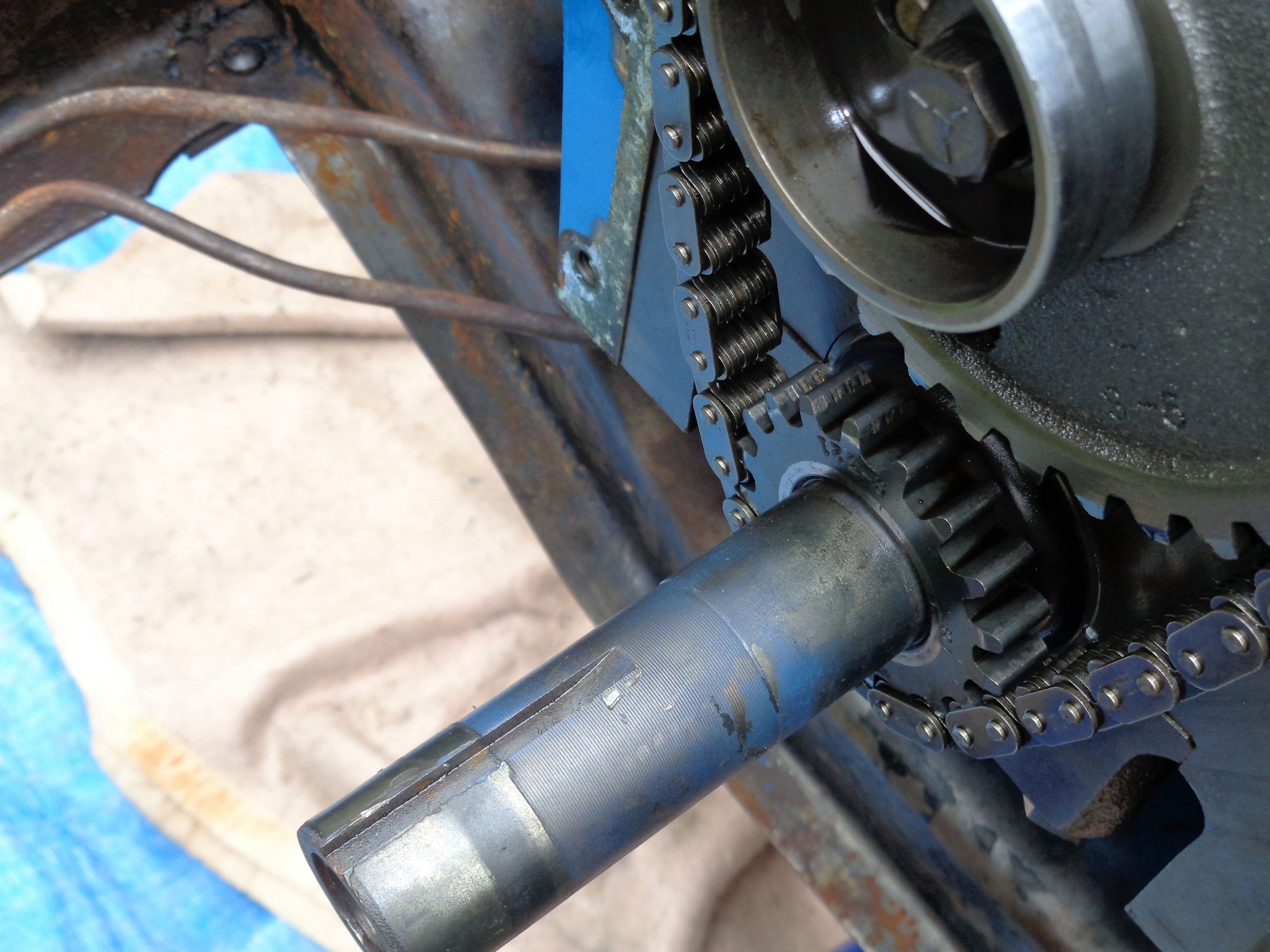

Some pretty significant wear marks on the crank gear
Also, Timing cover seal:
Timken, Duralast, or Victor Reinz
Same deal on the pricing.

Everybody prolly has a cheap version and a "better" version. I always go with the Cloyes better version. You get what you pay for. Things may have changed since then but I remember prolly about 2006 Some magazine or company did a comparison on All the name brand timing chain sets. Cloyes came out on top. Most of the sets had timing marks not stamped exactly right. One was off by 4 degrees!
Buy a good set.....Made In U.S.A.

Wouldn't I want to put on the new set as close to where these are as possible with #1 @ TDC?
If not, then why?

I only have a single keyway?
Are there cranks with multiple keyways or is this an adjustment feature?
This ain't no hot rod engine. It was/ is just a strong workhorse.
I don't want to put hi pro stuff in her. Just replace what she has with same quality. Maybe a little better.

You can get a thin metal sleeve to slide over the end of that crankshaft. takes care of that groove.
Sorry Early, you lost me here. Groove where?
I kinda need the groove in the crank for my keyway. I'm asking about the timing sets that have multiple keyway slots in the crank gear. 3,9 etc..,
My crank only has the single groove ( one keyway ) so are the multiple slots in the crank gear for more adjustability or are there cranks out there with multi keyways?
Old Aug 28, 2016 | 06:01 PM
KsHighboy's Avatar
KsHighboy
Joined: Apr 2006
Posts: 323
Crank will just have one key slot. The bottom timing gear will have 1, 3, or 9 depending on which set you bought. You adjust the the cam timing by setting the bottom gear up or back depending on if you want advance or retard your cam. Or set it up dot to dot for 0*.
