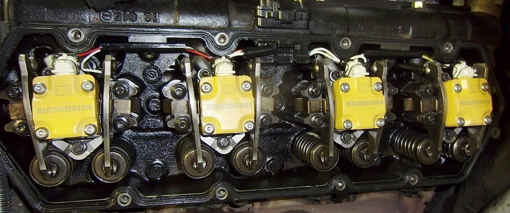

No debris, they said it must have disintegrated and gone through the exhaust. Checked the turbo blades and found no damage. Here's a pic of the injector.
Picked it up today, so far so good. Glad this was it.
