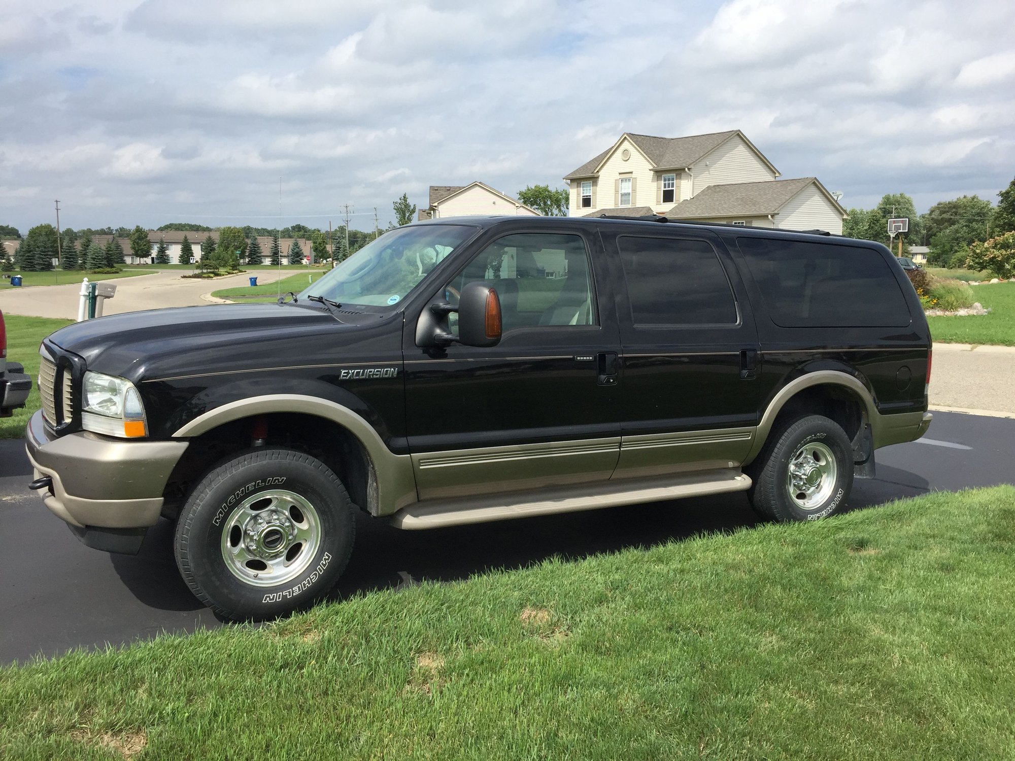

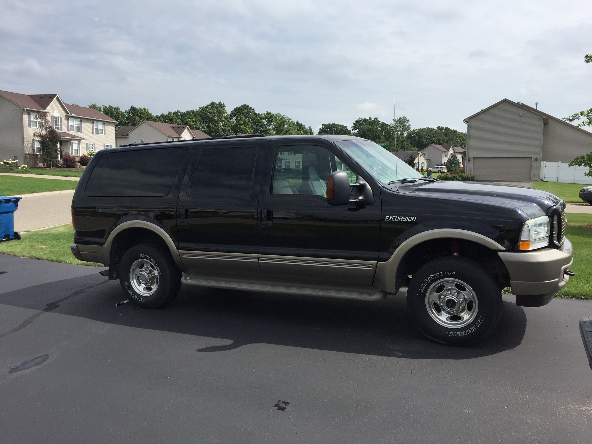

Hi guys, I just bought an 04 excursion Eddie Bauer and I'm pretty pumped about it. All stock. I'm going to do a leveling kit and tires/wheels. Just wondered if someone could point me to a thread with pics of different combos of lift and tire size. I'm sure it's been covered before! I'm thinking 2 inches in the front with 33's on 18's. Thanks!

As was mentioned there is a ton of information out there. IMO your best order is 1) Get the front end in like new shape, 2) Check the links on the front sway bar and add a rear one, and then 3) replace the springs with proper F250/350 springs. The first item is something that can kill you, even if low mileage is worn out by now, and for some reason is ignored by new owners. Item two prevents the very common post of "I have a knocking somewhere and can't find where it is coming from" as well as adds a noticeable improvement in cornering and rough road ride. The third item is because the springs were marginal when brand new. By now they are worn and will likely give you the lift you are looking for.
I couldn't tell from the picture whether you have 4WD. If so with new springs and the proper offset on your rims they should work. I am running 34" in a stock but with new springs setup. In full deflection the tires rubbed against the rear splash guard but all I had to do was tie it back an inch.
