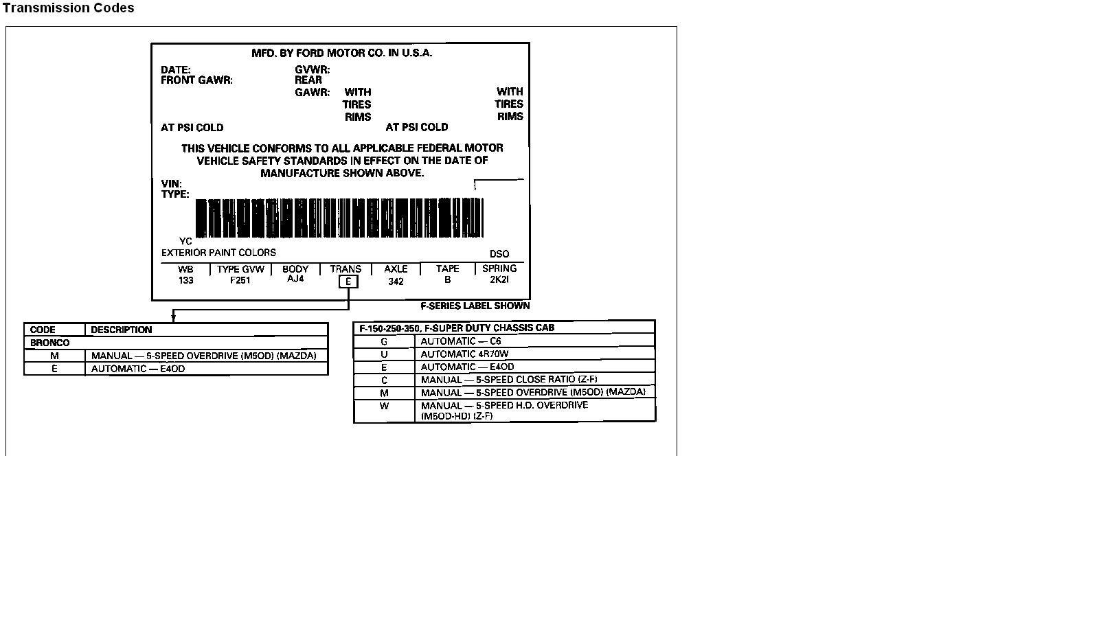

One other thing.....make sure your truck has an E4OD. Check the sticker on the driver side door jamb. Look for the Trans Code.
Example:
Transmission Codes:
