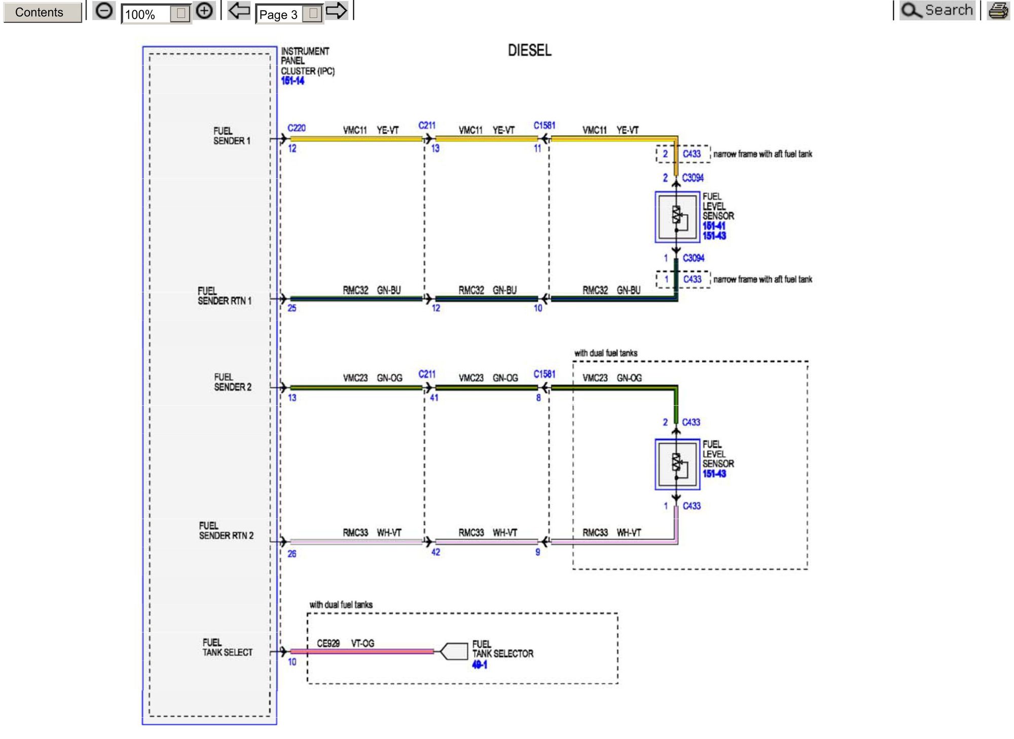

Working on a 2015 f-550 with a 6.7 power stroke. Damaged the wireing harness and fuel gauge not working now. Where could I find a wireing diagram? The low fuel is now causing it to not regen. We have continuity through the wires and they have been repaired but gauge still does not work. Currently now power to fuel gauge sender? Ideas?

Hope this helps
