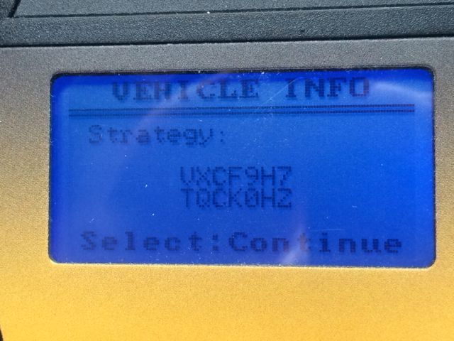

This is the base strategy in my 2006 F350
Base strategy in my 2006 F350
What would give the best overall performance for MPG and turbo spool time?
I understand if I do change the base strategy I will have to have Matt
rewrite my tune. I find that I like the 8K tow tune in the winter and the SRL
in the summer because I can't keep my foot out of it at times.
EDIT :
Just got off the phone with Gearhead.
One thing I do want to toss into the mix at some point soon is the Atlas 40.
Also in talking to the people at Gearhead they say that other than a little smoke
the 40 will work just fine for me. They also told me that the strategy I have
right now is a good place to build from.
So I am just looking for some info right now.
Thanks
