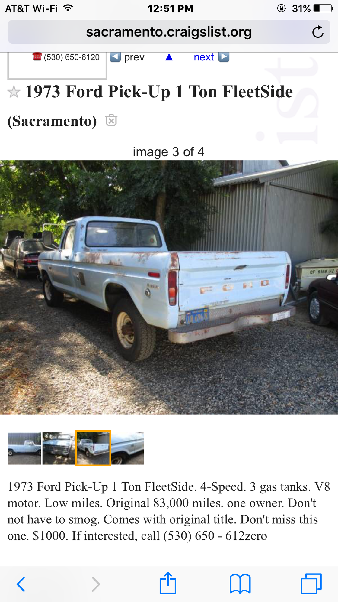

Good afternoon gentleman. I hoped I might get some good advise. Found this gentleman with a farm find. 1973 Ford F-350 four speed. Claims 82000 original I will have to check the validity of the speed o linkage. I'm going to check the vin #. He says it's a 390. Has a 2v motorcraft carb with tag still attached. Exhaust manifold leak but does move under own power. I would like to stay on the purest page. I thought a compression test and replace all fluids. Any things to look at on this one? Eric.

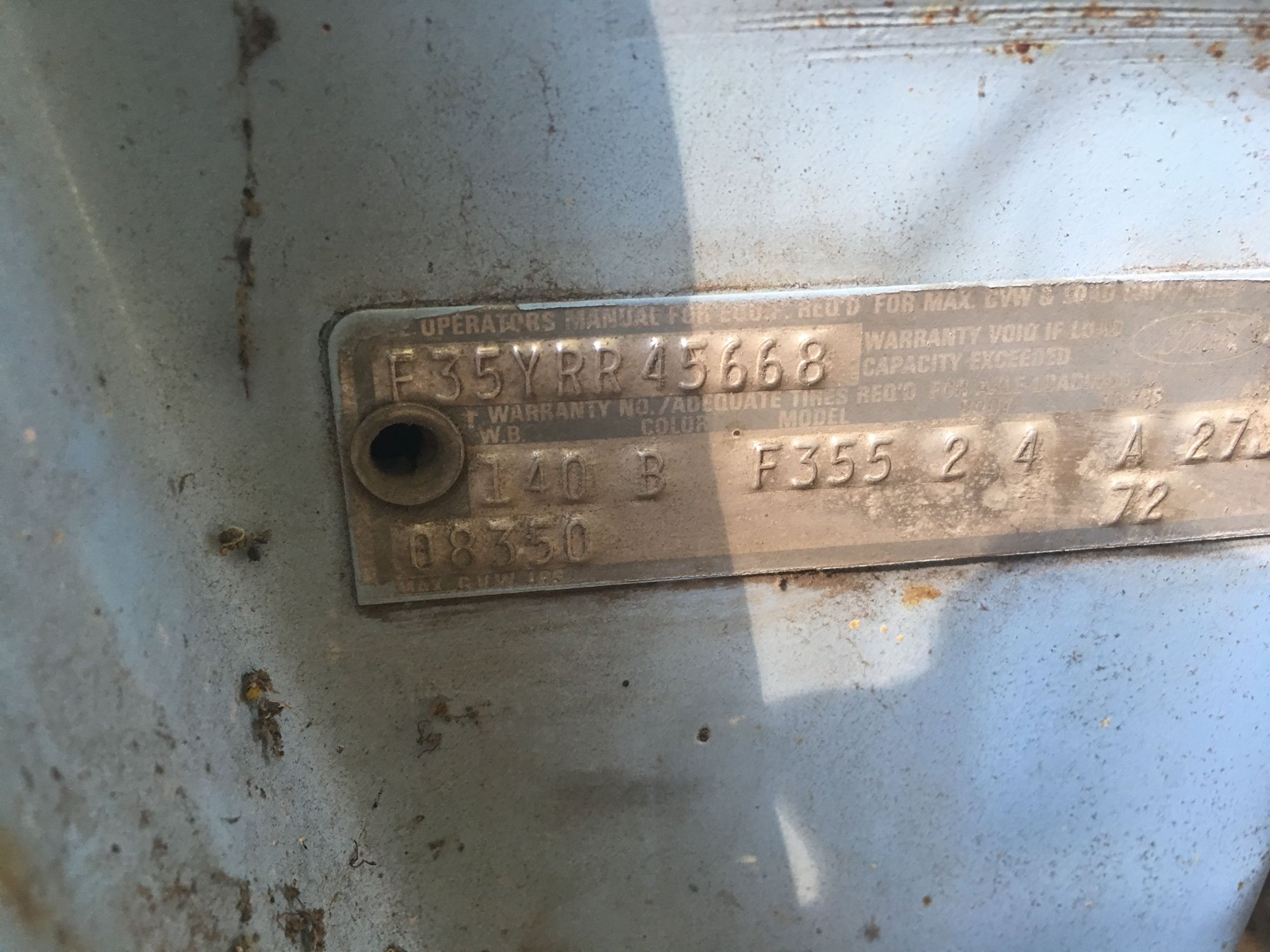

If it was originally a 390, the fourth character of the VIN will be "H". Don't be surprised though, if the character is "Y", that would mean it came with a 360, they both look identical.

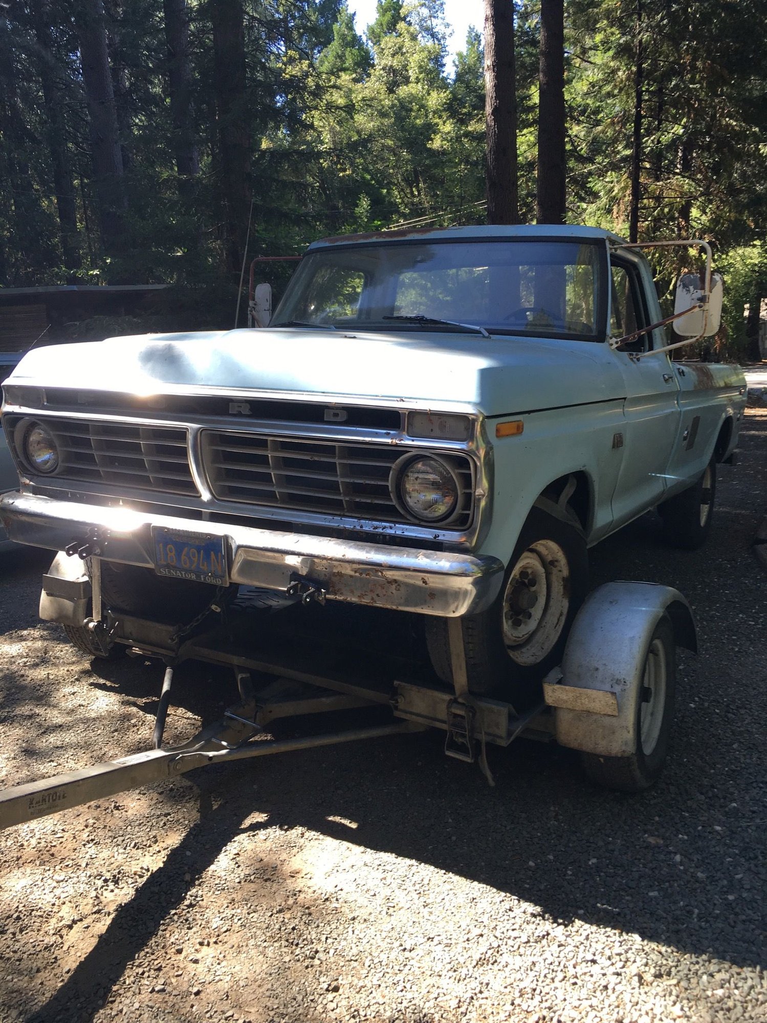

Also, what you're looking at is either a Super camper special or super trailer special. These have a 140" wheelbase. Check to see what kind of shape the fuel tank is in. They take a special fuel tank that is obsolete and no longer available. There are "work-arounds" for this but require fabrication, so that would take away from the originality.
Check frame, check the floor pans for rot. Pull the rubber floor mat up, floor pans go bad from the inside out. They can look great from underneath but have a lot of deep pitting from the top.
It looks like it has the factory dual fuel tanks and it looks like an aftermarket tank has also been added.

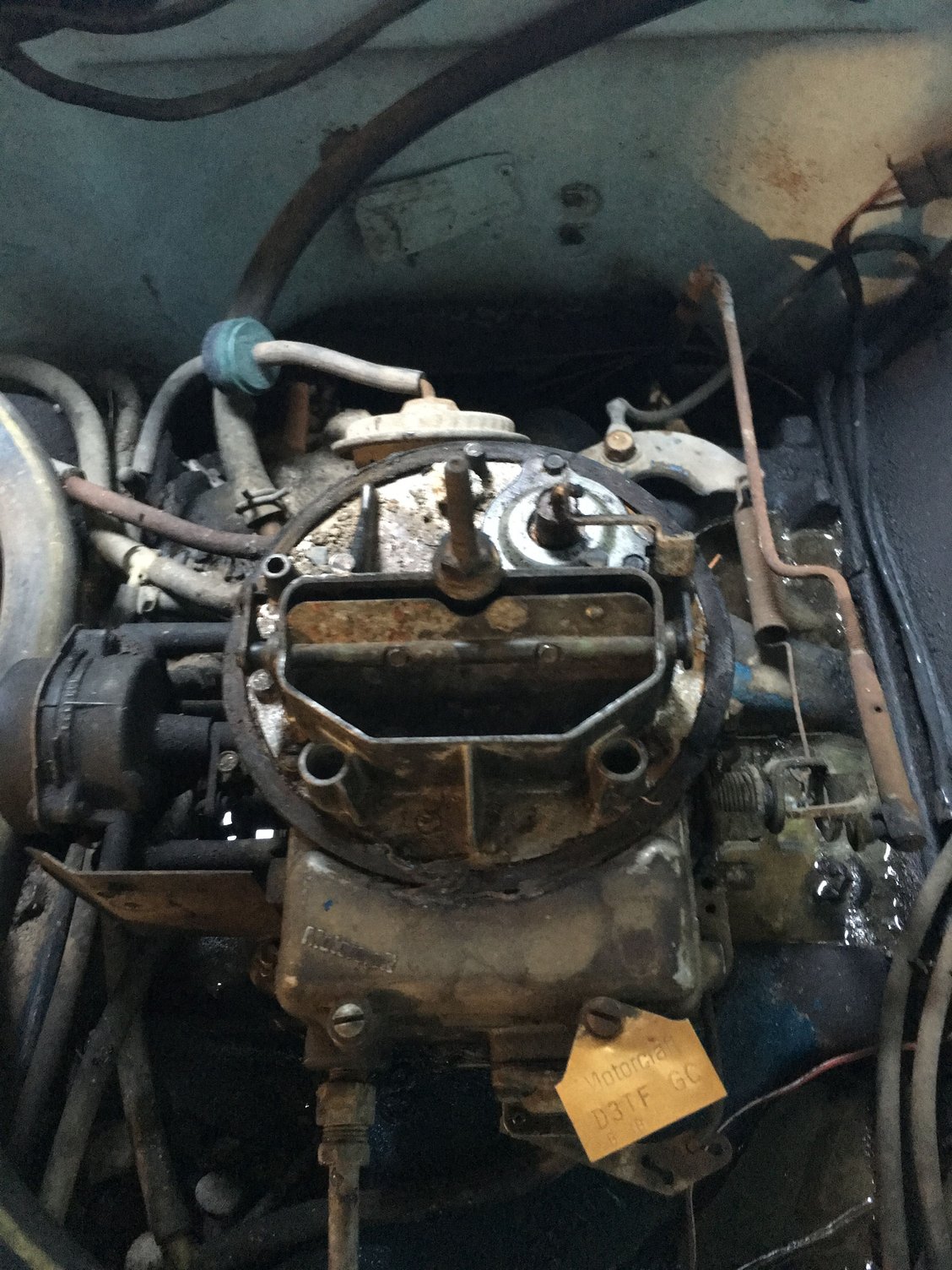

I looked up the carb tag, the D3TF-GC is listed for a 360.

Thanks Mike for the information! I believe that it does have a Y in the Vin number could be the 360. Additional battery cradle and the third tank appears to be manufactured in the fender well of the bed. Not sure about that the dual tank sits in the skid plate in the rear may be the reason why moisture gets in and rock to the tank? Prescient it very much Mike thanks Eric!

F35YRR45668
F35= F350 2WD Pickup
Y= 360 cu in 2 bbl V8
R= San Jose Assy. Plant
R45668=1973 model year sequential serial number
WB 140= 140" wheelbase
Color B=Light Blue
Model F355=F350 2WD pickup 8350 lb GVW
Body 24 = (2) Light blue and medium blue vinyl (4) styleside pickup box
Trans A= NP435 manual 4 spd
Axle 27J=(27) Dana 70 non-locking 4.10 ratio 7400 lb capacity (J) w/ power steering
GVW 08350= max gross vehicle weight 8350 lbs.
DSO 72=Ordered through the San Jose district sales office
Driver's side battery carrier (auxiliary battery) was a factory option. It could power a camper without running the main battery down and, once started, it would recharge through the trucks alternator.
Another Super camper special/trailer special feature was the spare tire was mounted behind a panel ahead of the rear wheel on the passenger side pickup bed. Regular truck mounted the spare below the fuel tank or (optional) in the bed of the truck.
