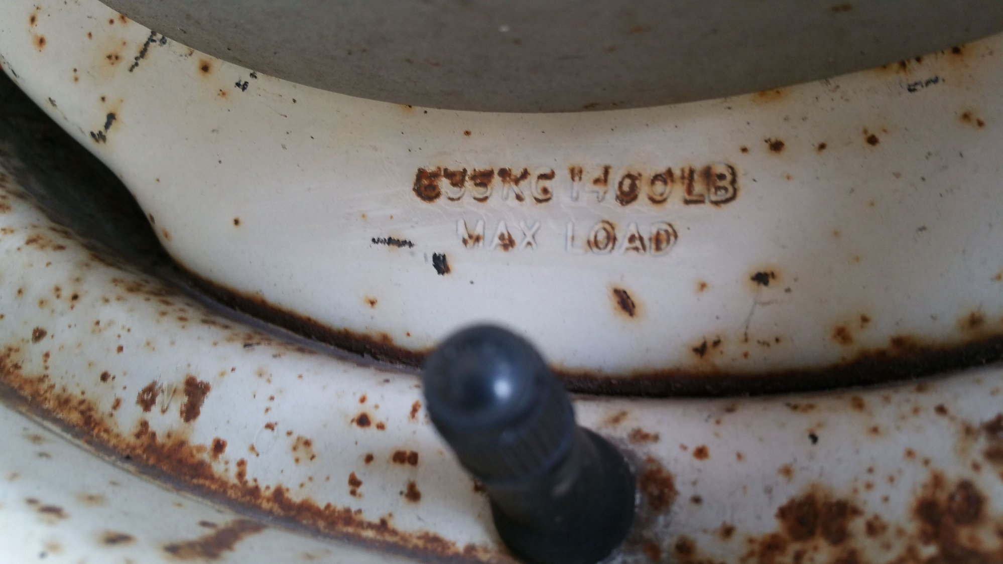

Snapped this of the stock wheels tonight. 1400lb x 2 =2800lb, so there you go.
I wonder if the limitation is purely in the rim. It's easy enough to find aftermarket wheels with a 1900lb load rating.

That explains it very well. Thanks.

I mean, from a practical standpoint, with all else being equal in the axle, would Ford would make an axleshaft/hub that was exactly 21% weaker? Especially given the measurements that were posted in the other thread.
Brakes of course are another consideration, but my trailer brakes are excellent. Basically, I'm looking for a little bit of extra overhead as with a 4500 lb trailer I'm really pushing the weight limit on the rear axle (and my GCVW is out the window). It's occasional use and I'm not trying to turn my light-duty 1/2 ton into a real 1/2 ton or anything.

I'm sure Ford didn't make it weaker. It had to have been the wheels that limited the weight carrying capacity of the truck, but the brakes weren't much better. So, changing out the wheels would certainly help.

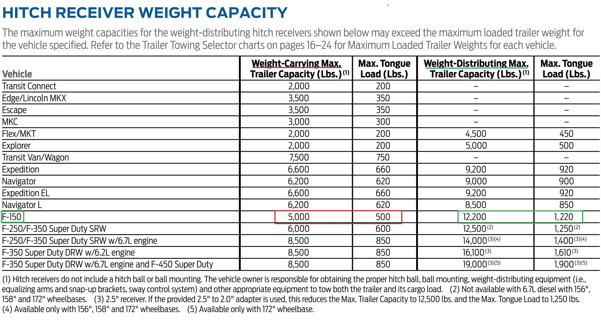

Oddly enough, a 5000# trailer with a 500# tongue weight is the max for a weight-bearing hitch on a new F150, so I can't imagine what it would be for a F100 in the early 80's.
You may be wondering how I know about the limits on a new F150. That came up recently when a fellow Sea Ray forum member mentioned that the owner's manual for his 2013 F150 states that you have to use a weight-distributing hitch after 5000/500#. So, I scoured the owner's manual for my 2015 F150 and it isn't in there. Not a word about when or even if a WD hitch is needed. However, there's a link in the manual to Ford's RV & Trailer Towing Guide. Sure enough, it has this table:
