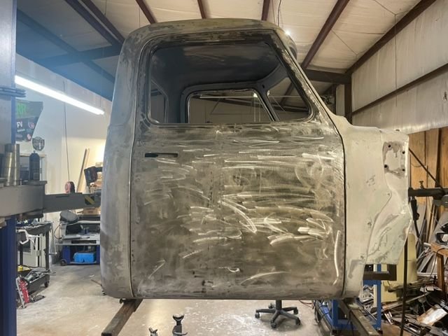

thanks I wanted a rotisserie it makes doing this stuff so much easier but they're big, costly and it can only do one thing plus having a lift make other task easier so I got a lift and built this thing. it was so handy to have and this one was always tide up with this truck i end up with 2 lifts as soon as this truck is done I'll sell one of them
you got me thinking i may move the paint booth over the 2nd lift and paint the cab on it so i can get every side at once :-)

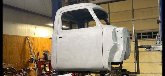

got the cab primed now with everything in the rough and primed now I can control the flash rust better lol so i started to get some of the inside work done. Made some seat mounts, mount the AC box did some metal work on the dash. cut holes for the vents switches
also made the fuse box on hinges also playing with the idea of a hide a way tray for the ECU and engine related controllers like cruise, remote start, AC, dash cluster and can bus. i didn't want to hide all this stuff under the dash where you cant get to it to trouble shoot or replace or ? and i will keep the radio and other related parts to a different location
still have a lot to do but starting to see the light

got the dash welded in with defrost vents still needs a bunch of finish work but its in i had to move and rework the wiper motor setup now I'm working on door gaps

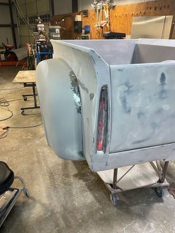

A little update I had a little time to work on the truck so I started by get the doors to fit better, welded up the door gaps and replace powered window regulator with a USA made one. a much better setup. I did little work on the bed got it sanded down had to work on the rear finders corners to get the gap to look better still needs more detail work one thing with it being primed it make it a lot easier to focus on one spot at a time and not worry about flash rust lol plus I can see the highs and lows a lot better I just need more time

THANKS for the reminder i did have to adjust my tail light pockets i did made them a little on the tight side. I'm about to do a complete assembly with wires and pluming in the next few weeks to check everything and see what I forgot or need to change before i start any finishing i still have a lot of unknowns ;-)
