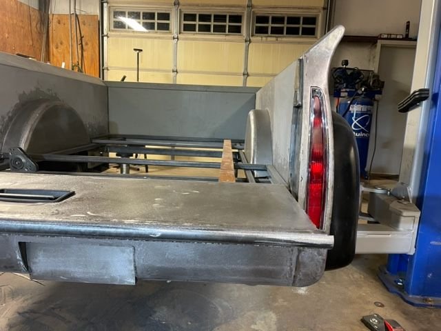

been working on it got the intercooler mounted. now i am working on the bed I didn't like the flat side walls on these trucks ;-) so i added an outer skin with some curves. plus by doing this i had room for the tail lights i had to modify the rear fenders to match the curved sides i still need to finish the finders bottom and make the running boards
what do you guys think ?

I like it but I am a darksider also. Like it when guys do something different with there trucks. Heck the only thing completely original on my truck is the front fenders.
Did you coat the metal you can't see with some sort of rust prevention before putting the outside layer on?

i have not put any rust prevention in yet. i did some some before on the cab it made really hard to have a clean weld when you have some coating between two sheet of metal but i did leave opening at the bottom so I can spray something like Eastwood Internal frame coating when I'm done
