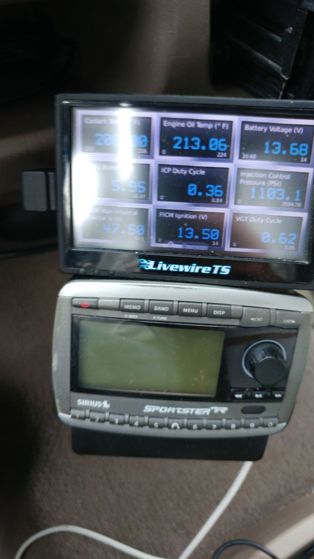

It ran great there and back. Towed like a champ through pouring rain there and ran great on the way home,one problem though,I can't live with 13 miles to the gallon. It maybe the rear calipers I haven't checked them and noticed some heat coming off the drivers rear. I also noticed heavy brake dust on that wheel too. I does need the FICM sent out,I know a tune up from Ed and a Atlas 40 tune will fix some of it. I'm willing to bet there is something I'm missing. The trailer was @ about 6,300 if I calculated it right. That's nothing for these trucks. I also forgot to take the SCT street tune off,so I ran with that on. Temps got up to 215 coolant on some grades with oil never more than 10 degrees higher. I was real happy about that,only thing I didn't like was the IPR readings once in awhile. They got a little high,just hope the HPOP isn't going out. It could be the tune but I don't think so. I'll put this snap shot up from the Livewire

looks like you've got her running nicely. I would think 13 mpg towing would be a pretty good number. What speed were you towing at?
I'm not sure what the norm is for the IPR Duty Cycle on the 6.0L's but it sure runs higher than my 7.3L's do.
